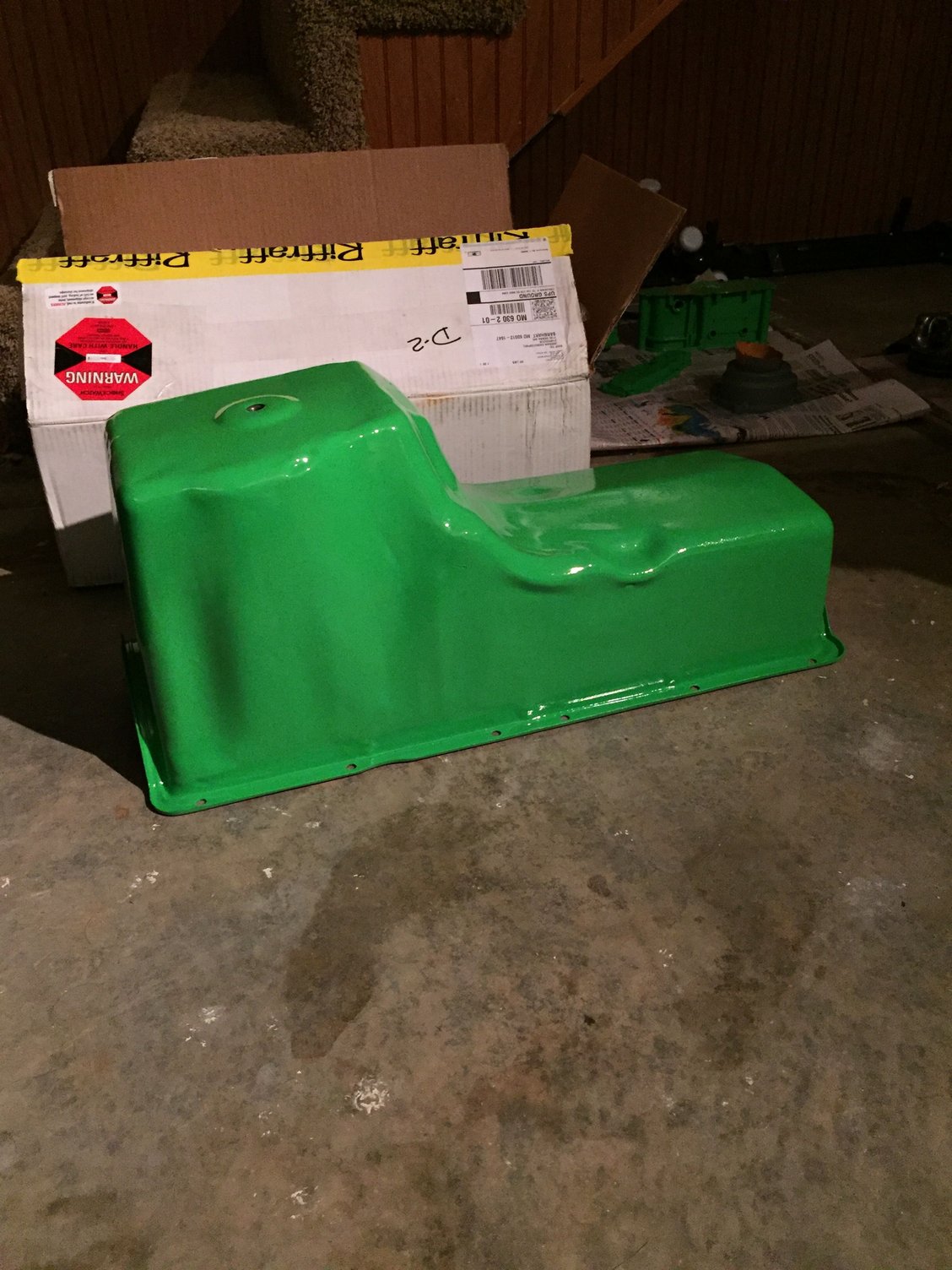

Oil pan all finished

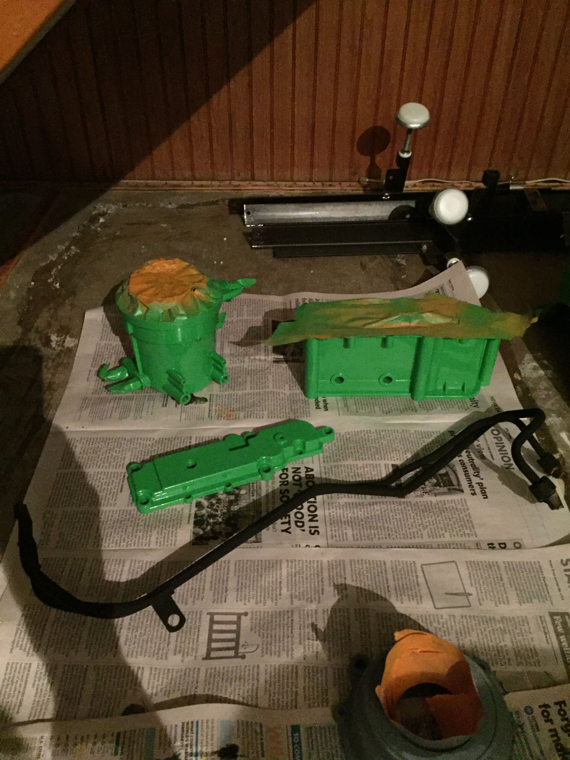

Im picking my block up tomorrow going to paint it black. I was supposed to be dropping the heads off tomorrow as well but I rounded the last exhaust manifold bolt head

Originally Posted by Zeropowerstroke99
[IMG] I was supposed to be dropping the heads off tomorrow as well but I rounded the last exhaust manifold bolt head
Don't sweat that! Cut the bolt as close to manifold as possible, then use vise grips or stud removal tool - it will come right out of the head.
The bolts seize in the manifold. They come out with help of our friends oxy-acetylene, the punch and hammer. Be sure to use high temp antiseize liberally in this area when you put it back together.
I did this for a friend last year. He came back with green paint and I was like are you sure??? But it turned out nice!!
Thanks! I cut it and got it right out. That looks sick! I dig the black with green.
