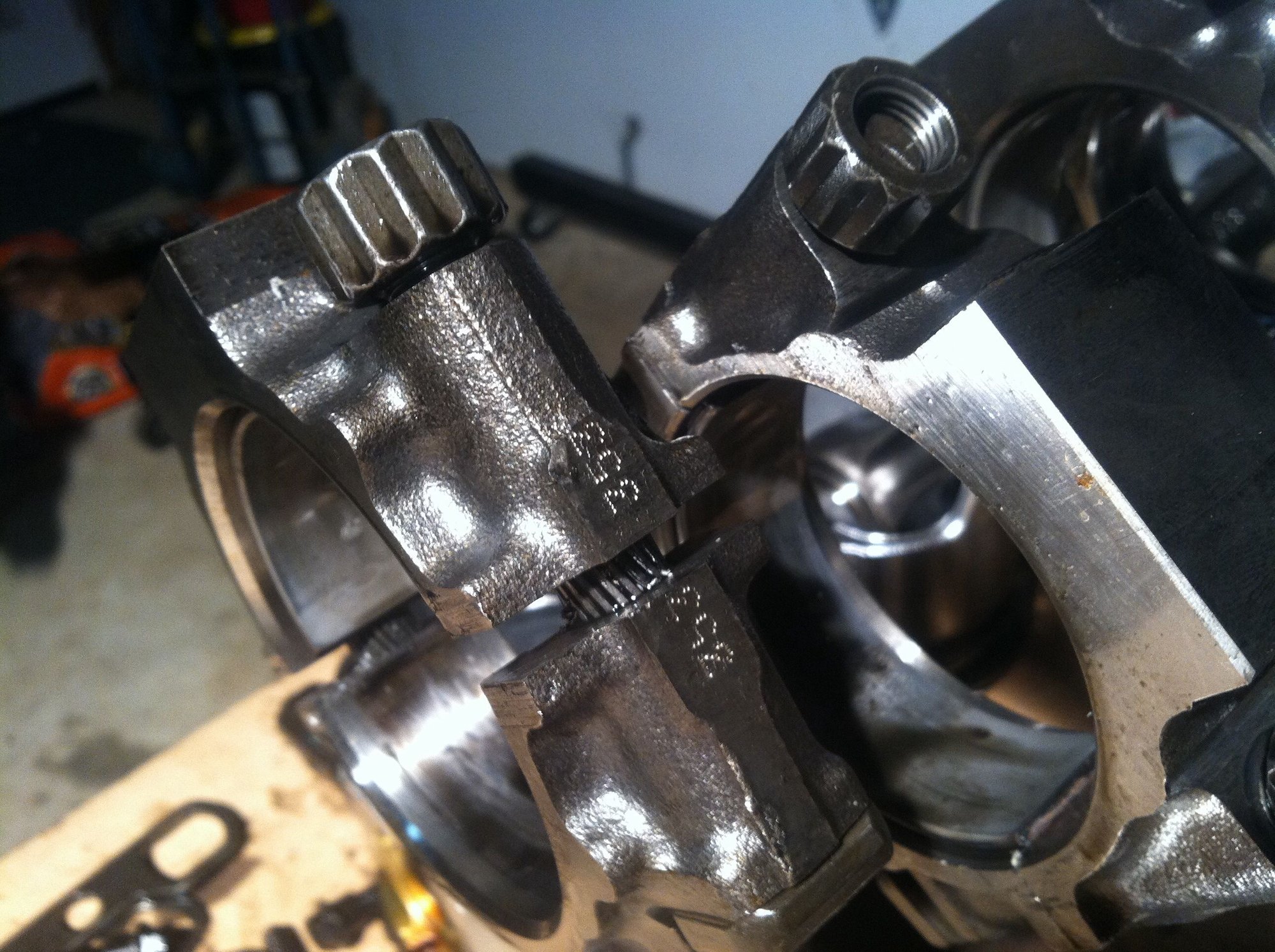

I need some help. I don't know which direction the rods go back in. I numbered them but didn't think to label which side goes forward.
Does it matter which way they face?

I'm no expert, but I'm pretty sure the rods are symmetrical other than the tab for bearing. I don't think it matters.
Great question! I hope we can get an authoritive answer.

I think I did it right. At least I hope I did! I rotated the assembly and there is no binding.
I put the chamfer side towards the counter weight which puts the numbers on the rod and cap facing away from the crank.
I'm just trying to make sure I don't F anything up.
That would be the correct way to a connecting rod with a large chamfer on one side. This chamfer matches up with the radius on the rod journal next to the throw (counter weight). Rods are usually numbered with them facing out to the pan rail on their corresponding side of the block. These are the general rules on any engines I've rebuilt.
Confirmed. I tore another engine down today. The numbers on rod and cap face away from the crank.

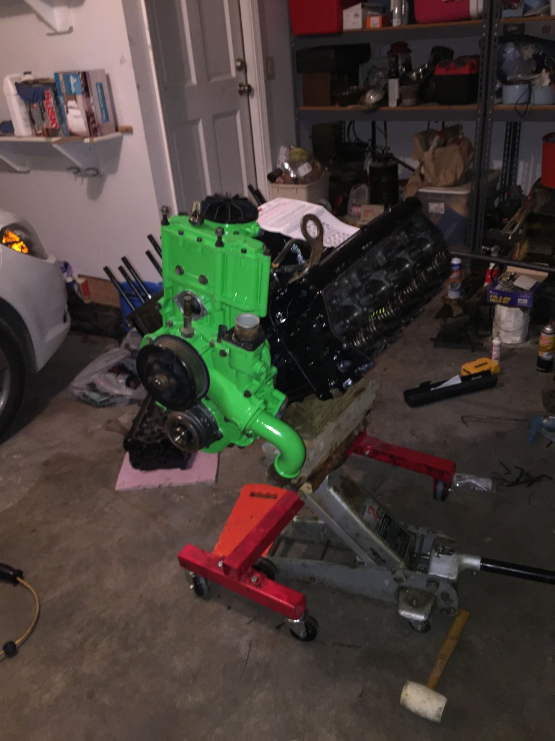

Arp head studs on
Both heads are on now. Going to do injectors rocker arms and push rods tonight. Don't mind the jack I don't trust this engine stand.
