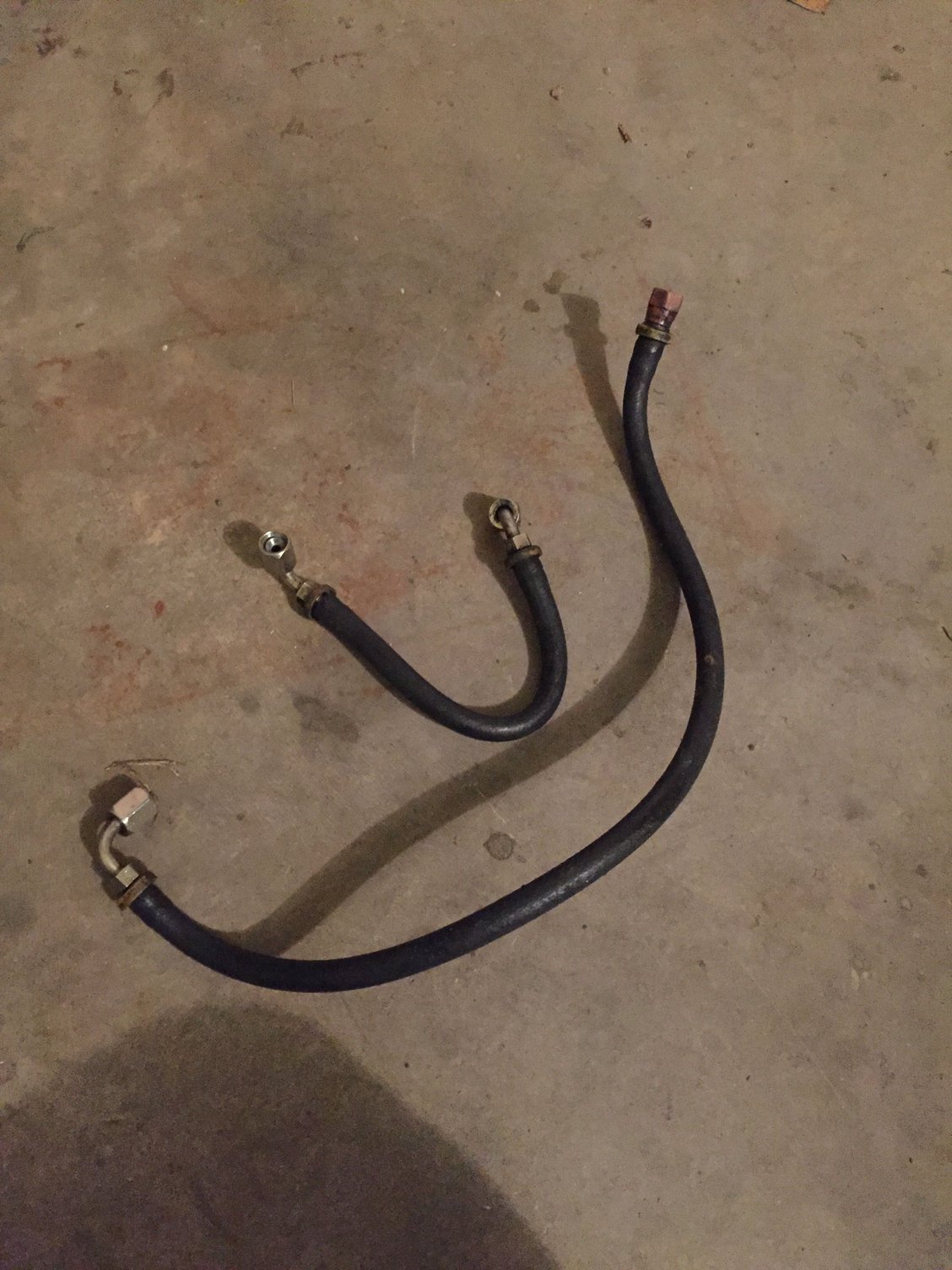

Here is a pick of my old lines the smaller one went to the passenger side front of head. The other went back around the fuel bowl to the driver side front of the head.
Both ports in the back were plugged...
I ordered stock steel ones from RR.
Thanks hotrod!

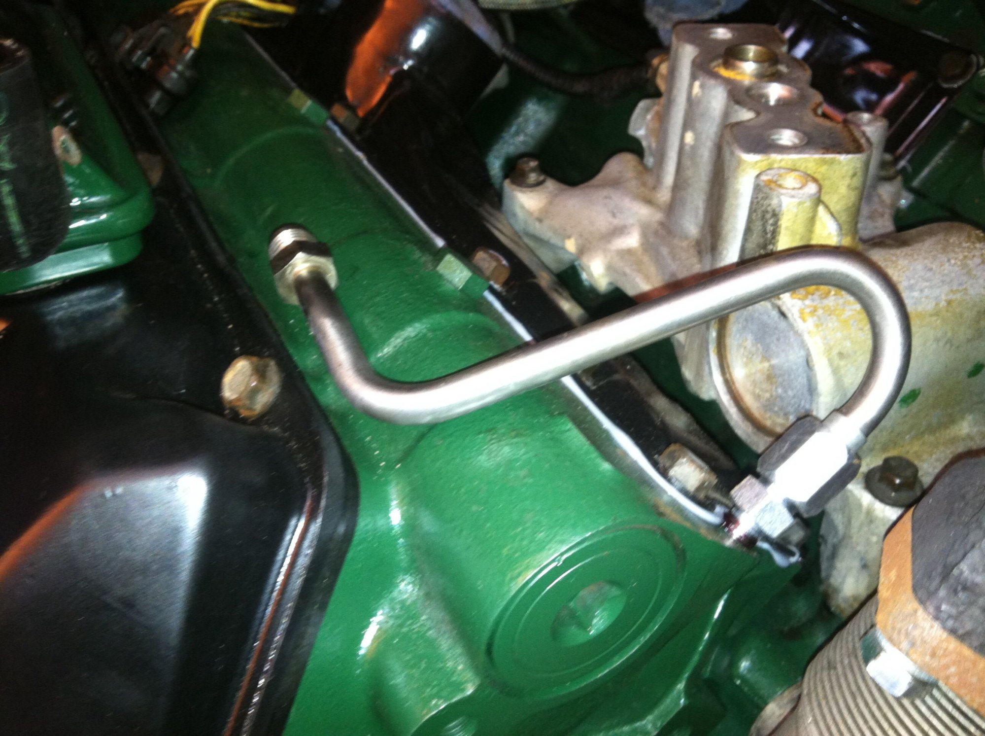

Rubber fuel lines on the engine are temporary and failure is eminent.
The FRx is designed for factory fuel system and requires the feed from stock filter to go to pass rear head and front of drivers-side head. The FRx lines go to pass-side front and drivers rear.

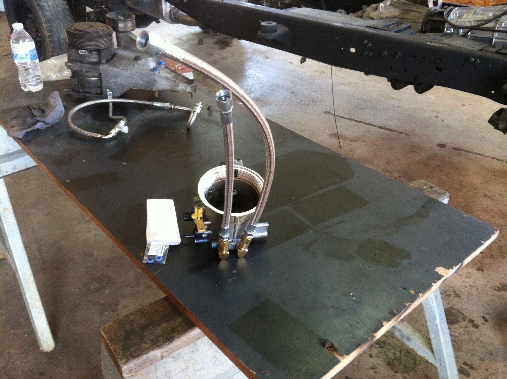

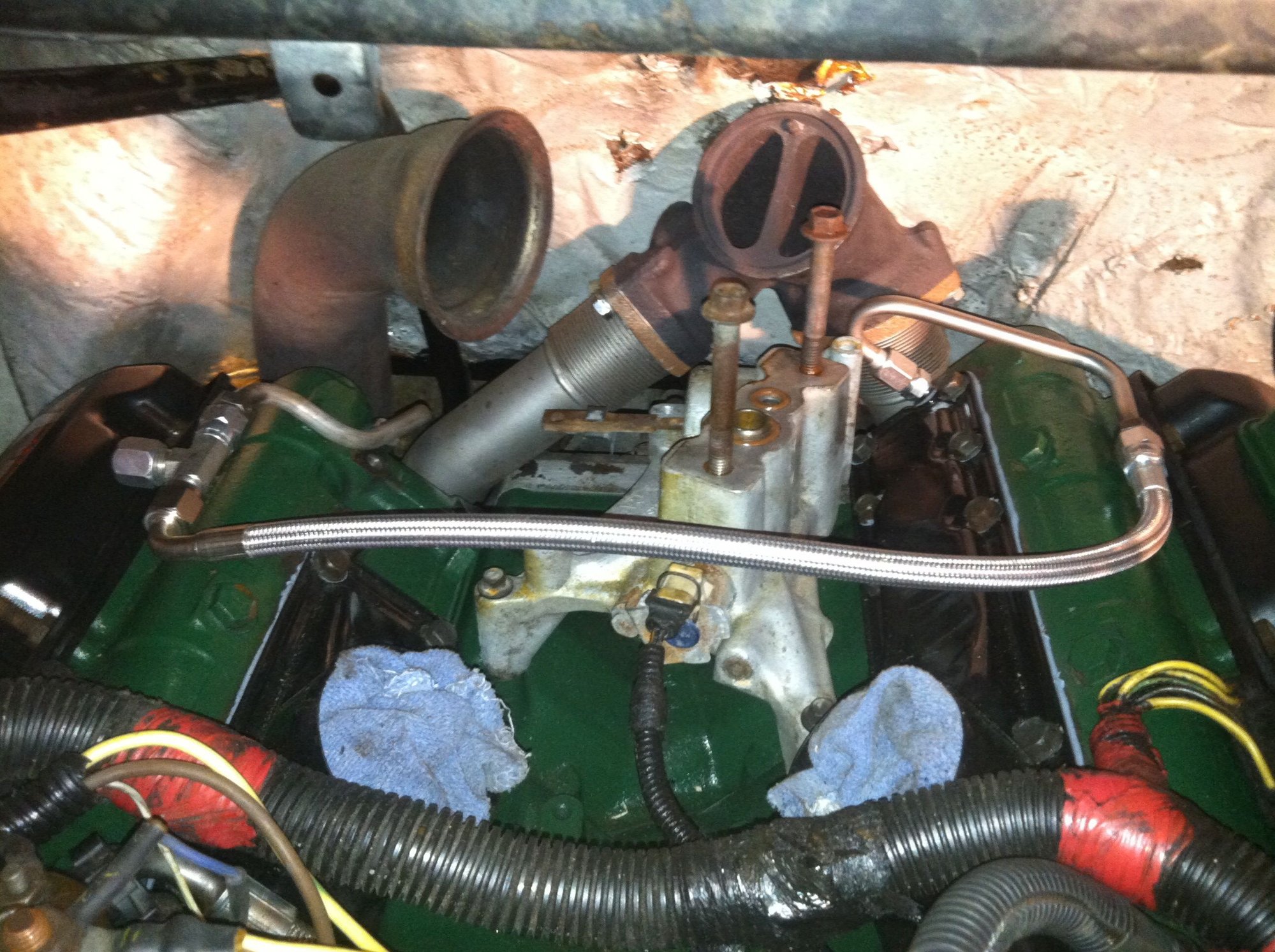

Get rid of the rubber hoses. If you don't have factory steel fuel lines - you don't need the CVD fittings either. Have ptfe lined SS braided hoses with JIC swivel ends made to go from filter to factory locations on heads. Then use JIC to 1/8" NPT adapters on heads and filter.
This is from one of my veggie conversions. I feed diesel to the front of the heads and WVO to the rear of the heads.
Here is how I do the rears:
I get these parts from Veggie Garage.
