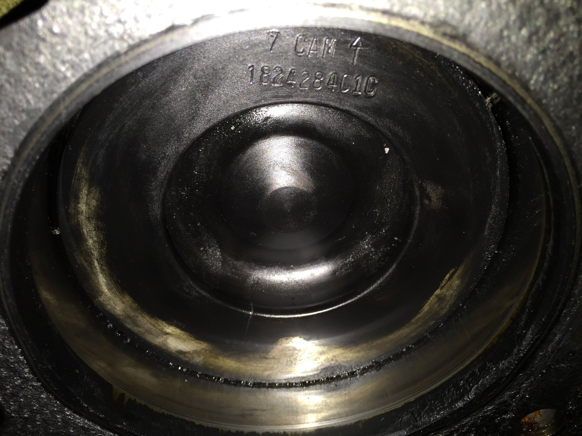

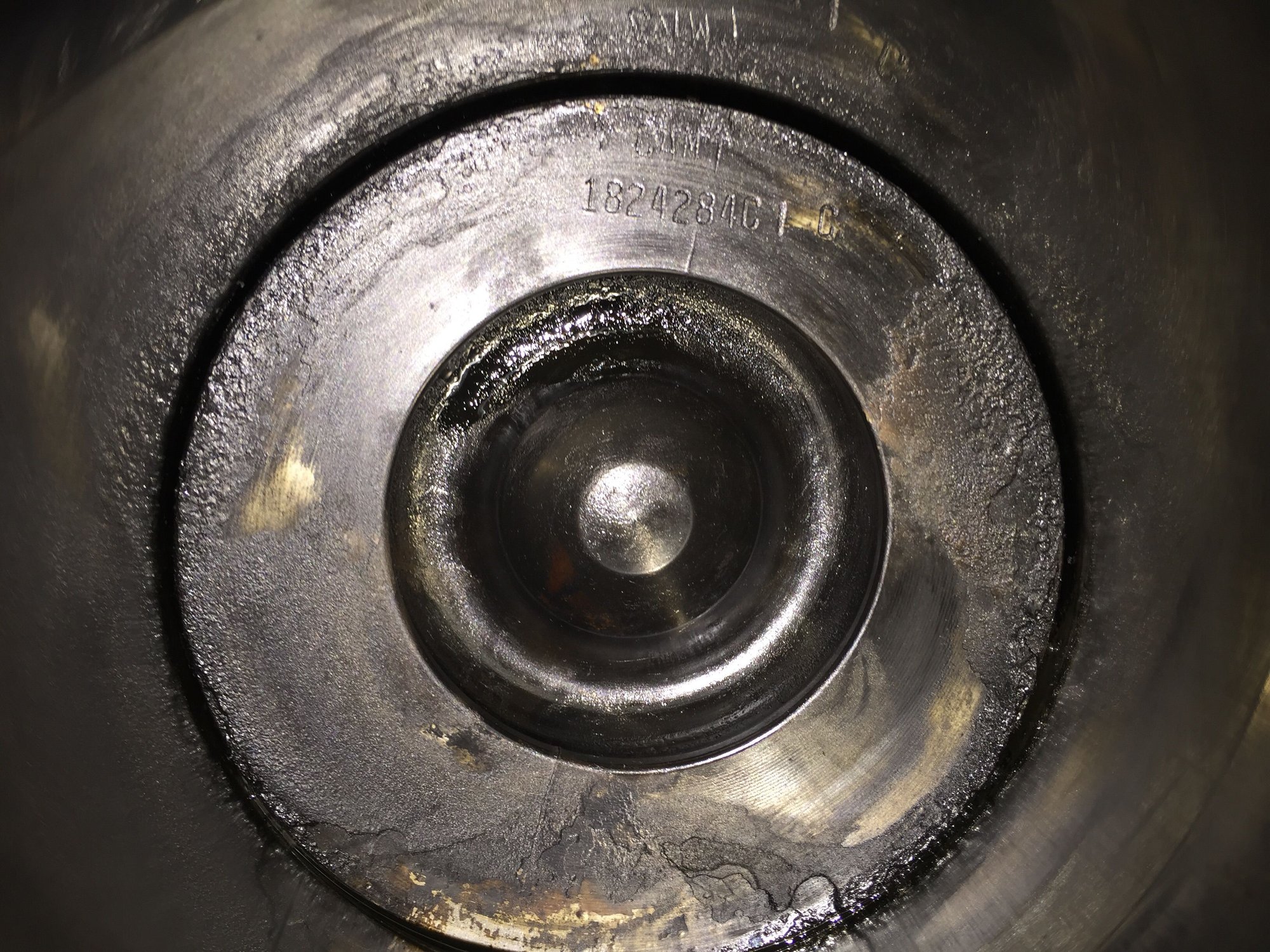

Just opposite of the piston ID looks like a cracked piston to me. and goes down into the cup/inverted dome. Just what my trained eye picked up. Use a pick or something see if it catches on it.

Something definitely doesn't look right. In the reflection off the cylinder wall, it looks like the upper ring land is dented/mangled like something was rattling around in the cylinder. Also, this may be an illusion, but it looks like maybe a crack in the block when I zoom in on the pic. I screen captured it and marked the photo on both sides of the spot I'm talking about.

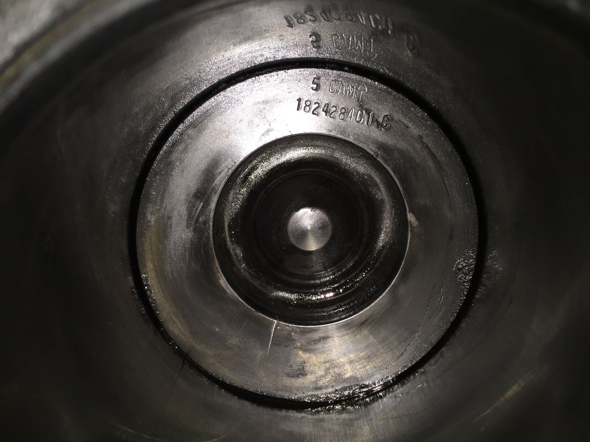

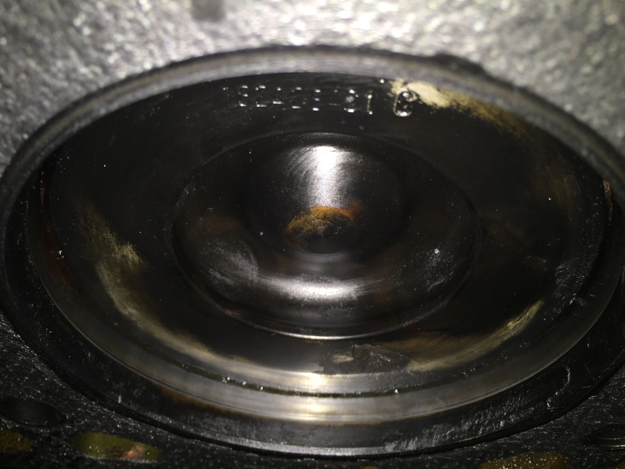

Sorry guys been busy. I got them cleaned up a little. I didn't see a crack in the block. Three Pistons are cracked though

What would cause them to crack? And why does 7 look so burnt up?

Ford rebuild kit is about $1100, figure $500-800 at machine shop depending on what heads need, then the rest is new parts 'cause you're that far already'.
Lots of coking on #7. I'd say that cylinder wasn't firing very good for some reason.
The lip area around the piston bowls is a common failure point. There are a few theories about why - like hard use before engine is warmed up...
Extended idling can cause coking, but we generally see it across all 8 cylinders.
