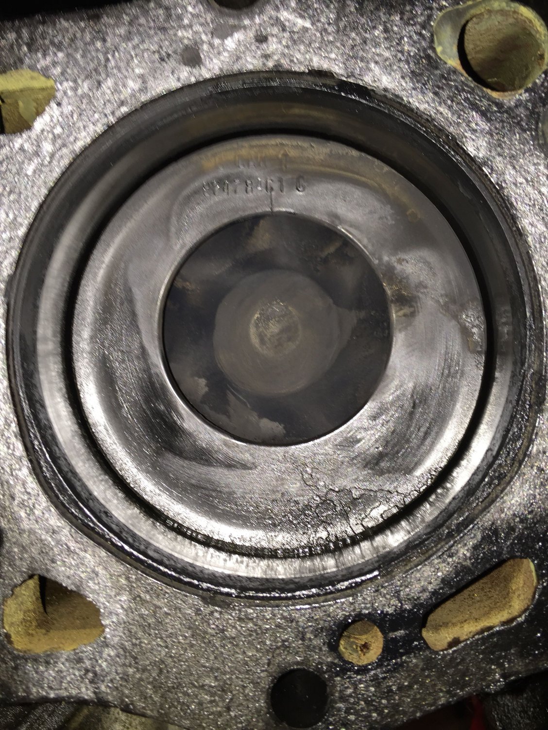

I finally got the motor out the other day! I have began the tear down. That thing is one heavy sob! 6 of the 8 pistons have cracks around the lip

Like to see the cracks better if possible?

I'll take some pics of them this evening

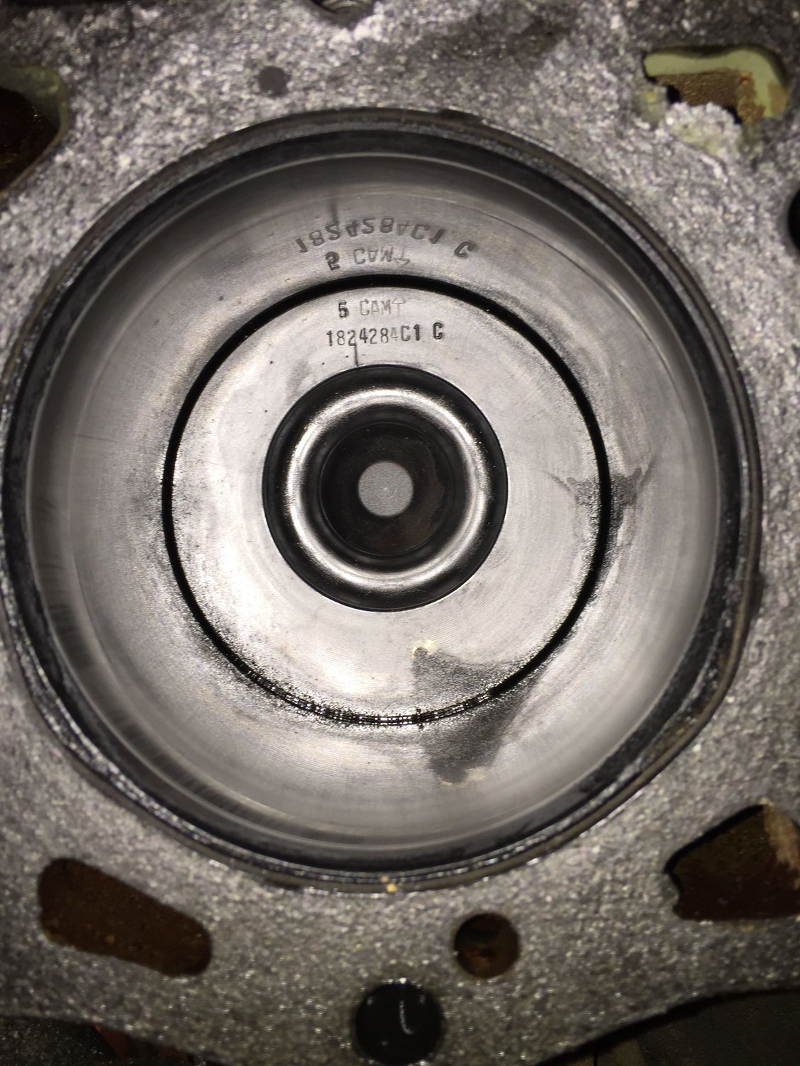

Here's the driver side

That is not uncommon for 7.3's.
We often mill that lip off new pistons to mitigate that problem.
Some have said hard use on a cold engine can lead to this.
I'm having them mill off the lip when I order them. Now I gotta get some one to see if it needs to be bored. The cylinder walls feel smooth to me but I've never done this so what do I know lol what prep did you do when painting? Scuff it up with a scotch pad or sand paper?

What Jason said but still not good. Any way if you could go 10 over I personally would do that. But if you have no ridge you could hone it and re-ring it. Just check the ring gaps before install. I come mostly from the gas engine of the pass for rebuilding, so on diesels I'm a little new when it comes to that, had to say that. If you plan to keep this for a long time I would go over as close to stock size as possible. That's me.

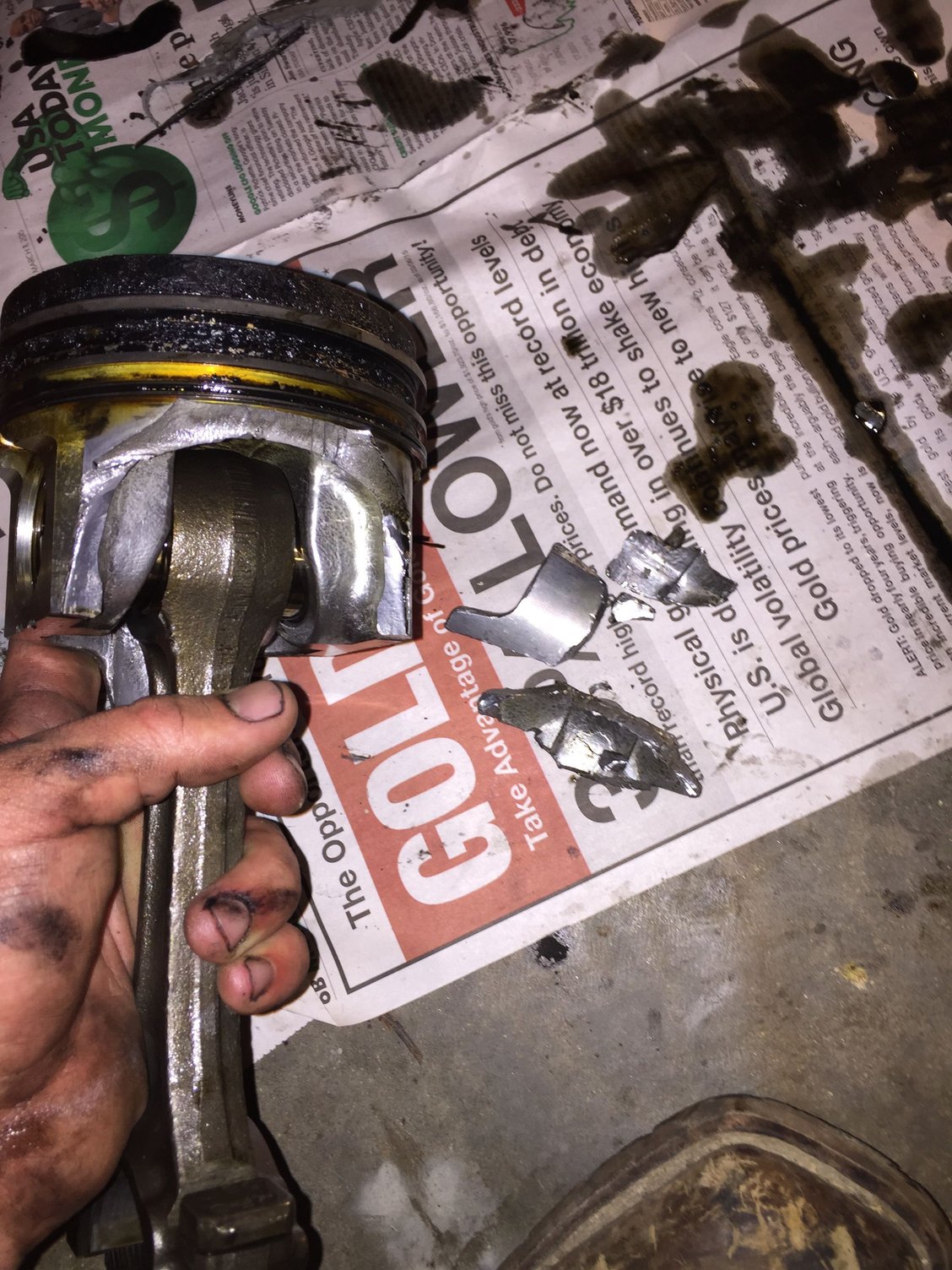

I found the knocking noise..

I'd tend to agree . . .

HOLY ***** that skirt is gone. Man I am surprised that was not making more noise. Well as far as bore goes 2 thoughts. You can hone by hand with a hone or glaze breaker. And like I said above use that finger nail. See what ya have to start with. It is all about how long you want this to last as well. I think you went this far and your buying pistons anyway why not spend 200 and bore it the pistons are the same price. But thats me. Although I saw nothing in the pics so far that I could see any ridge at all or scoring in the walls. It all looked really good. Honestly these 7.3 's are seriously gentle on the walls for wear compared to a Gasser. I have seen 50k FE engines with more wear than a 200K 7.3 in the holes. If that tells you something. Most of the time damage is from exactly what you had. Piston breaks a skirt and wears the wall. Then it has to be bored but i think you cought yours in time.
Just looking at your pics #4 looked like the worst but Hard to see from those shots. Look for vertical grooves on the one with the broken skirt. Looked like #8 had a vertical line in it. That would make a bore mandatory.

Hotrodfeguy- yeah I was in shock at how much of the piston is gone with hardly any damage. I am going to take it to a machine shop and get their opinion. I want this truck to last awhile because I have don't so much to it. What causes the skirt to break off like that? Running he **** outta it?

A blown skirt like that on a 7.3 with stock pistons I would guess was a chip/power mods. Lots of heat up top. gives for a thermal imbalance between a hotter than hell crown and a cold skirt thats getting a oil bath. Normally you see a ring or cracking down the side, maybe even a piston pin area. I have never seen a fail like that. New one by me bro. I have seen small fails on the skirt but nothing as major as that. That was a epic fail!
Like I said your buying pistons anyways may as well bore it. Pistons are going to cost the same.
