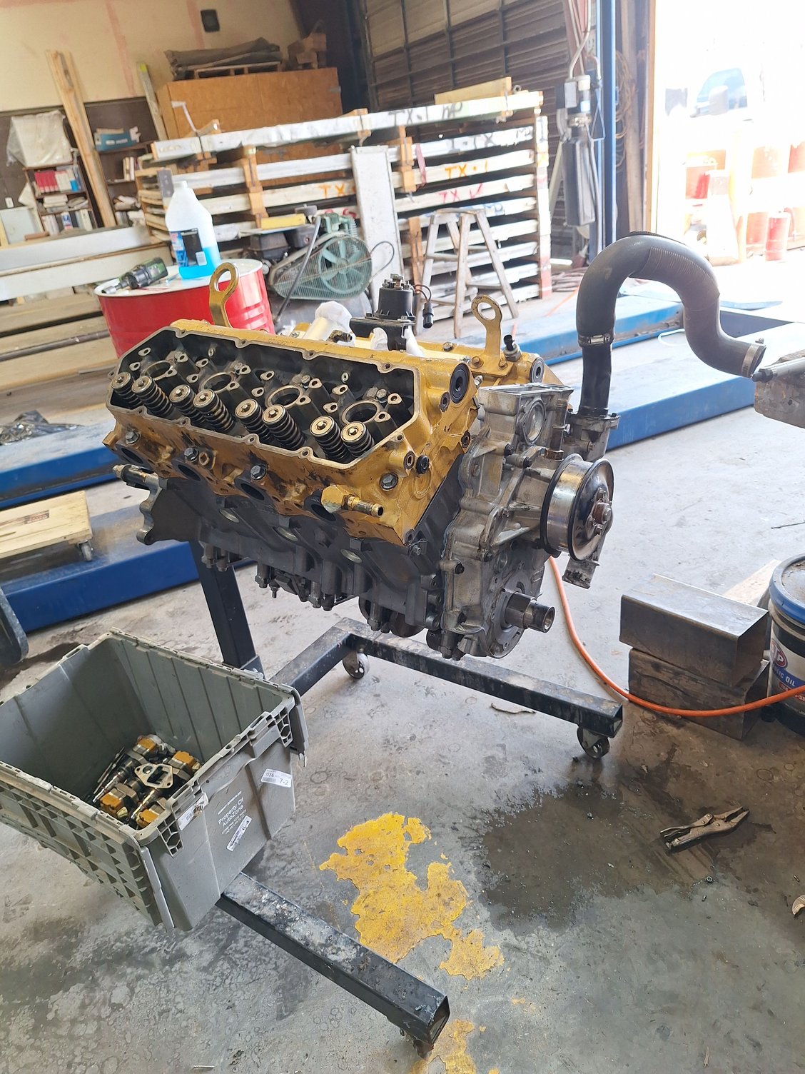

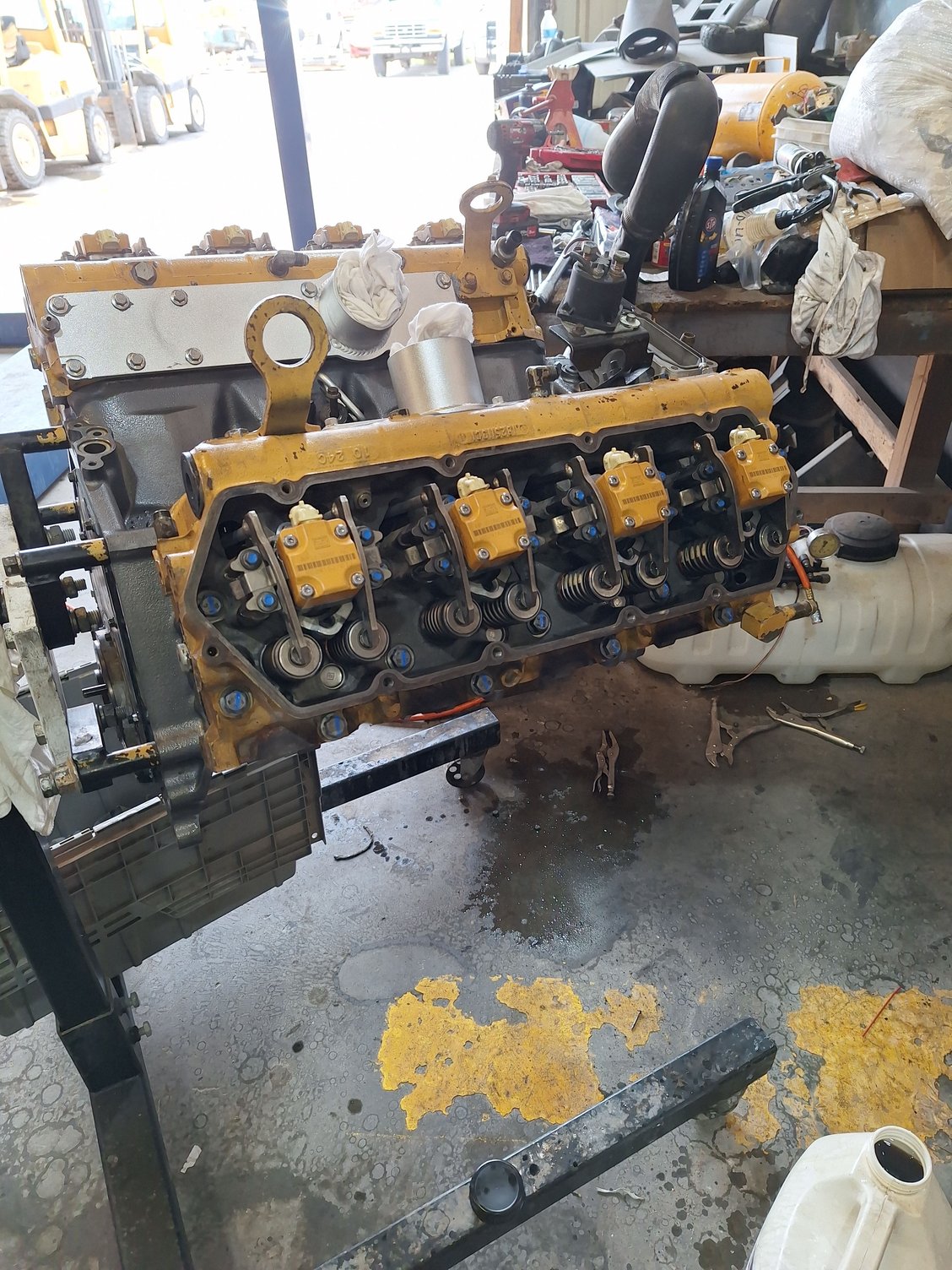

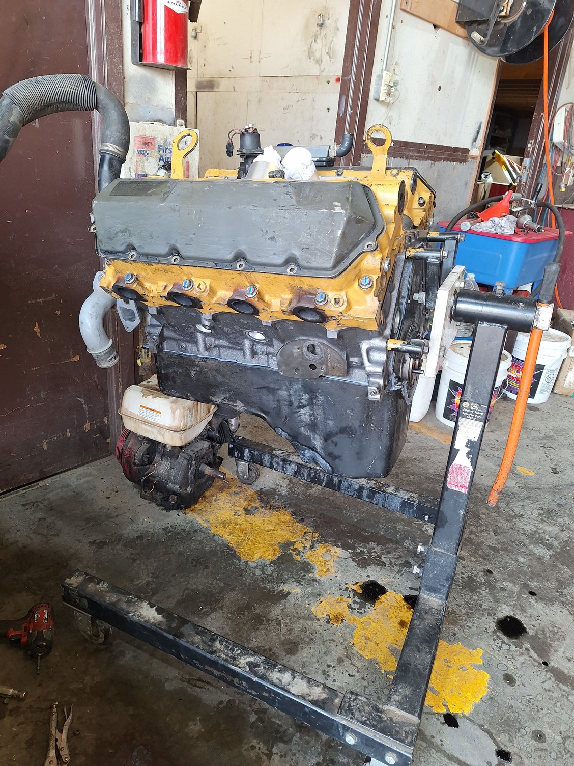

Some work done to the engine

That is some good progress in the right direction

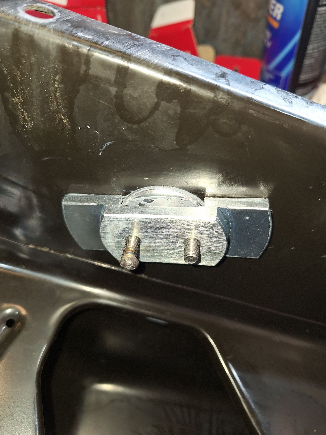

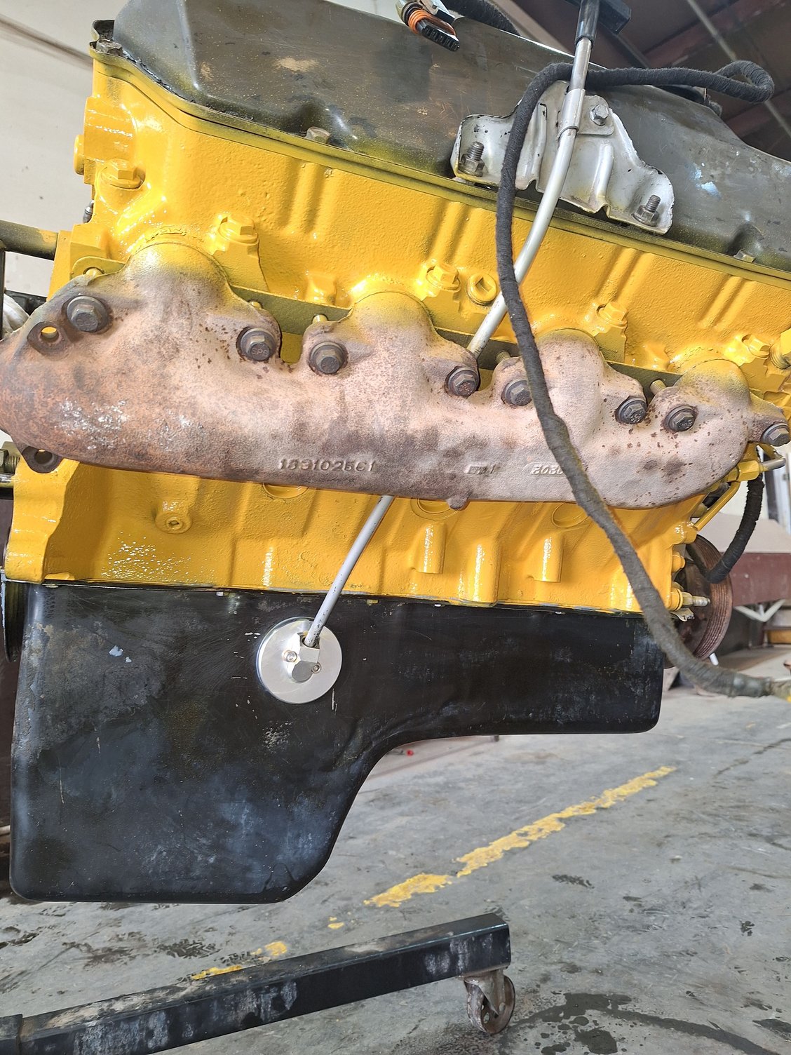

Have you tested that dipstick adapter? In your picture it looks like the backing plate will not allow the dipstick to enter the pan. You can see how I cut a slot in the one I made here... https://www.ford-trucks.com/forums/1...l#post17022037
Good catch, I'll check it out thanks.

Dip stick did go in, so no dropping the pan.

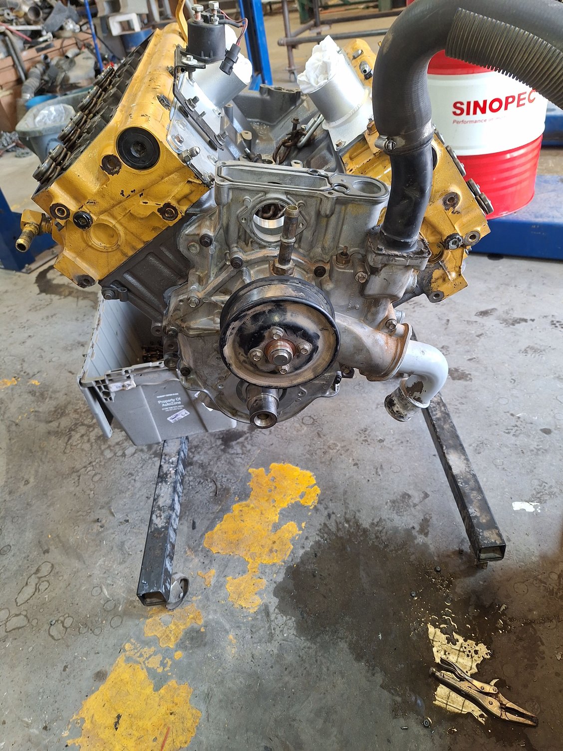

Hopefully i start installing the engine tomorrow or over the weekend, still need to repaint the block Amarillo to match the heads.

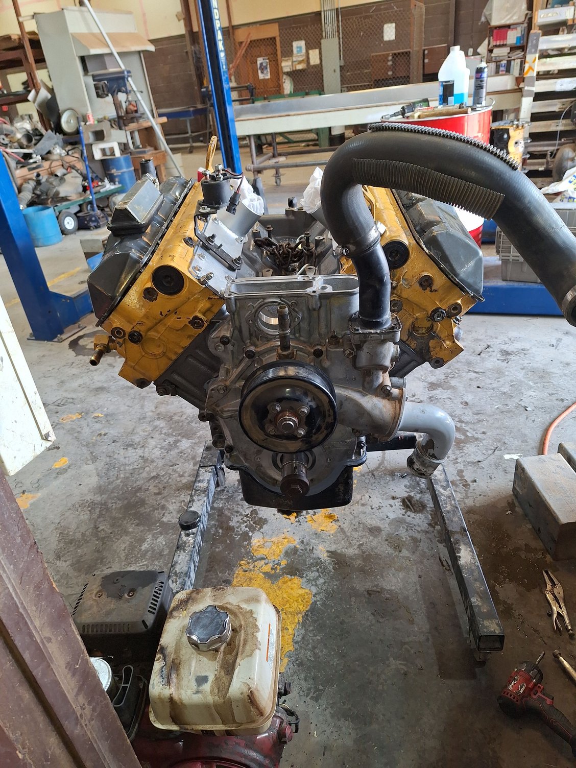

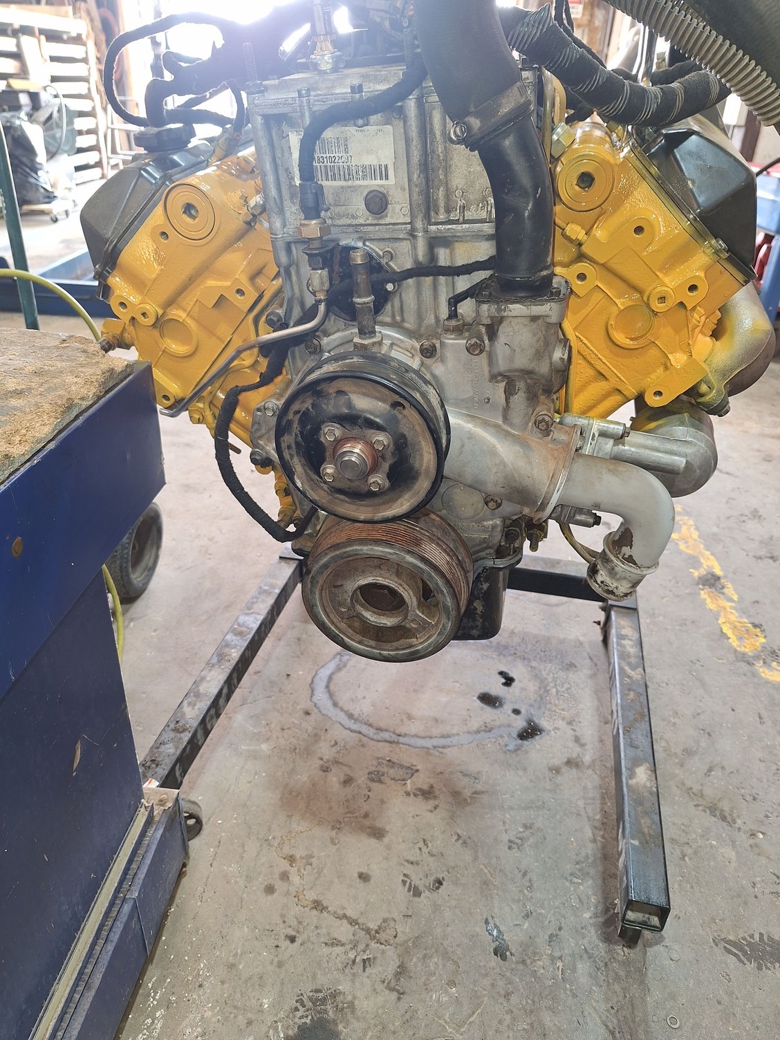

And finally a $ 12 rattle can paint job, didn't mask some of the stuff but ehhh nothing brake cleaner and a rag can't fix

Engine is in, primed the oil pump, filled oil gallery's and hpop reservoir, 3-4 seconds of cranking and started right up, stopped it immediately as I have no radiator on it yet, but for the few seconds it ran it sounded really good.
Tomorrow I'll install the radiator, fan clutch, add coolant and start the break in.
