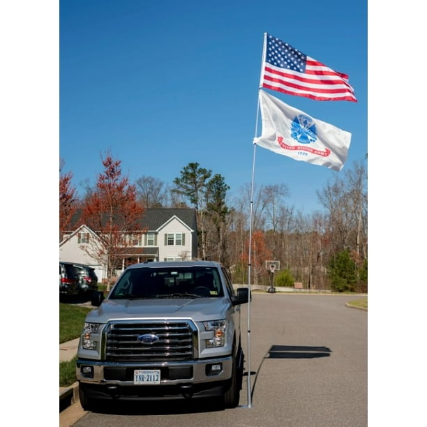

A easy setup is the plate that goes under the tire for a telescopic flag pole. It gives you a really universal seup that can go on either side or under the tongue jack at the front. Even under the TV tires if needed.
https://www.walmart.com/ip/Flagpole-...18e162f6bbee69

looks cool untill a freak wind comes from the opposite direction and give a nice mark/ dent or something on the vehicle or trailer. I've experienced gusts come out of nowhere then nothing again.
That's my concern also. The antenna shouldn't catch as much wind as a flag, but I don't want the pole rattling against the side of my trailer.

If it had an upper support (sleeve) to eliminate or at least allow the least amount of movement it shouldn't be an issue till it snapped at the area. An antenna I would think even with the directional thing on top wouldn't be that bad but a flag whipping in the wind certainly would transfer movement more than I would like whipping around. Just something to think about or atleast try to prevent if possible.
