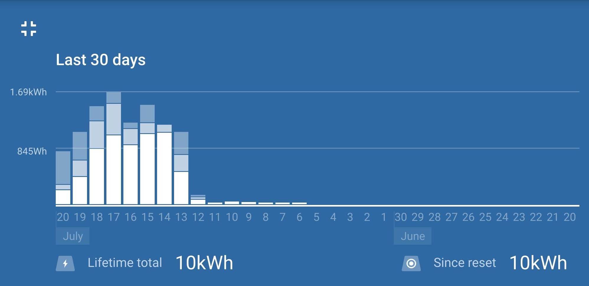

Solar mods
We have been wanting to boondock in Colorado but haven't had the setup to pull it off so some 12v system fortification was in order.
4x 100w of HQST solar panels
Victron Smart Solar 100/30 MPPT solar charge controller
1500w GO WISE pure sine wave inverter connected to shore power 30 amp inlet on a 15 amp outlet of the inverter. This allows the ATS to continue to source power from generator to inverter. (no cables for the wife/kids to connect/disconnect)
2x GC2 6V Duracell batteries
8 ga cable from charge controller to roof
10 ga cables from panel MC4 to MC4 branch connectors
6 ga cable from charge controller to buss bar
2/0 cables from battery to buss bar fused with a 300amp Blue Sea/Eaton CBBF terminal fuse
Bayite 100A battery monitor (to be replaced with 300+ amp monitor yet to be named)

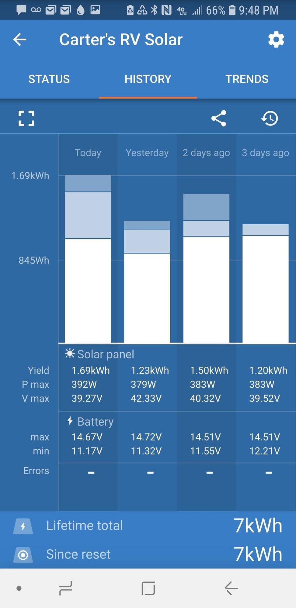

Solar performance was outstanding in Silverton Colorado last week. We had not a care in the world in regards to power. Used the generator for coffee a couple mornings and vacuum cleaner as needed with all other AC loads on the inverter.
This will allow allot of camping spot options were scared to use before.

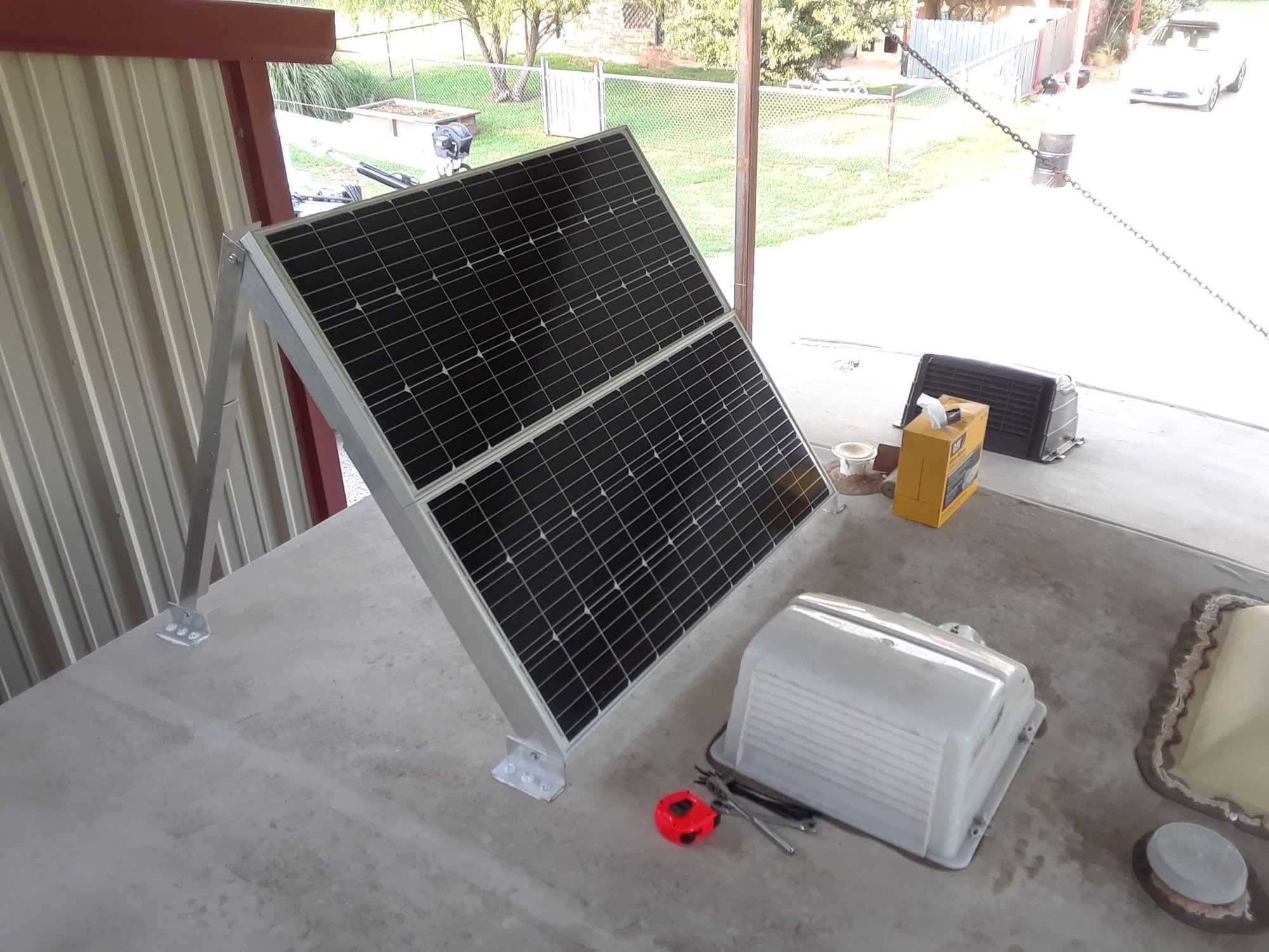

Solar panels installed to allow up to 90 tilt to either side of the trailer but not front to rear.
GC2 batteries installed on the tongue. I hope to build a lithium pack in the next couple of years of either prismatic format (aka CALB, Winston etc.) or 18650 style. Lithium is cost prohibitive at the moment.
Victron Smart Solar MPPT 100/30 with Smart Battery Sense,
GoPower 1500w puree sine inverter.
4 100w HQST Compact Mono Solar panels bolted two to a rack to allow for double tilting. Angle brackets bolted with 3 -5/16" lag bolts per bracket.
Average daily production for that trip.
The orange cord is a extension cord with a 30 amp twist lock installed to power the entire rv from the inverter.
Solar usage/output for the trip.
