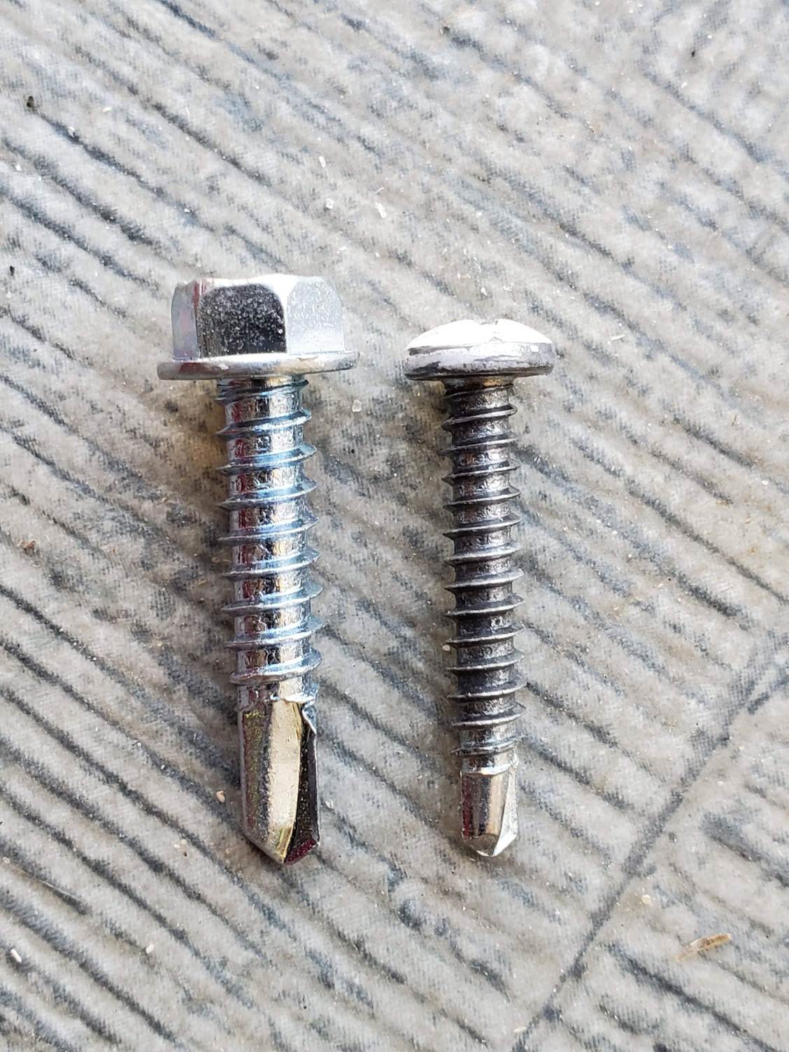

For the past three years (since I bought it used), the frame of my cargo door ramp has been moving. Consequently, I couldn't keep caulk on the vertical seam where the metal door frame met the wall. I finally figured out what was going on. Most of the itsy bitsy screws that held the frame on were missing! The picture below is of the top of the frame on the curb side of the trailer. To the right is the cargo door frame and to the left if the vertical rail of the HappiJac bunk bed. The top hole is so jacked up that I couldn't put a new, bigger, screw in it. Note the dust on the wall, just to the left of the door frame. This is after I pulled the door frame back against the wall.
To fix this situation I had to first pull the cargo door back against the trailer wall. I mounted a 2x4 at the top of the door frame and then connected two ratchet straps to the 2x4. The ratchet straps were attached to the cargo tie-downs on the floor as far forward as possible. There was so much tension on the straps that they twanged when plucked. Both sides were drawn in, but the curb side came in the most at 1/2".
The vertical 2x4 boards were necessary because the ratchet straps wanted to pull the horizontal board down.
New screw on the left, old screw on the right. I didn't count, but I think there were 10 screws missing before I started. I used the old holes when I could but added a few more, just to be sure.
There are screw holes along the upper frame. Those holes have never had screws in them. They would be going into a fake wood shelf that is above the door. I don't know how much good that would do. It seems like it would just tear up the shelf. This is a lousy design on the part of Fleetwood.
