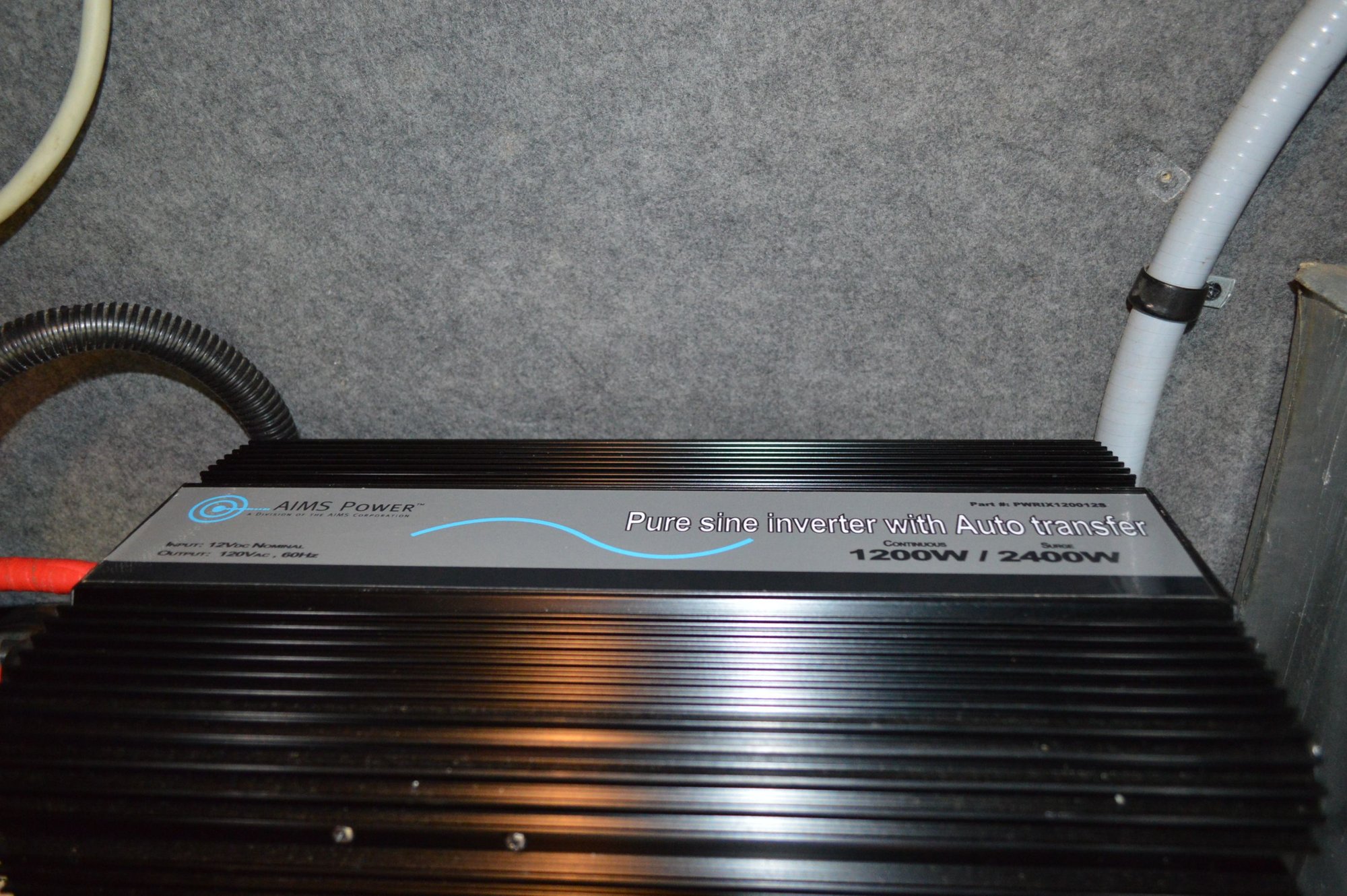

Just finished installing a Pure Sine Wave Inverter/Switch to power the 13 cu ft electric fridge. If AC is available, the fridge runs off of that. If not, the inverter draws on the battery bank and produces 115 VAC. No action required on my part......

The inverter is mounted in a forward compartment........
The starting Battery is now installed in the battery compartment... I built a heavy shelf for it.....
The inverter is connected to DC Input via 2GA fine multi stranded cable. (Welding cable). Connected to AC input ......and AC output. (To the electric fridge.
