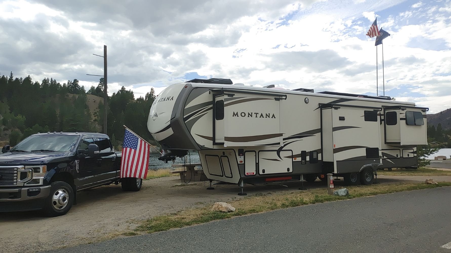

My 2016 Keystone Montana 3790RD. Have had it since new. Have done endless repairs and Major upgrades.
Removed the factory suspension: 7K axles and electric drum brakes
Replaced with: 8K axles & suspension and Hyd disc brakes.
Rebuilt with a better design every joint between the wall studs (Sq alum) and the sq alum sill. Half the welds were broken or done so poorly they weren't holding.

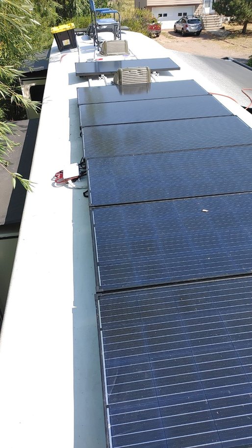

Designed and installed a robust solar system: 1600 watts of solar Panels, 600 Ah of Lithium batteries, 3000 watt pure sine wave inverter, 1100 watt pure sine wave pass through inverter, 100 amp solar controller and all the little stuff.
Built-in water filters: One for incoming water. A second for water as it is pulled from the fresh water tank

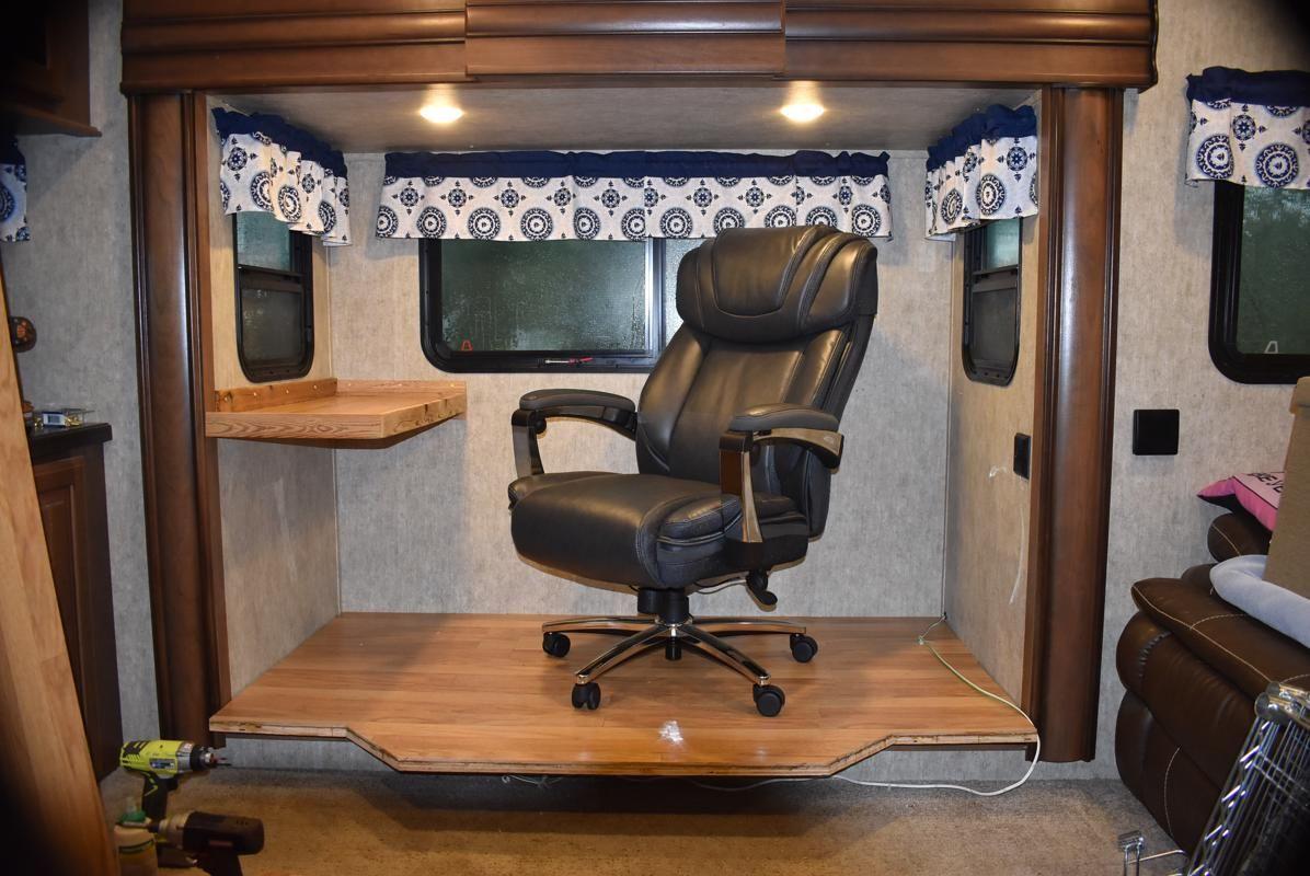

Built a computer "room" in one of the couch slide outs in the Den / Living room.
Our current camp site in a BLM CG. Riverside CG in Canyon Ferry MT. Just down stream of Canyon Ferry Dam on the banks of the Missouri River.

Working early spring 2018 in Great Falls Montana. Even had snow on the ground for part of the install.
Six 100 Ah lithium batteries (Renogy)
Six 200 watt panels at the rear of the 5th wheel. plus two more further forward.
Just forward of the six in a row.
One right on front of the roof.
Beefed up the sub floor and put laminate floor on that. Also created more depth to the floor.
Free standing desk. Quite strong. The chair was swapped out for a little smaller one.
Shelves for storage and a printer are now to the right of the chair, on the wall.

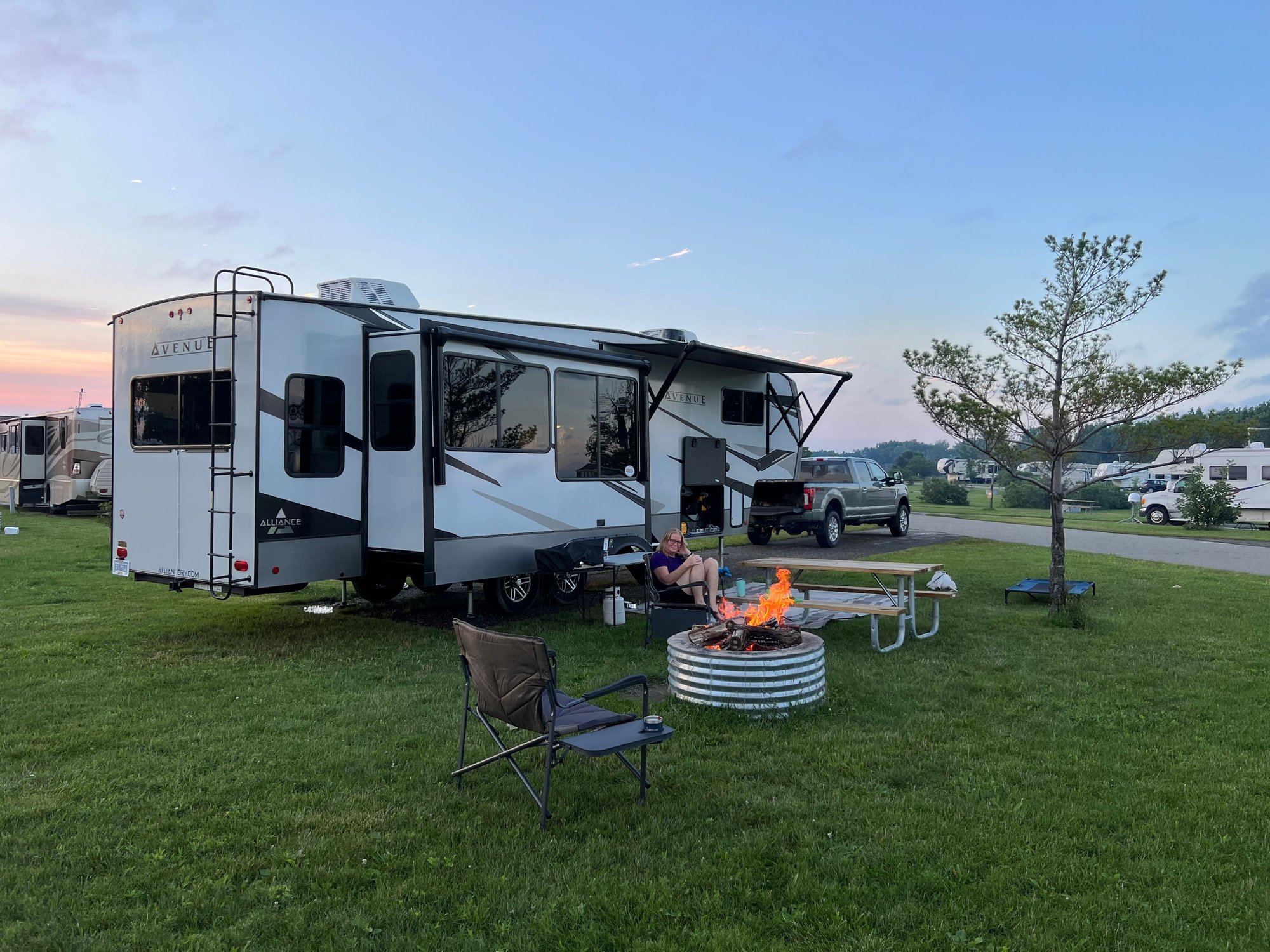

We jumped back into a 5th wheel last fall with this 2022 Alliance Avenue 32RLS. tow’s great and have lots of projects planned for it. Just last weekend we ran the TPMS and backup camera. I still need to install the sensors in the tires

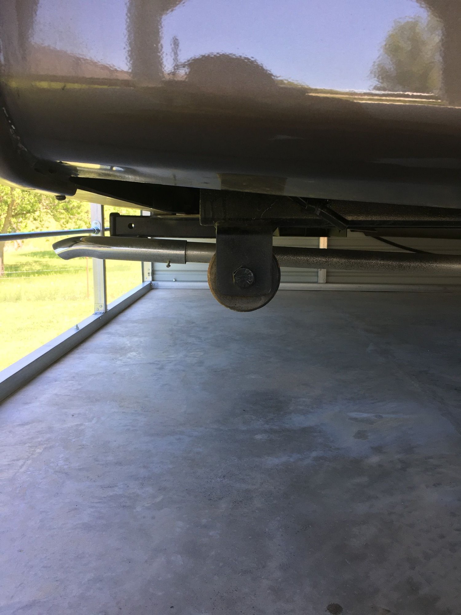

Took a trip to Two Rivers campground in Carrollton KY by the Ohio river. Was a nice little campground. Clean and quiet. Every site is full hookup and level concrete pad.
Knew that the rear was close at home when I turn to park but decided to see how close today. Was about 2” to spare. 2.5” if I dump the air out of the airbags 🤣
Dont have this issue when I can use the DRW to tow as the trailer sits more level, but with the SRW the trailer is nose high about 1.5” more

I had to add skid wheels to my frame when I back into our driveway. They were mounted on the trailer hitch but after I broke 2 wheels with all the weight going on them, I moved them to the frame. Now no issues but still a pain....

I have steel rollers on mine .
