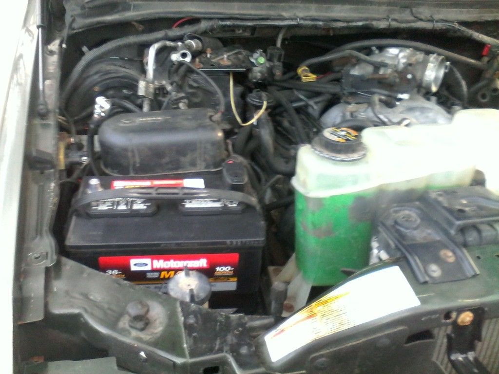

PROGRESS TIME.... WITH PICS!
First and foremost, the engine bay harness IS FINALLY INSTALLED!!! The only harness I have left to do is the tail light/fuel tank harness. Oh, and I still have to hook up the underside portion of the new battery cables. I had to splice in the wiper motor wires (the soldering part of electrical class REALLY improved my soldering) and I had to splice in one ABS lead, but it's done! I never though this day would get here!
Here are a couple pics of the passenger side- never mind the missing AC components, I have a hole blown in one of the hoses, so I'm not worried about AC right now (maybe next semester, when I'm in the automotive HVAC class. )
And another angle...
And here's one from the drivers side- the inner fender is still out- it made life so much easier when hooking up the firewall connectors. I still have to do the power steering stuff, so I'm going to leave it out for now...
And believe me, I'm leaving that cruise switch on the master cylinder UNHOOKED until I can get the recall harness!!!

Definitely looking a lot better. On the throttle cable bracket the little elbow hose behind is a common issue for drying out and cracking. As prevention and during replacement I went ahead and used some old hose as rub protection. See the picture below.

Is that the PCV hose? If so, mine's not under the throttle body- the ones with the port coolant attachments are on the side, near the brake booster hose. I have no idea why Ford used two different locations, depending on if coolant circulates around the PCV or not.

Interesting, my 99 uses the elbow you can barely see with another section connecting to the cable cover.
