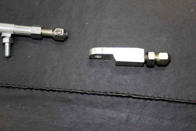

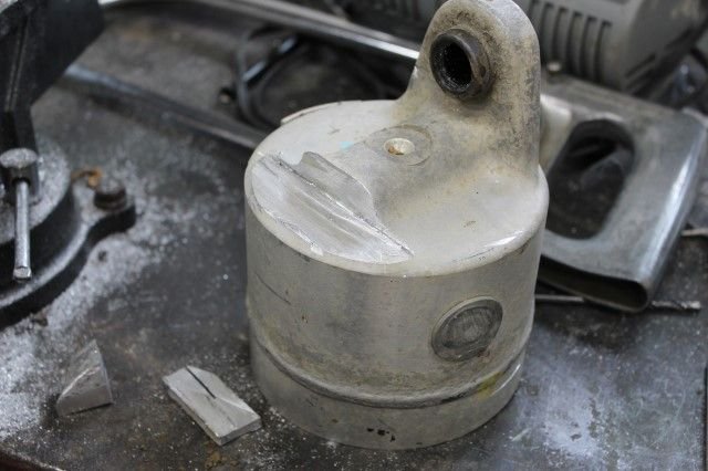

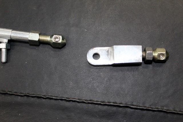

Last time I had the truck out was on labor day. The next day I started to remove the C6 transmission to replace it with an AOD, had the done in a couple days then installed a new Edlebrock performer intake manifold and 1406 carburetor. Been waiting for the end piece for the throttle cable for the last 2 weeks. Not sure if it was lost in the mail or just found the slowest horse to deliver it.Today I decided to make my own today so improvised.
I needed a piece of aluminum so cut the ear from a scraped drive shaft I had laying around.
The piece on the right is what I made. This was all done because I couldn't find a ball stud with long enough threads and had to adapt to the stud that came with the AOD correcter plate.
I also made the extra linkage arm and that triangle shaped piece so I can add cruise control later on..
And here's a few pics on the intake manifold and carb. Will be hooking up the linkage tomorrow..
Old Sep 28, 2017 | 08:17 PM
  #509
wpnaes's Avatar
wpnaes
Joined: Nov 2010
Posts: 30,593
Likes: 1,236
From: N. IL
A fine improv.
