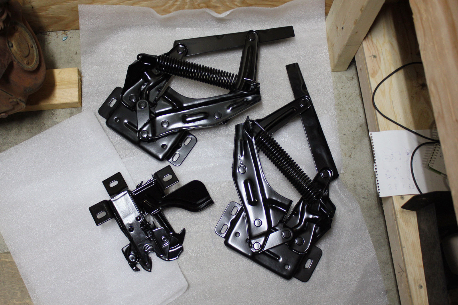

As the man who to my knowledge is the most recent case of a latch failure, I'd say it is very important to check your latch. I got a cash deal on my body work but by the time it was all said and done I was still in it $1,200 without repairing the dent on my roof. I now have aircraft cable holding my hood down as a fail safe. I also pull up hard on my hood every time I close it.
What people don't realize is that WD40 acts as a metal bonding agent after it dries. It is by far the most overused product out there. Spray some white lithium on your latch.
One thing I'd check is that your safety latch is located properly. One thing I've noticed, of course after my incident, is that with age the safety hooks don't always want to extend out.
Look at the latch. This is a brand new latch. Well, NOS, but it's the same thing. See the big hook in behind on the right? That's the safety, and that's where it needs to be.
Attachment 291837
Here's a worn latch I have lying around. Hmm, where's the safety latch?
Oh, there it is! Hiding! The latch is no longer wanting to extend outward. This is an extreme case, but it is to exemplify what happens.
A good safety latch's arm should be extended so much so that if you were to draw a line along the outer side of the safety latch arm, it would not cross over the latch body. When my latch failed, my safety's arm was parallel with the latch body. That's all it takes for a safety to fail.
One thing I've noticed between my old and new latches is that with the new one, I really have to reach in the hood gap to be able to grab the handle to pop the hood. My old one was a lot easier to grab at because the latch was worn. I'd never owned a bumpside new before, so how was I to know, right? I know now though and I'm pretty well making it my mission for no one else to have to go through what I did. Let me promise you that it sucks. If your latch is worn, spend the $80 on a new one.
