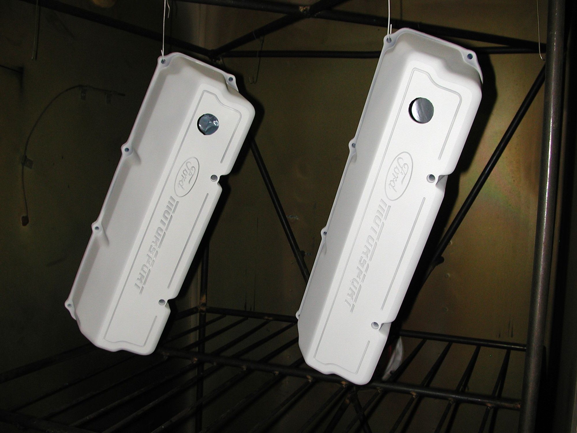

Valve covers dusted with the satin clear powder and ready to bake:

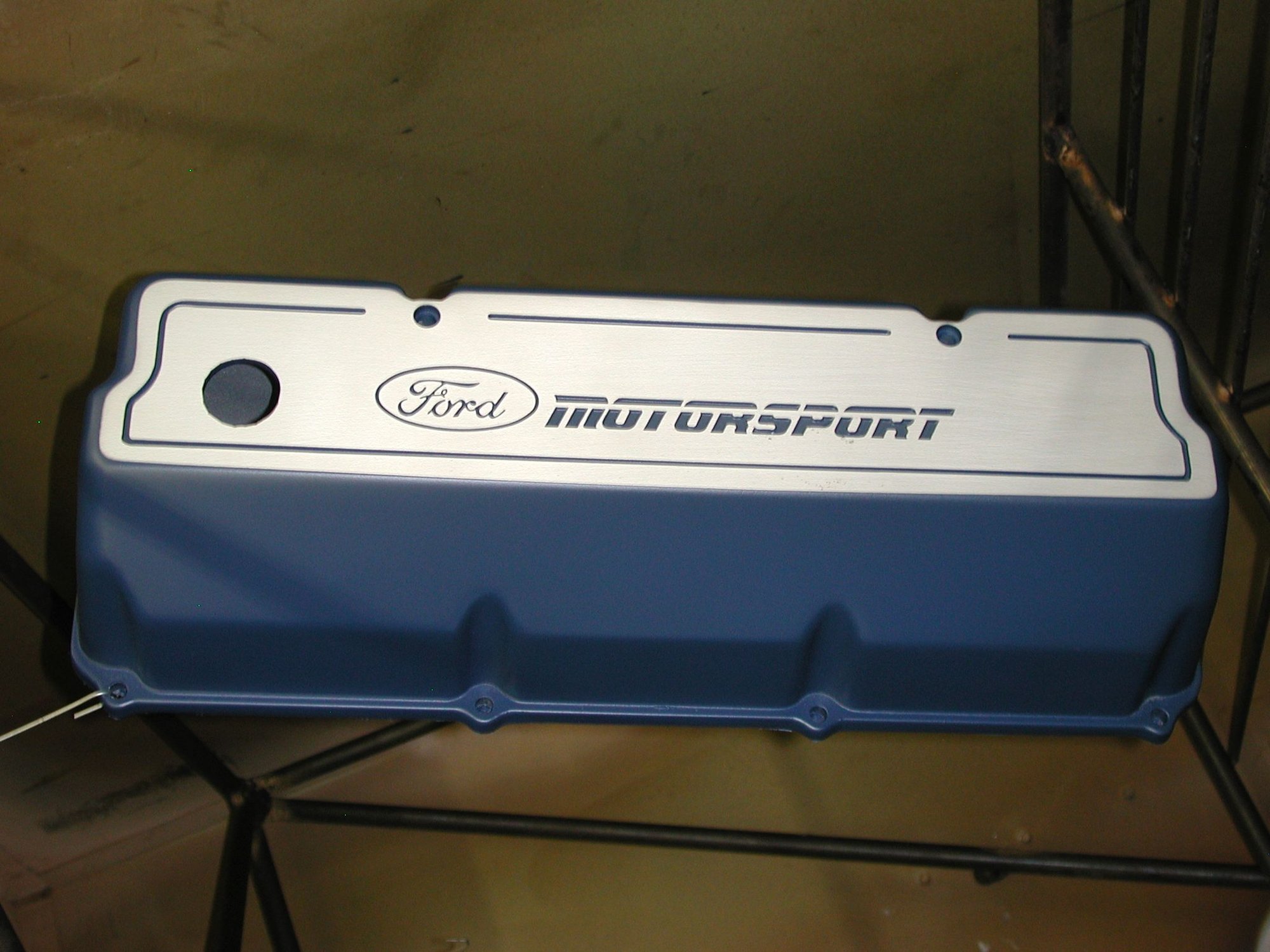

Here is one still in the oven, after baking. (Yes, I rotated it - it isn't standing straight out on a wire. )
And, here they are after cooling down. Note that I used satin clear, so the Ford Dark Blue is a satin blue, not gloss. But, I didn't want the brushed aluminum to be gloss, so.....

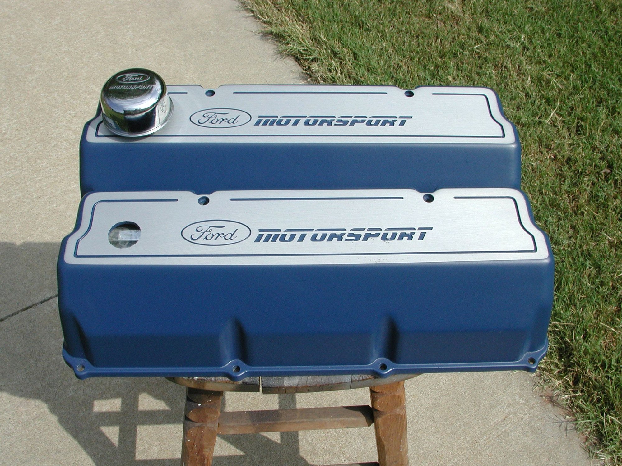

To close off this thread (yes, I actually do that from time to time ), here are the valve covers in final guise. I'm missing a PCV valve grommet, and have to turn down the stainless washers slightly as the paint and powder made the top holes a bit smaller. But, I'm calling the valve covers and, therefore, this thread DONE!
