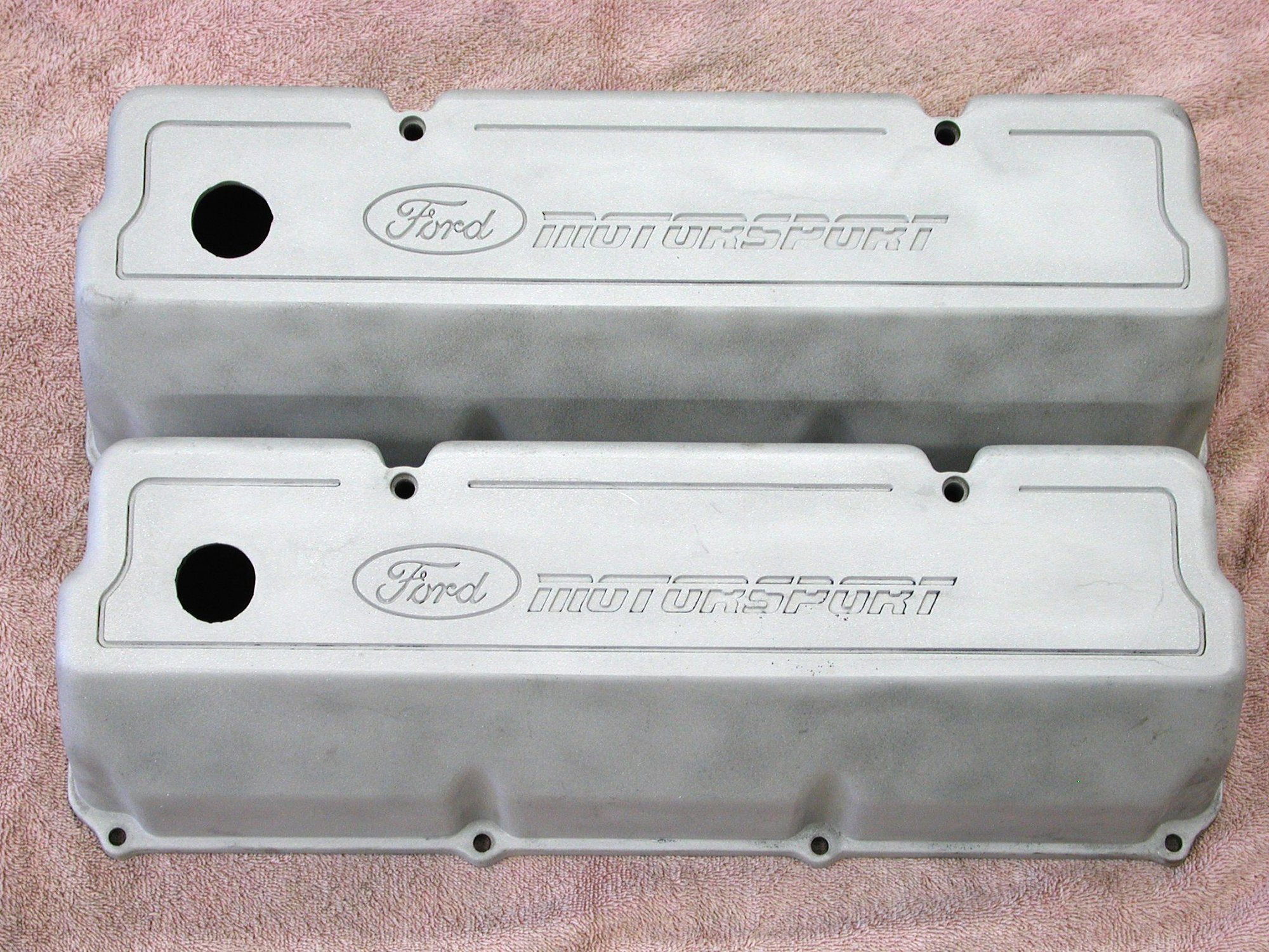

Update time. (I posted the same thing in "Dad's Engine", but since the work today is on the valve covers I thought I'd put it here as well.)
Since I'm not getting the engine done (church, grandkids, travel, boat, etc), I've contacted Tim and am going to be sending the parts to him for assembly. Then, when it is time to dyno it, my wife and I'll go up and watch it.
However, there are some things I want to do before sending the pieces up to Tim, and that includes painting/powder coating the various parts. I have the pulleys and mounts done, but have the valve covers, intake manifold, and some other bits and pieces to do. Plus, Tim has announced that he's going to be making billet distributors and I want to get one of the housings and PC it clear before it is assembled into a dizzy and put on the engine.
You may remember that I'm going with the following color scheme:
  • Old Ford Blue: Block, pan, valve cover sides and lettering
  • Aluminum: Heads, intake manifold, air cleaner top, A/C compressor, water pump, & thermostat housing, alternator, distributor, and power steering pump bracket
  • Black: Brackets, air cleaner base & snorkels, and pulleys
Given that, I started on the valve covers today. They spent probably 2 hours in the blast cabinet while I got all of the paint like this off:
I have them down to bare aluminum and they've been washed with brake cleaner, baked in the oven for 90 minutes at 400 degrees, washed again with brake cleaner, and then baked again at 400 for an hour. That process drives out all the impurities that hide in the pores of the aluminum, so they are ready for paint.
Tomorrow I'll tape them off and paint them with Dupli-Color's Engine Enamel Primer and then DE 1606 Ford Dark Blue, which are the cans on the left in this pic:
After that cures I'll sand the top down to have the natural aluminum look shown in the first pic and then powder coat them with a clear. I hope to get pics tomorrow of the covers painted blue, but I won't be able to sand them until they cure, so the next step will be a few days away.

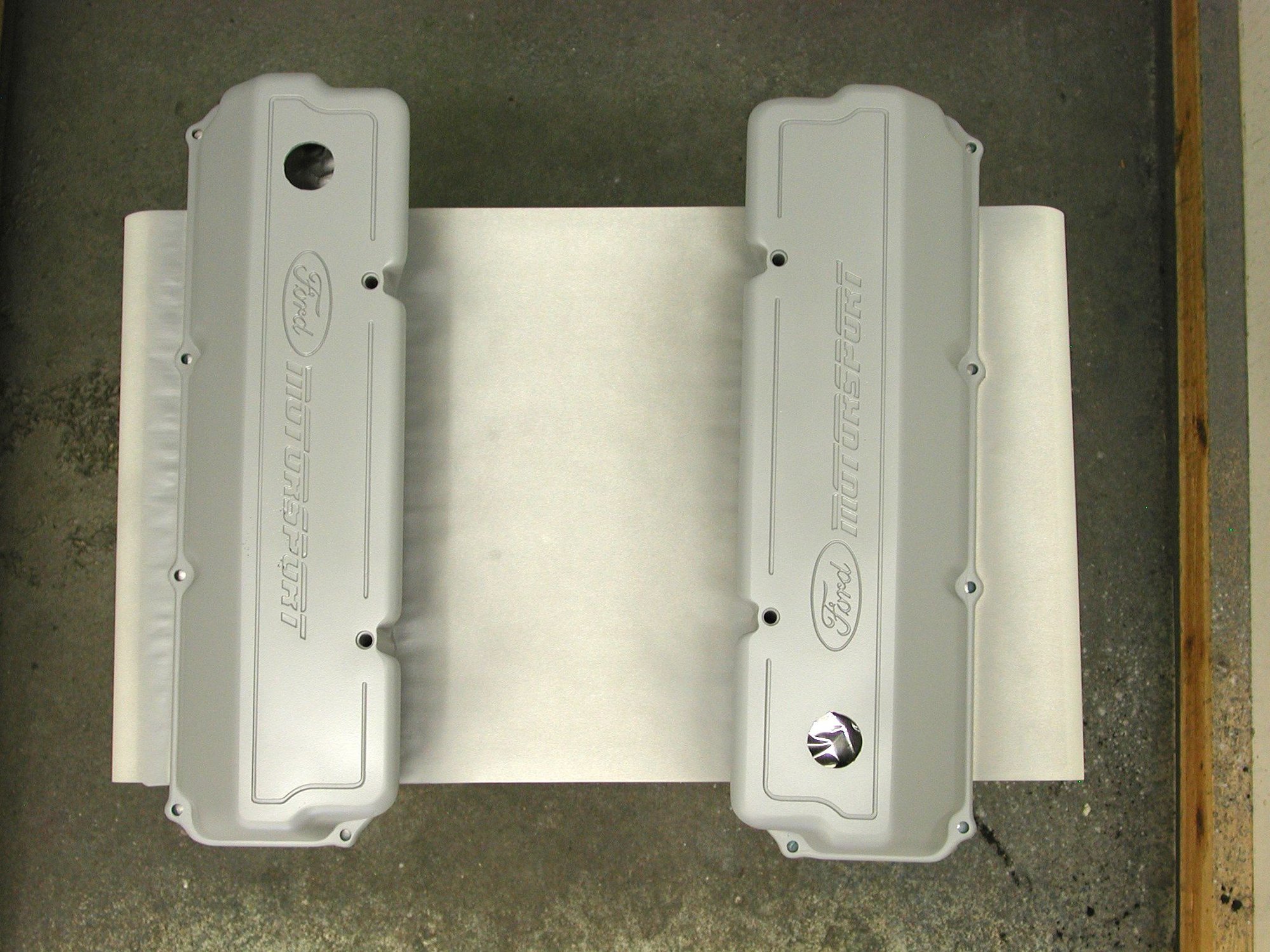

Today's update. Got the valve covers painted. First, here they are after their media blasting, 3 dousings in brake cleaner, and 2 trips through the oven:
And here they are with the Dupli-Color Engine Enamel Primer DE 1612 on them:
Finally, here they are with multiple coats of Dupli-Color's Engine Enamel DE 1606 Ford Dark Blue:
Hopefully tomorrow they'll be hard enough to sand, but I may have to bake them in the oven at 200 degrees or so to ensure they are hard and don't gum up the sand paper.
