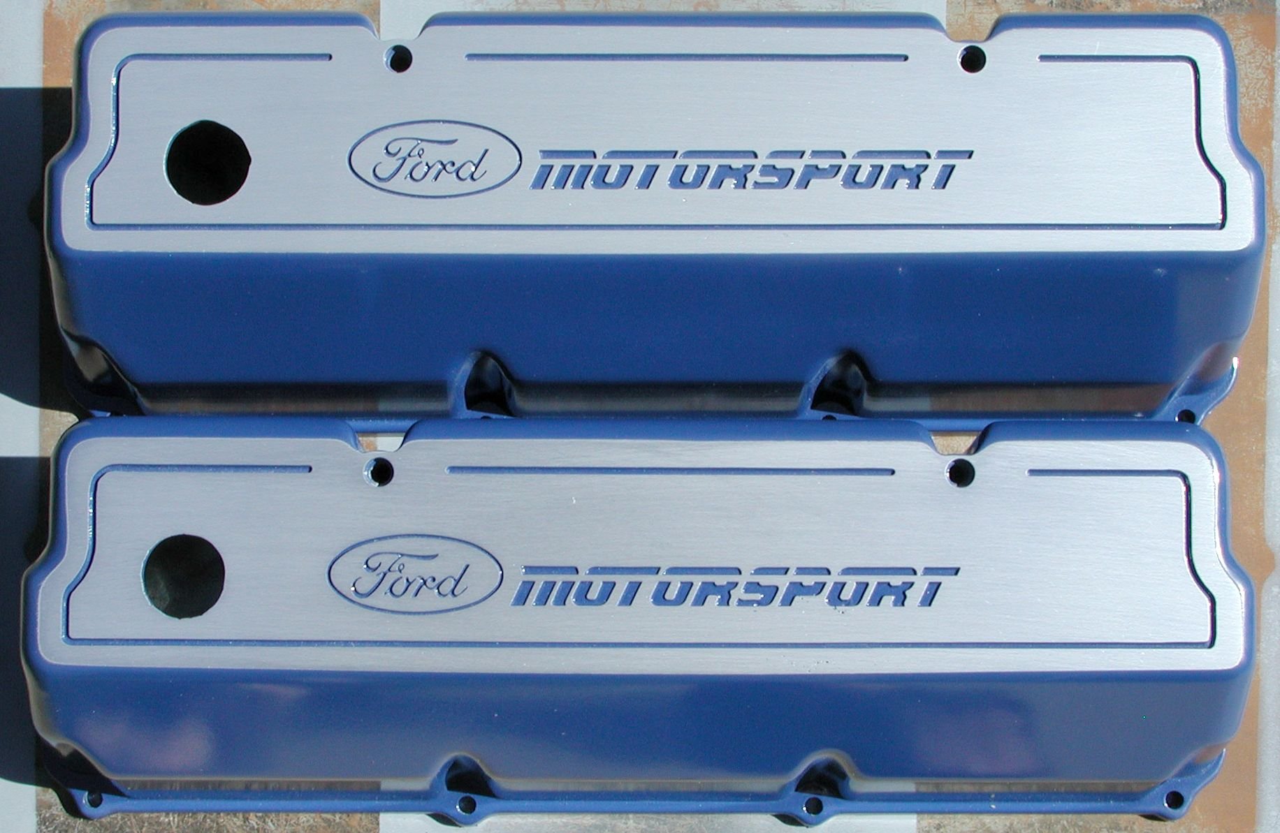

Well, here's what it looks like:

Give it some time, it needs exposure to oxygen to complete its chemical transformation.

Gary, Oven time is not going to speed it up that much, It does help though, as Jim eluded too in an earlier post it takes time for oxygen to permeate (if that's the right word) throughout for the cure.

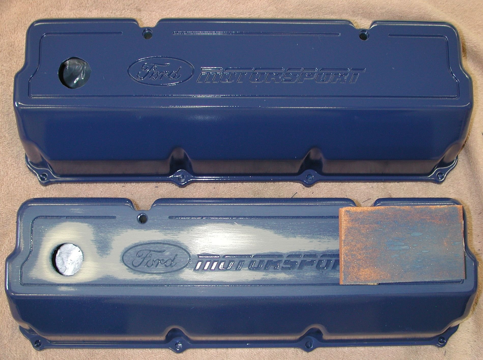

Got them sanded. New sandpaper and a day later made all the difference. But, there are some flaws, as shown in the second pic.
How bad are they, in your opinion? Wondering about coating them with aluminum paint, then re-sanding before PC'ing. Thoughts?

I think... it's a casting.
There's bound to be some kind of cavity or imperfection.
Remember how the borders were when you first did this?
BTW, I really like the color!

Yep, I'm sure it is just imperfections in the casting. Just thinking about how to make the dark spots go away, and wonder if aluminum paint might not be the solution.
And, I do remember the edges. But they look pretty good now.
As for the color, that is what the original engine was painted - Ford Dark Blue.

I did some very fine detail work like that when I was painting my gauges, those desk-mount magnifying glasses with the circular fluorescent light are MARVELOUS!
Go to a hobby store and get some really fine paint brushes, do you best to cover up the imperfections.

I actually have one of those lights. It was Dad's, and is mounted over the lathe. And, Janey being the artist that she is, I have some hand-me-down brushes. So, I should be able to touch the spots up pretty easily.
I had another idea, but haven't quite worked it out in my head. I have the "Blasted Aluminum" powder. What if I mask off the area and shoot a light coat of it into the recesses. Then squeegee off the excess and bake it enough to cause it to flow. Let that cool, give it a light sanding to ensure nothing is on the surface, and clear coat that?
I think I'll lay a part that has the Blasted Aluminum on it next to the valve covers to see what it looks like - and post a pic. The upside to this approach is that powder won't outgas when heated, but new paint will. However, I do need to bake the dark blue paint more to ensure it won't outgas, and I could be baking new aluminum paint at the same time. Hmmmm...

My take is you will make more of a mess than what you have now. Are you 100% sure the tape lines will be sharp? Then you say "flow" could the "flow" get under the tape?
You know the covers are like that (and now so do we) but once on the motor sitting in the engine bay with all the other shinny stuff will you see it?
If you think so I would take silver (alum) paint and a tooth pick (real fine brush) and paint the dark spots where it should be alum color. Let it dry a few days before knocking down high spots with sand paper and PC as you wish.
Sometimes trying to fix a little thing makes it worst.
