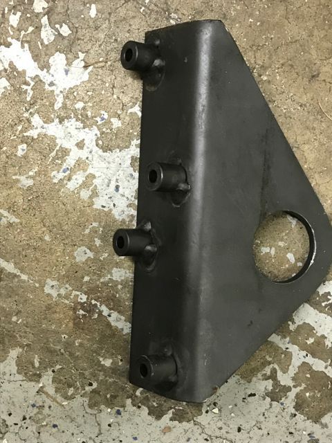

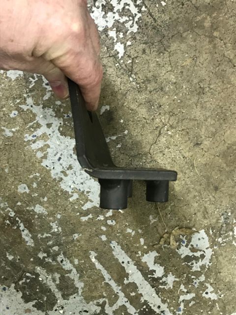

I'll have to go look at mine but for some reason I don't
think it's welded but done on a press break. So I will
post a photo later.

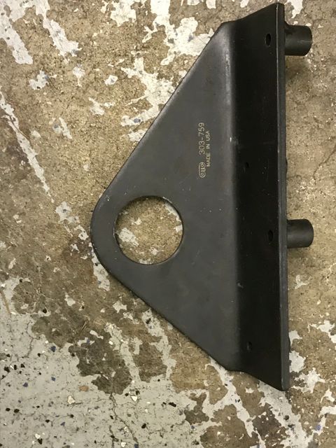

Here are the photos and yes it is bent and not welded.

Yep --- that's the one at the Ford stealerships (Rotunda Tool).
