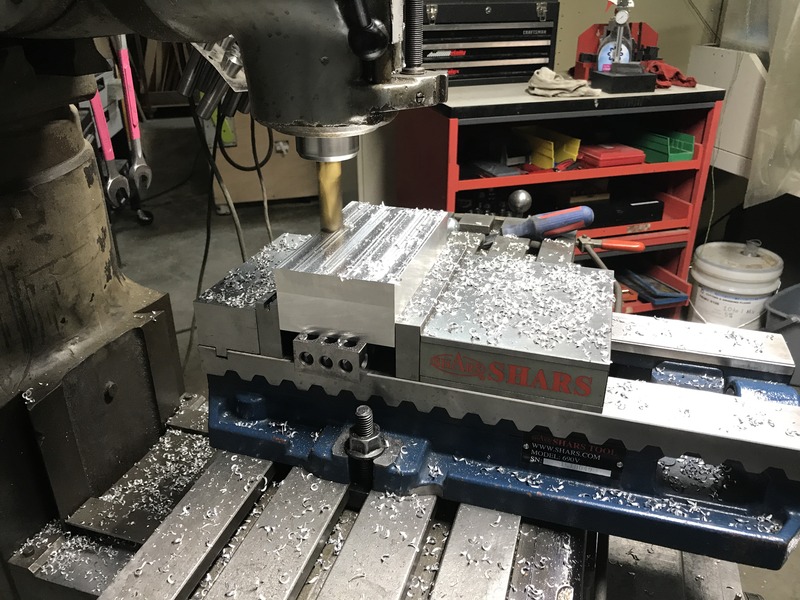

Started on the fuel manifold last night. Got all the milling done, just have to bore and tap holes. Great to be back playing on the mill!

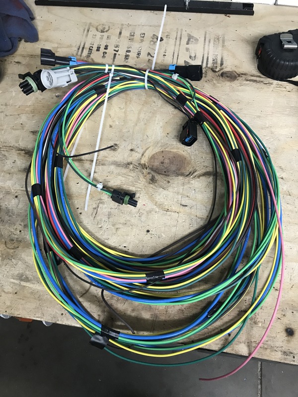

Made the rear wiring harness for rear lights, speed signal, fuel pump, etc.
