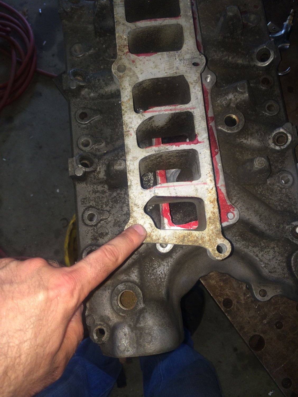

Nope, not that I remember. I can take a pic tomorrow of one I hogged out with my milling machine. (If I go to the garage)
351 intake is symmetrical ovals. The 302 intake has some weirdness, but being that the bolt pattern is the same, it's easy to match the ports with the correct tools. $20 carbide burr for aluminum, and a $10 harbor freight die grinder.

Pic of 351 gasket
Mostly ported lower

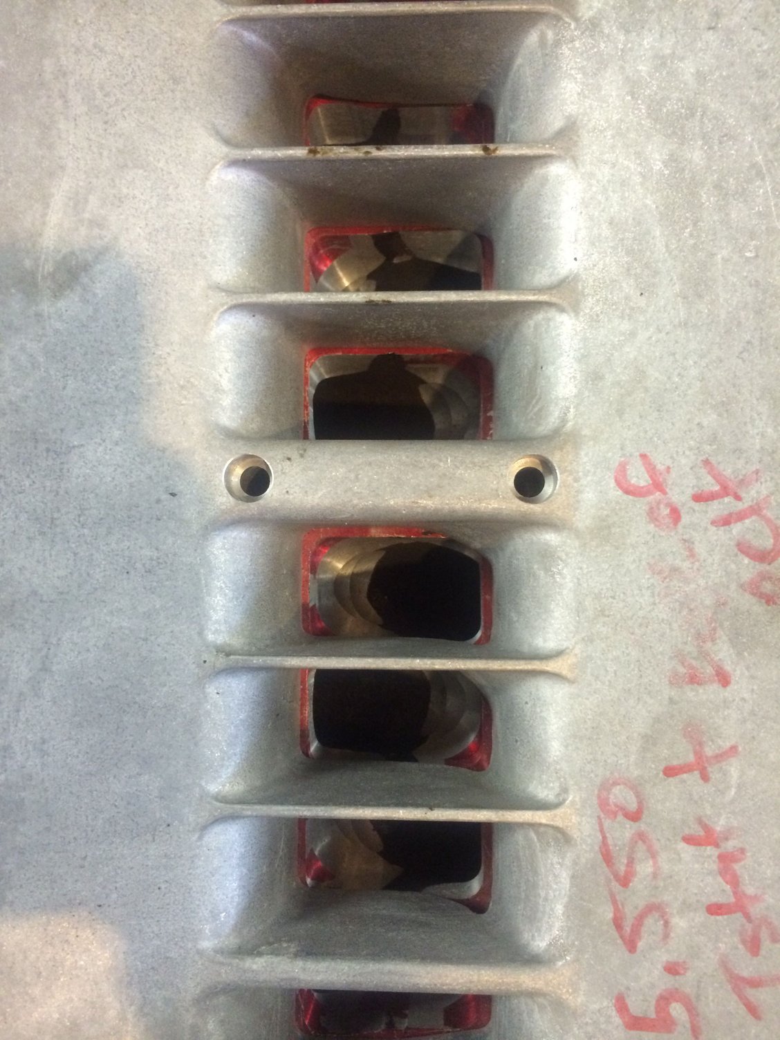

Vortech igloo lower half showing how much more it can go. The 302 gasket isn't quite that big.

Found it
The ports on my 351 lower are to size of stock 302 upper
The funky front port of upper can get blended to be less dumb looking.

So, you chopped off a 5.0 upper & used its (mounting flange?) as a grinding template on a 5.8 lower?
