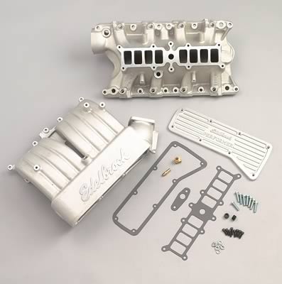

And here's the Edelbrock 5.8 truck Performer intake manifold. The smaller runners are pretty obvious here...
The Edelbrock Victor series has larger runners and would be better suited to a stroker or high performance 5.8.
