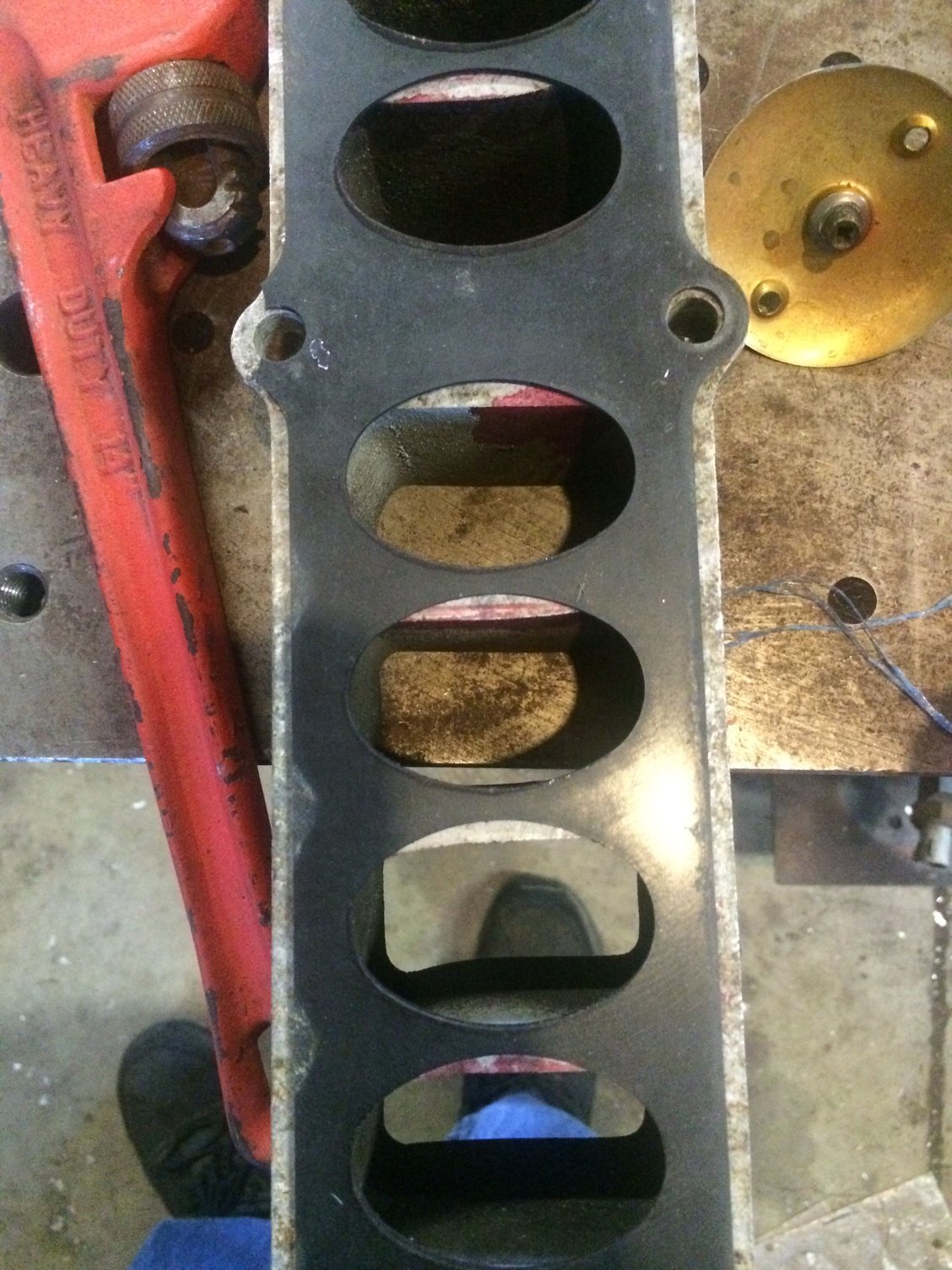

There is a little work to do on the upper.
I just took pics of the 351 gasket on the 5liter upper.
It's a problem of there being more material than needed. The webbing between the ports are real thick. I'd check the 5liter gasket to see if it's the same thick webs, and just port and smooth the upper to fit with the lower. Not a big deal in my mind. You're already porting the lower. Go for it!
