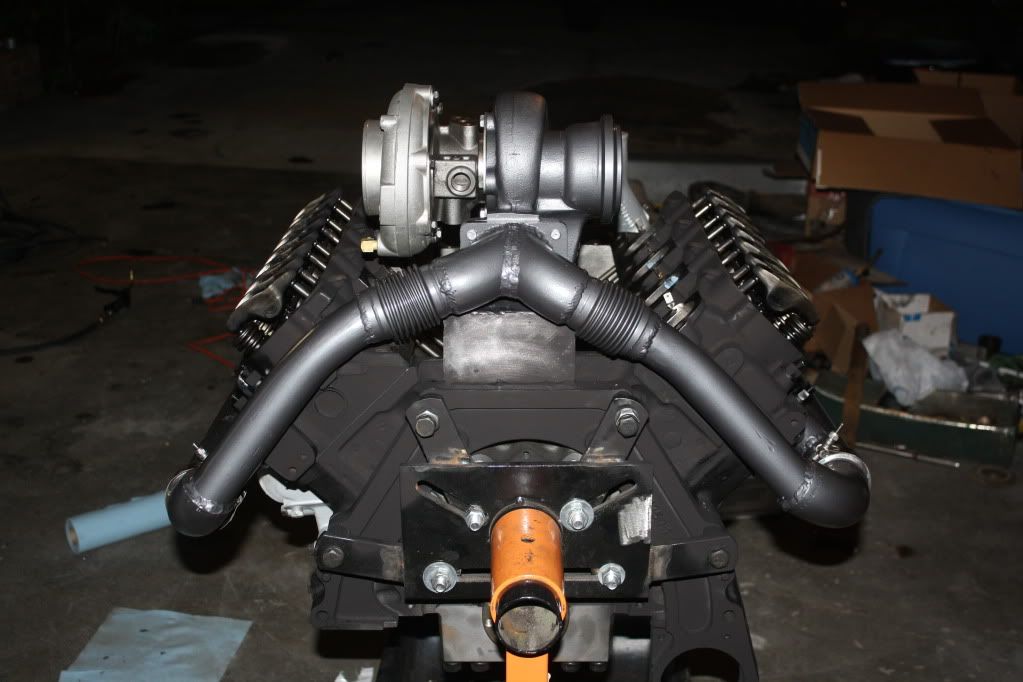

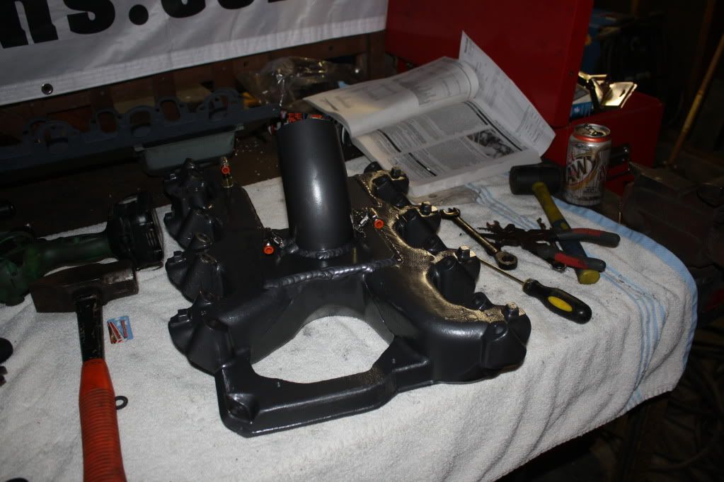

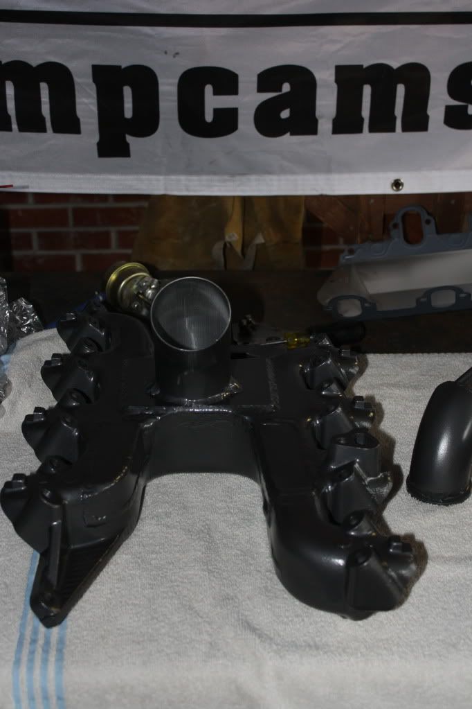

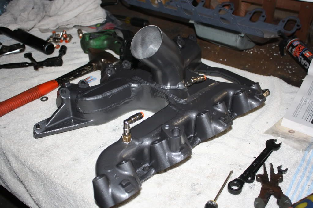

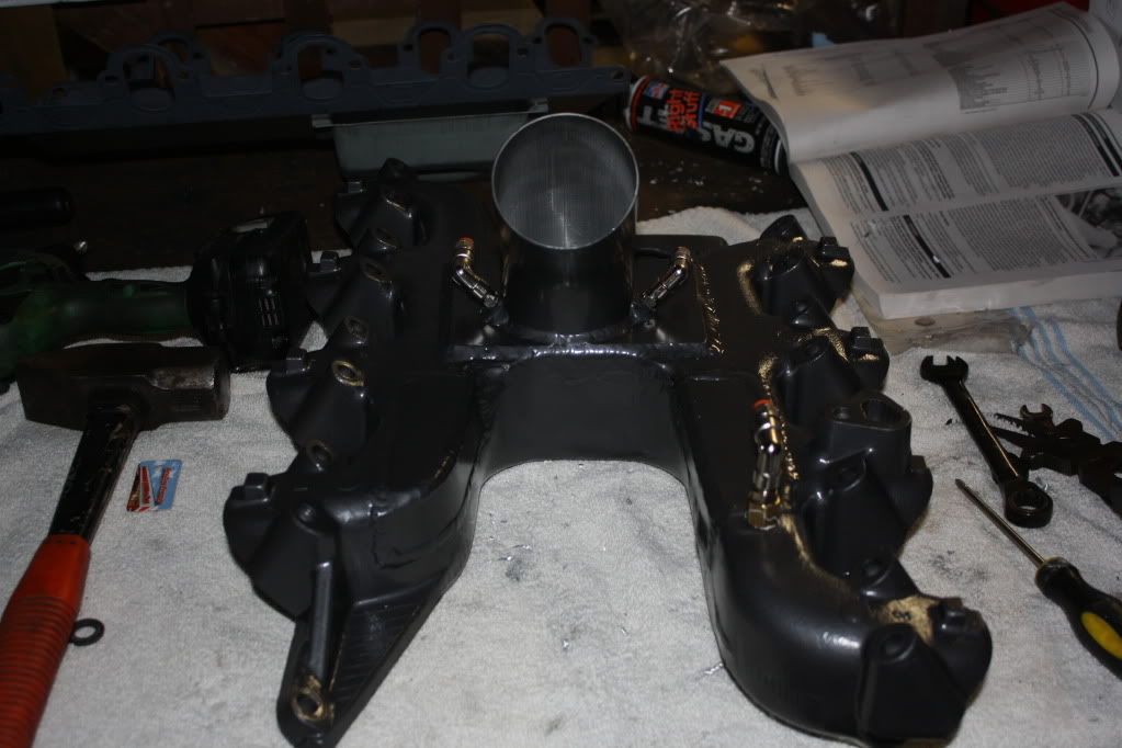

Here is what I have done tonight so far:

what are those connections in the intake for?
Old Oct 7, 2011 | 12:22 AM
  #59
1BadB2's Avatar
1BadB2
Joined: Jan 2006
Posts: 178
Meth injectors.

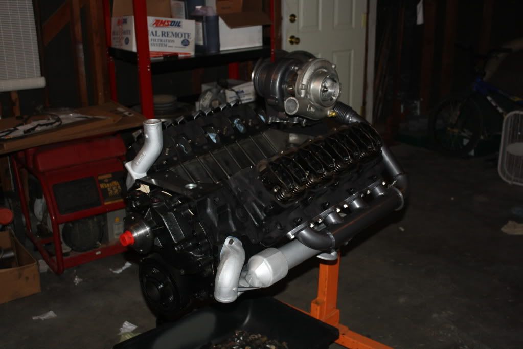

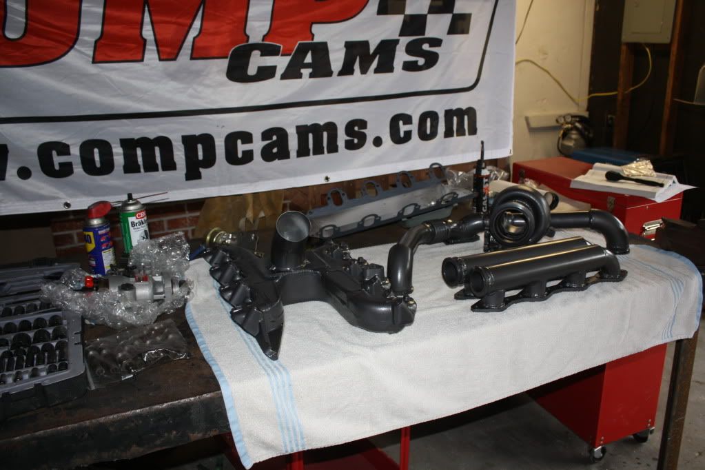

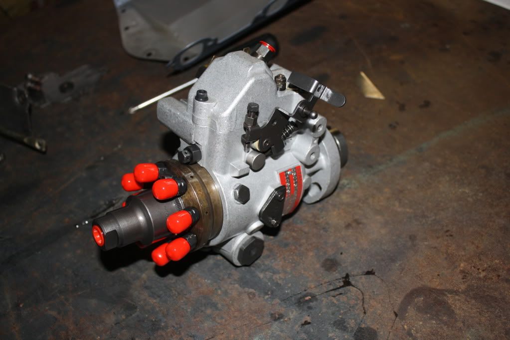

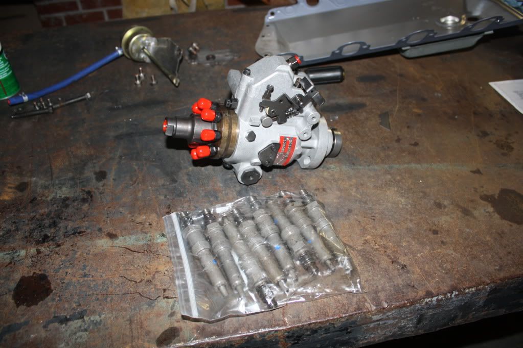

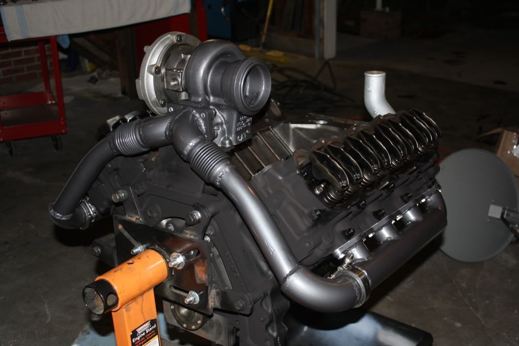

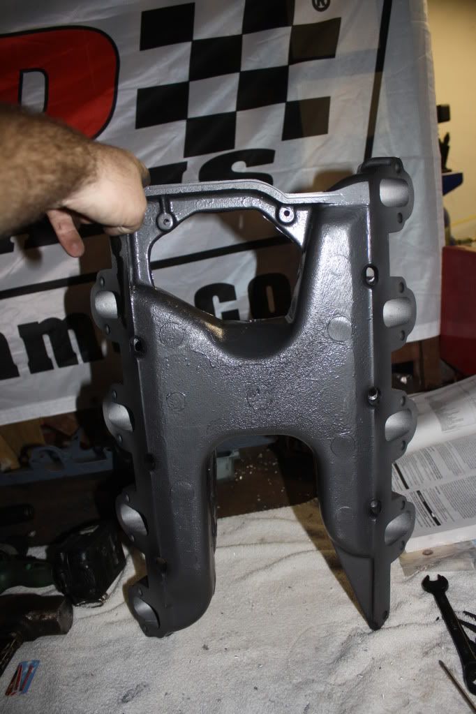

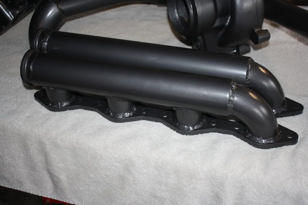

just some teaser shots....
my engine stand is becoming more disgruntled... wondering when the parts will stop pouring on.
