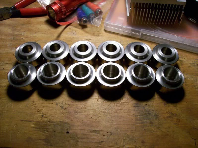

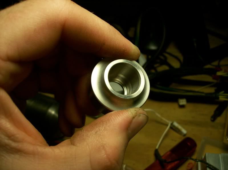

Originally Posted by turtlemann14
injector caps are half way done lol
there is some chatter in them, but she will buff right out
used bore sizes .607 and .638 plus or minus .001
fits good and snug on the injector
think a press fit would work for the barbs?
i have tossed that around along with silver solder and threading them in.
o and i am upgrading to a v12 lol
Nice! I thought about a press fit and then opted for the TIG and eventually solder...
My aluminum attempt:
Followed by FAIL:
Followed by brass design:
Silver solder works great:
At least 2 years, no leaks:
Best mod I've done thus far. No more cranking or diesel smell under the hood.

Those are pretty neat. I have never thought about doing that before. Did you guys have to have those machined or were you able to buy the pieces somewhere? I would be interested in doing that some day...

machined, i think mechelement was selling them, no?
yea, it is hard to get a good weld on something like that takes a lot of power and a tiny electrode.
i might go with silver solder, i need to heat one of these up and see what it does as i have been told it's liable to warp into a cube being stainless.
may i ask what you used for the bore sizes?
