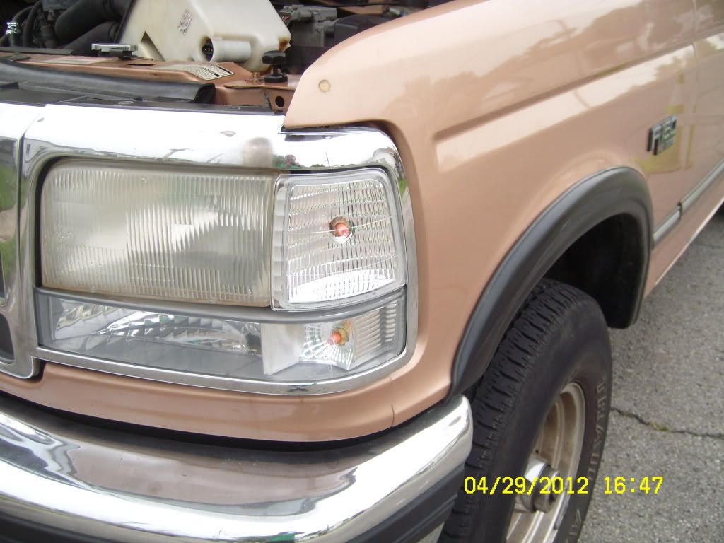

Well work has started on the truck, albeit slowly but its in progress, pics are being taken, stay tuned for the pics of the truck (and the **** ) to be posted!!!
Found another problem that was a $5 fix, the heater hose "dump valve" dry roted out and had to fix that, thankfully I started dickin around with what I thought was for the AC system and found the issue!!! (fix pic comin soon)
start of the headlamp switch
Start:
My friend Kenny (who is helping me with the work!) starting the work!!
Figured the battery removal would make it faster (which it did)
the screws are out
The 194 LEDs im going to use
got one out, but hit a snag....
unfortunately the headlamp switch has stalled the new lamps don't seem to fit/match up properly as they should, but we arn't going to give up on the corners either, were determined to make some progress as Henry Ford would be disgraced if no progress was made so yea were leaving the old lamps in for now till I figure out something else...corvers are getting switched out tho!

Looking good Jaime...
As for the headlights...After you remove the 3 clips, and slide the old light bucket out..
Slide the new one in, and push HARD....The plastic retainers at the end of the adjustment rods (The pieces of plastic the clips actually latch onto) have a SMALL little groove in them, that HAS to be on the backside of the plastic headerpanel...(The big plastic panel EVERYTHING hangs onto)..
It'll take a second but that's the secret..lol
