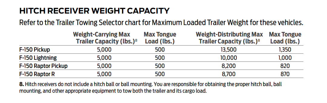

You just seemingly want me to be "wrong" so bad...
The maximum tongue weight I was referring to is not a function of the load but that of the towing equipment (tow vehicle, receiver hitch, drop ball adapter etc...) where I elected to suggest 500 as a plausible number. You chose 1000. We can each backup our assumed numbers. Regardless of our assumptions, the actual tongue weight (the ideal ~10% you correctly have mentioned) must not exceed the capabilities of the equipment (take the minimum from the system, wether it be the receiver hitch, vehicle rating, drop ball adapter etc....). An example of towing equipment ratings from the 2024 F-150 Towing Guide:
Your normalization around the lifting of the truck off the ground as pictured is alarming to me. The trailer is not blocked/supported and there are no tire chocks pictured. It could be completely possible the only thing keeping the tow vehicle and trailer in place is the parking pawl in the presumed automatic transmission that would lock the presumed RWD axle. Maybe they even engaged the parking brake so there is friction material engaged locking the rear axle too! Lift that rear axle off the ground and now you have the potential to roll away as nothing is preventing any of the ground contacting wheels from rotating causing a runaway.
I regularly tow vintage tractors similar to what was attempted in the pictured incident and would not be satisfied with the pictured situation as it seems. If this unfolded at any of the tractor gatherings I attend, there quickly would be a flock of men that would become belligerently friendly to the foolish perpetrator and provide strong suggestions and assistance.
