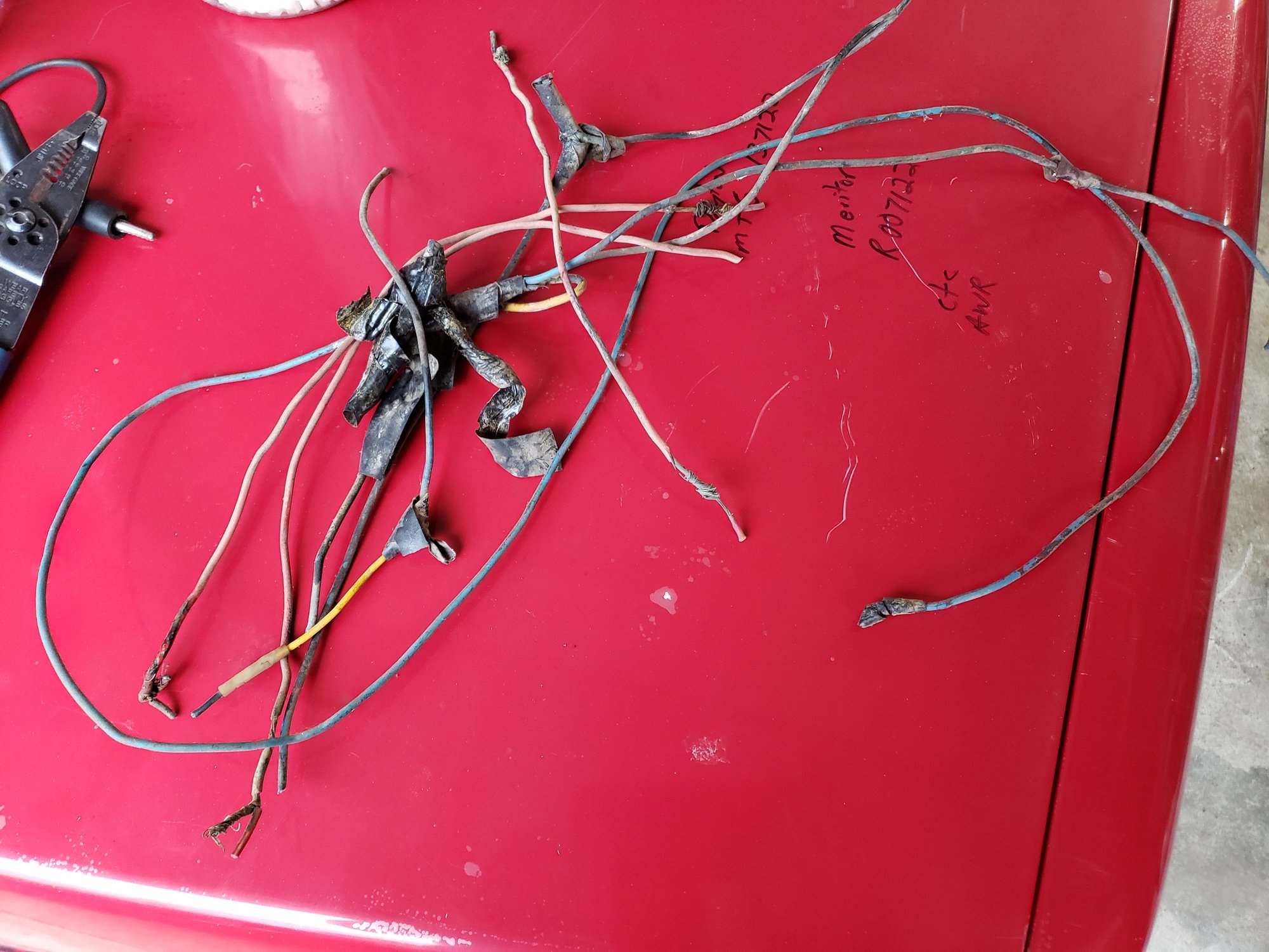

I worked on the tail light wiring rat nest last night. I pulled a pile of nastiness out. Soldering and heat shrinking and looming it all back. What would you know? Rear lights are functional tho I plan to add some marker lights to the end of the bed soon as well.
I failed at a before and after photo but that is the junk removed..terrible.

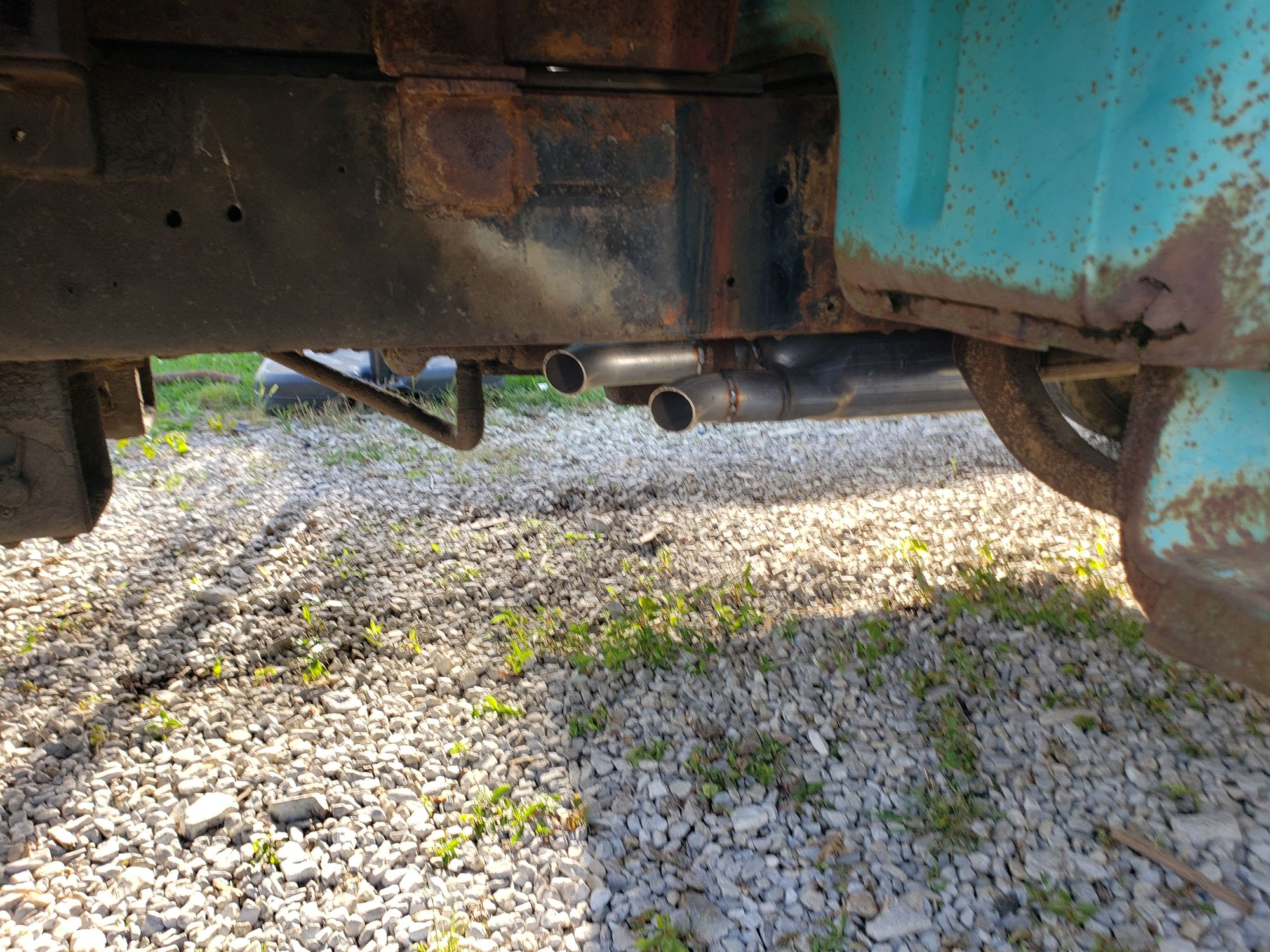

I just don't know how long until I would. All my other stuff requires synthetic. Maybe I will and run it a while and service it again. What is in there must have a lot of parifine in it.. the gunk in the ends of the tube is weird like parifine. I need to get it hot!!
I put a new muffler and tail pipe on last night. I serviced the trans also.. poor np435 only had maybe a quart in it.. 4qts in so we will have to keep an eye on that. I am afraid the pto where the shifter plunger goes in prob is seeping.

new exhaust, serviced rear diff.

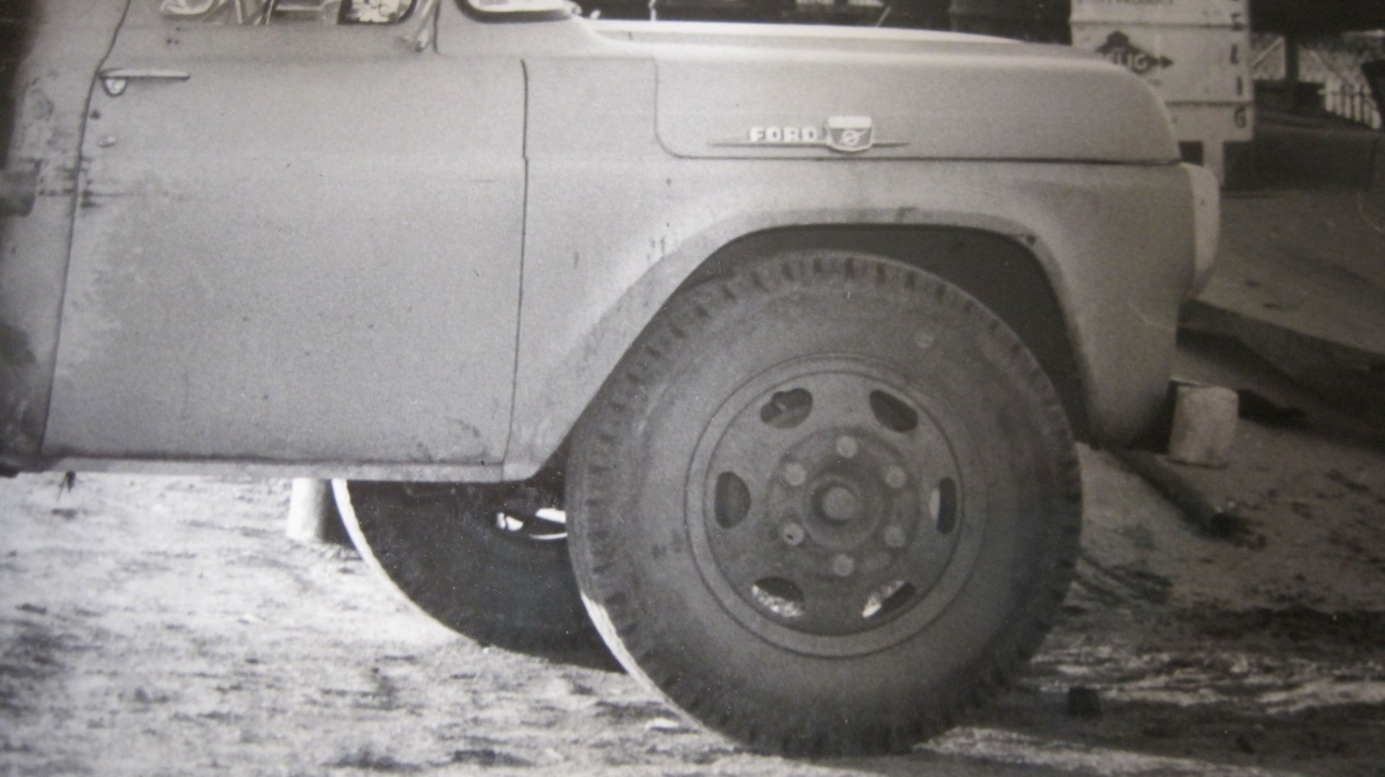

Do these '61-'66 F 500- 600's, with standard narrow front axles, really need those large fenders? Photo of this '66 F 500-F600 reminds of the way '57-'60 F500-F600 were built, with narrow fenders.
