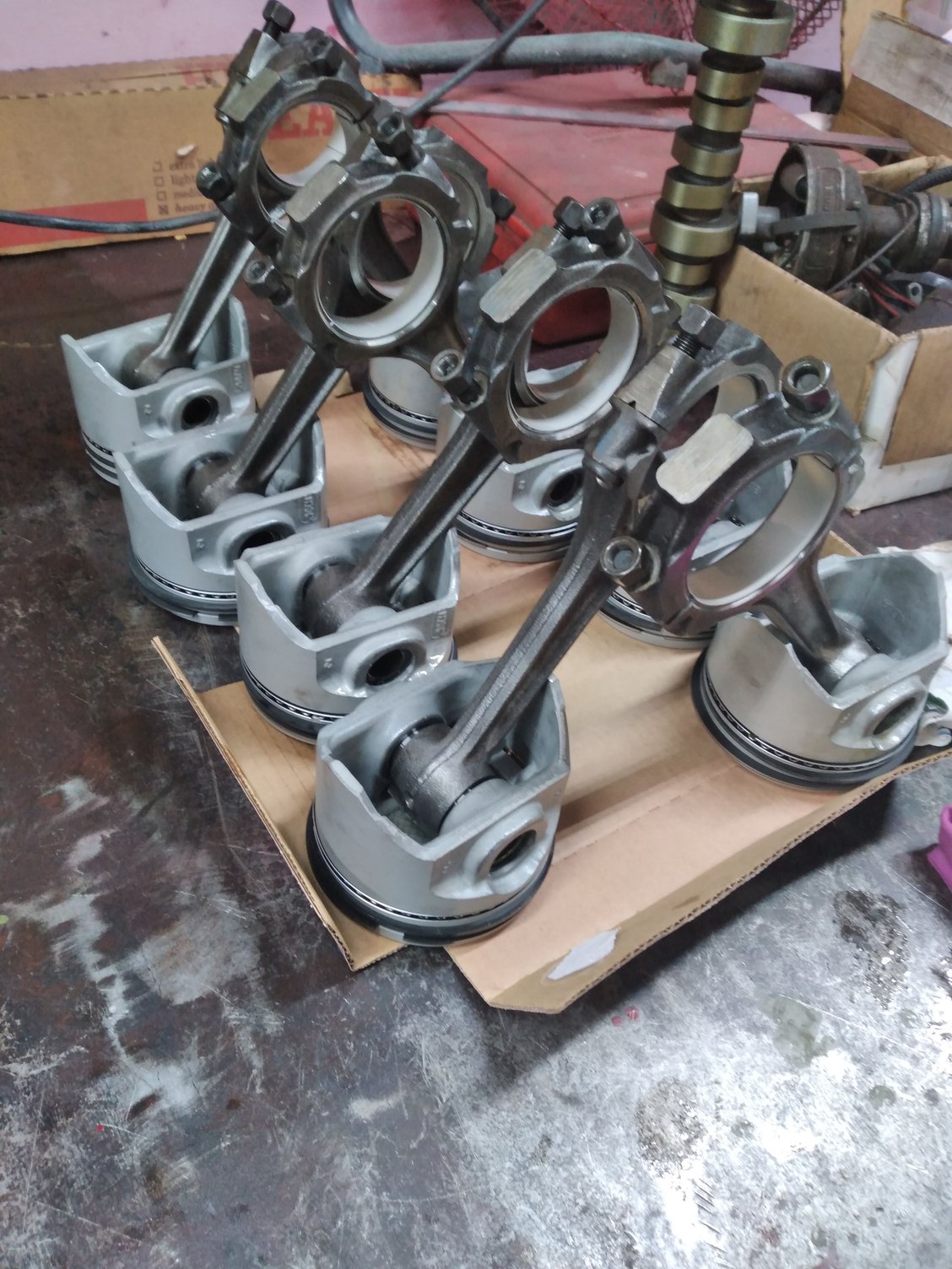

Old Apr 12, 2020 | 11:22 AM
  #49
fordman67's Avatar
fordman67
Joined: Dec 2005
Posts: 14,379
Likes: 609
From: evansville in
i finally bit the bullet and got these bushings in. Good thing i did. The crank had condensed enough moisture yo get a lil rust on it. It scotchbrited off but man i almost messed up. Either way moving forward.

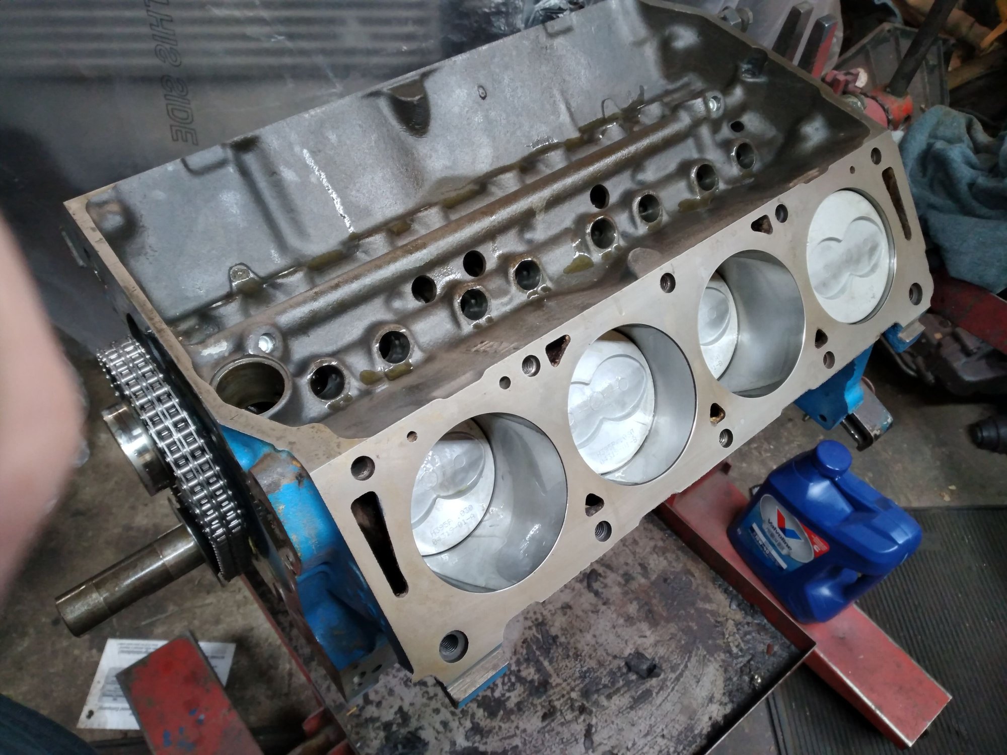

Old Apr 12, 2020 | 11:26 AM
  #50
fordman67's Avatar
fordman67
Joined: Dec 2005
Posts: 14,379
Likes: 609
From: evansville in
short block is close. Hope i can tinker today on it.

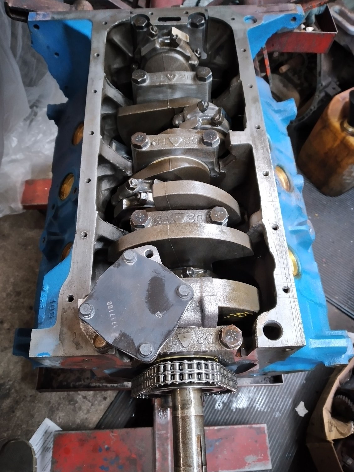

Old Apr 17, 2020 | 11:29 AM
  #52
fordman67's Avatar
fordman67
Joined: Dec 2005
Posts: 14,379
Likes: 609
From: evansville in
P
well, moving forward. Sadly the pickip block has the boss but not drilled. No biggie, i drilled and tapped it. Pan is on. I cant find the dang head dowells tho. The search is on for them now
