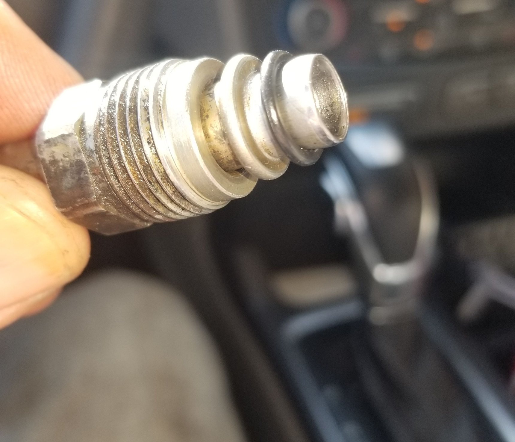

This second pic is the fitting that was on my original truck that was different than the 94..

Good Job. I've been trying to get a fitting to match the one in your last picture. I want to get rid of the factory style hose and switch over to an style stuff. This fitting to 6 -an is the last thing I need.
Jess
You can't get that fitting that's why you have to switch your power steering pump to match the 94 hose. Possibly because ford switch to metric??? I tried every shop in NJ and none could do it.
Pump costs 25$ with core.
It's not the pump end. The pump end is in your first picture. I need the end that goes to the HB.
This one on the right(I lost the o-ring), the new one is one that I bought that I read would work. Russell #648060, -6an to M16 x 1.5. It doesn't fit.
For the pump end I just removed the large fitting that attaches to the pump from the truck I got the HB unit from, the hose end threads into that. No need to change pumps.
