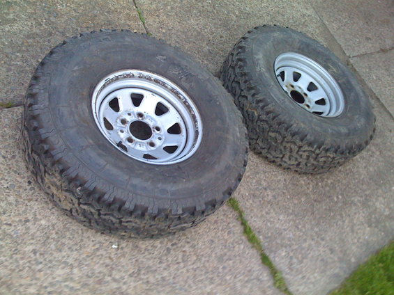

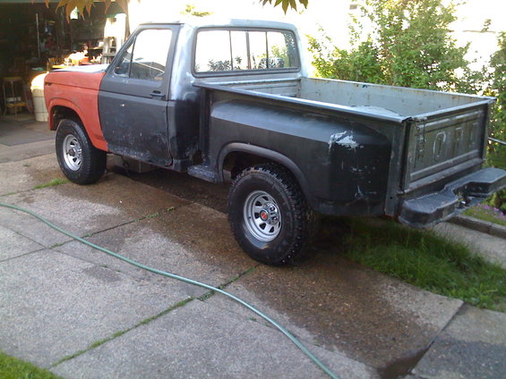

Well, I just got back from a LONG and HOT day of shopping at two different yards today and stopped by a used tire place near my house on the way home.
They had two pretty nice 33 x 12.50 R15's there and I was able to talk the guy into letting me have them for $20 each.
Got them all mounted up and threw them on the back of the Rat Rod. It looks like they are barely going to clear the fenders once I drop the rear axle with a home brewed "flip kit". I ordered a pair of universal rear spring hangers from Summit Racing and they came today too: $17 to my door in two days.
Here are a couple of shots of the 33's on the truck. Man, there is a LOT of room there! The new plan is to run some 30 x 9.50's up front. It will of course be dropped too.
