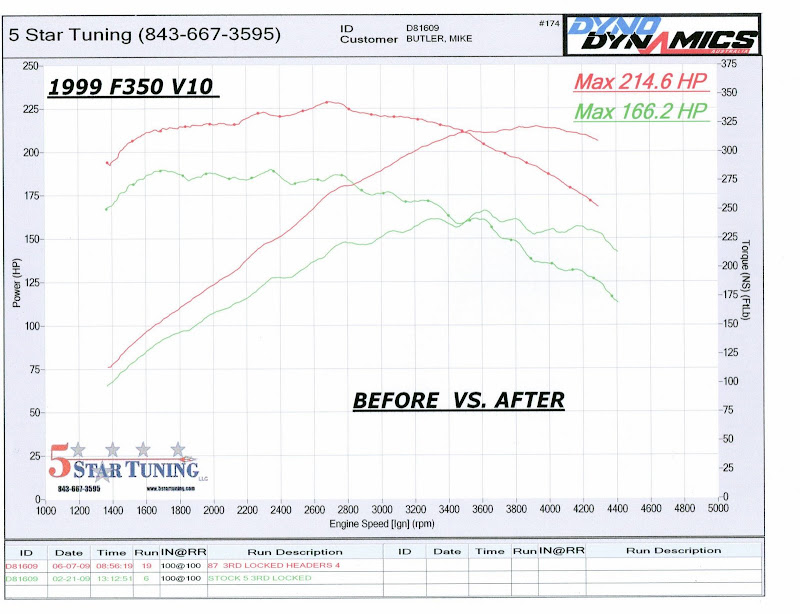

Morning V10'ers... Felt Froggy this morning.
Sorry for delay on this. Here are the runs with headers.
I got the original worn out tires back and did runs 285/75/16, I also added SB intake and FM70 to truck as well vs last runs.
Hope you enjoy its taken a lot of work to do these runs over the last 4-5 months with trying to keep conditions consistent as much as possible...

Mike, what headers are those? And you didn't change anything in the tune before and after the headers/muffler?

Hedman headers black painted LOL... No changes in tune.

Mike,
On the last run what do you think made the most gain, Headers, FM70, or CAI? I would think FM70 made the least change, followed by the CAI while the headers made the most gain. How is the fit of the Hedman headers?

So about $1,500 for 48.4 horsepower?

Mike, could there have been so much difference in the tests that your numbers show 27 horse more than mine with nearly the same mods? Plus I noticed that you ran your tests on the 87 tune whereas mine were run on the 93 tune. Something seems off.

Hi dew
I was suprised in numbers myself and did another run right after with same results. Keep in mind different dynos and I have trans programmed to lock torque converter in 3rd. I only did tests with 87 octane gas.
I think the main point to take away from last run is there are gains with headers. I think the intake and fm70 helped the headers. Also, on the headers we are using the Hedman ypipe as we had to remove the spd to install headers. Fit on Hedman headers are good, the ypipe of theirs is a little to close (tight not good) to the trans on the cross over.
