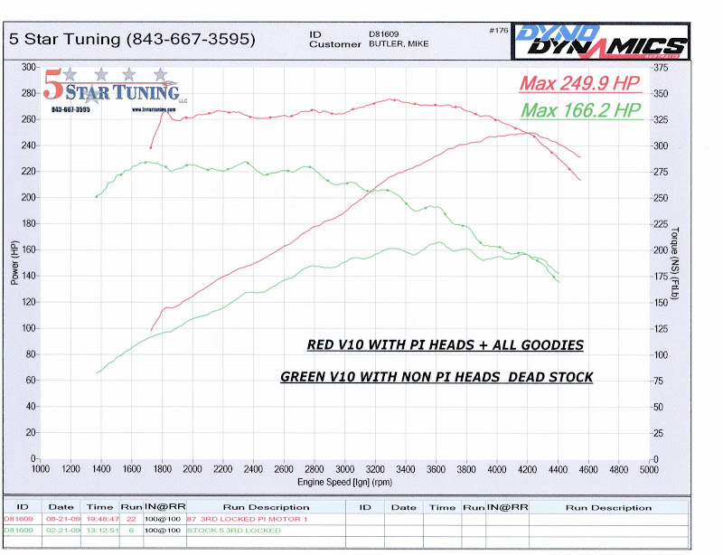

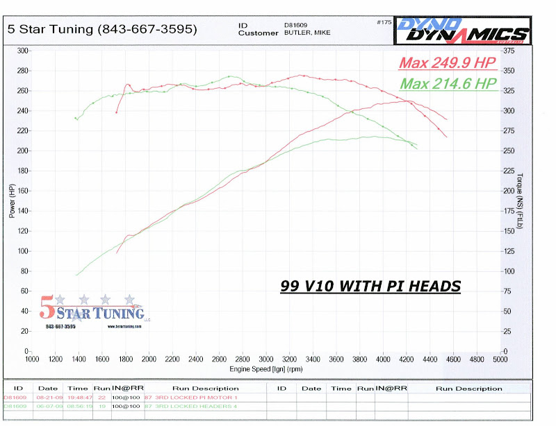

PI Heads... NICE!!
Wow I am a believer of PI heads

So 35HP with just the heads and 83HP with heads, header, tuner, CAI. Nice!

Hey Monster
Yep... even running same tune have not changed a thing..

Pretty awsome gains with the PI. The non-PI starts falling off sooner than I thought. Gotta love the flat torque curves on both though.
You wouldn't happen to have one a throttle body spacer for the V10 you could try? I'd be interested to see if the spacer does anything good or bad.
