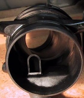

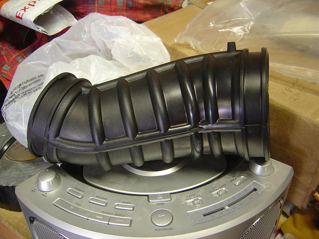

<TABLE><TBODY><TR><TD vAlign=top width="100%">You are talking of the orange hose , I think that is not fabricated any more, you may try here: http://intakehoses.com/Merchant2/merchant.mvc?Screen=CTGY&Store_Code=I&Category_Cod e=FPM it is for a "bolt on", direct change from the original orange hose, or you may want to upgrade with the black hose (like is in the pics posted below), you have to buy a kit: Intake Hose Kit (updated kit replaces orange hose, includes replacement for aluminum center section)
(Ford) F7TZ-9C681-AA
Intake Hose, updated black (Replacement hose for above, does not directly replace orange hose)
(Ford) F81Z-9C681-BA
The first one is if you dont want to do the CCV mod and the second is if you are going to do the CCV mod, and you dont need the part of the second pic and you only need to add a piece of exhaust 4" OD, 3-4" long. and the air will flow better.
