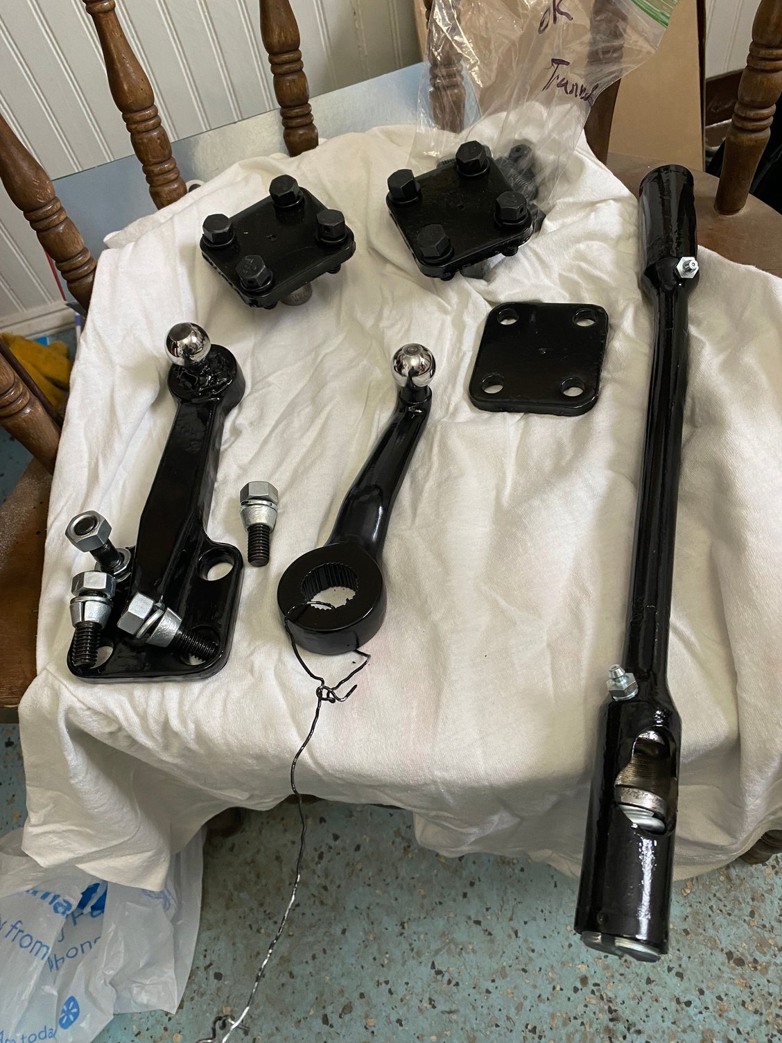

Just a picture of the steering bits for my MH. The pitman arm is new, the steering arm had a new ball and stud welded in some time in the past. I know the adage of welding steering parts, but this survived some time as a field sprayer, and ranch work, so im not worried. No wear on replacement. All hardware is original, just refinished, save for stud nuts; the originals were pitted. New nuts were refinished. The ball seats in drag link fit the ***** with no slop, so they were polished.

Thank you! Hadn’t looked at steering arm too closely since I dis-assembled front axle. I knew the pitman arm ball was egg-shaped. Lucked out with the steering arm being in great shape.
Once I saw the shape of the pitman arm, I started looking at new one on line and saw someone on eBay with a new DC piece for a third of the price from DC. Hit the buy it now button quickly.

I know you have your shims captured for the steering caps? If somebody new tackles one of these beasts this is an important detail. Stu

I do, except for under the actual steering arm. I saw witness marks that at least one was there. Have some from F6 axle.

Owen, be sure to have a close look at that steering arm ! I thought mine looked good also until I sandblasted it for paint, that's when the cracks revealed themselves, YIKES!!!. Had them welded and also added some gussets to reinforce the weak area, something I would highly recommend.

Thanks for warning. I did blast it, and examine it. I didn’t see any cracks. The actual ball/stud was welded in top and bottom. I trimmed remains of threaded stud off and dressed welds slightly. Gussets aren’t a bad idea. Seems rather spindly.

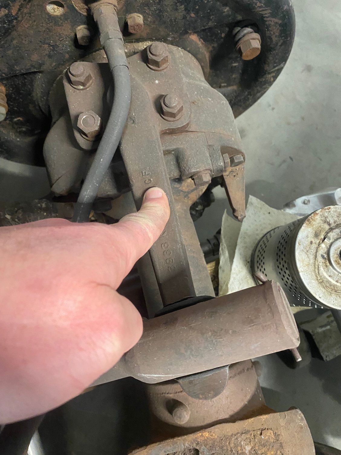

I will have to look again at steering arm on MH F6 axle I have. I don’t believe that is very sturdy. The bearing caps are a little bigger than the R32s, but the actual housing is the same size afaik.

F6 steering arm… not too thick just longer than the 3/4 tons
