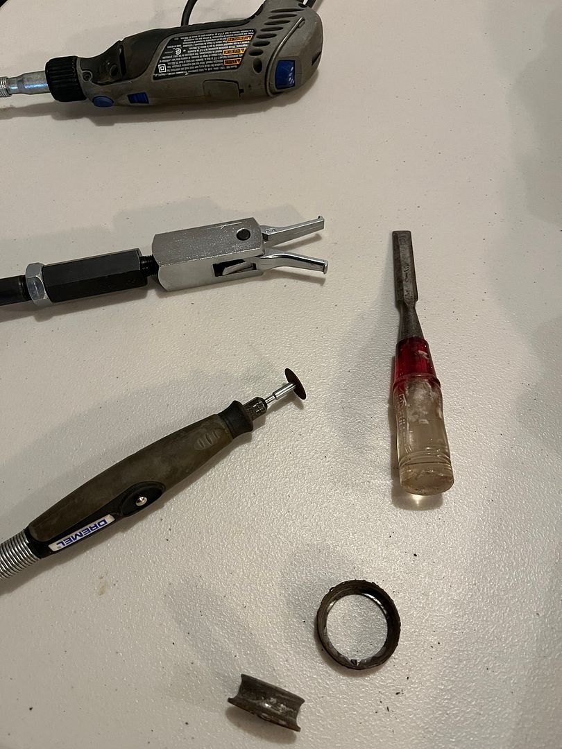

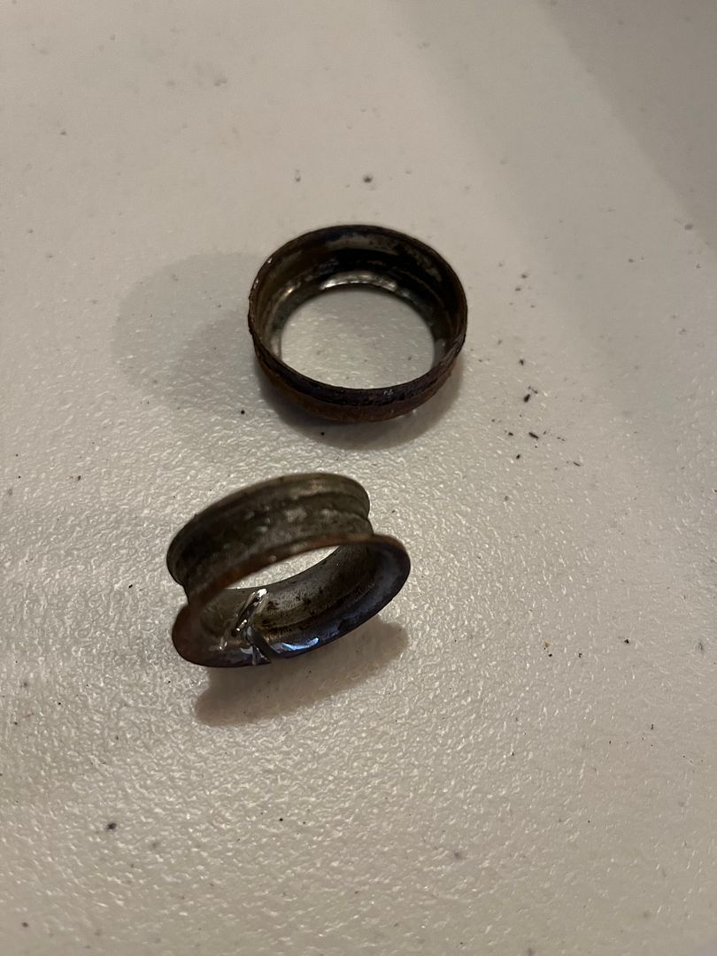

If you prefer not to do your own work the column on eBay might not be too bad. They put a sealed bearing on the lower end of the shaft which is not a bad change. The originals are a bit exposed to the elements and they can rust some and get gritty and fall apart in some cases. This video isn't too bad and it shows how easy they are to rebuild but his lower bearing has already fallen apart so he just shows pulling the outer race with his pilot bearing puller.
If the bearing has not fallen apart but still needs to be replaced, I like to use a Dremel tool with a thin fiber cut-off wheel to cut the inner race. Once that is cut most of the way through you can pry it some and the bearings will start to fall out. Once they are mostly out then the inner race will fall out. Then I use a similar puller to pull the outer race like in the video. You can also cut the outer race carefully with the Dremel if you go slow and don't cut all the way to the Retainer that holds the lower bearing.
I like to use the original style lower bearing for that genuine look, but it's totally optional.

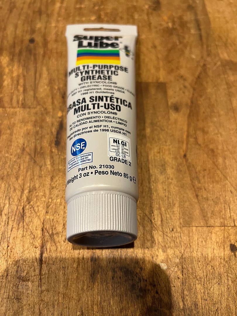

One more thing I'll mention while on the topic. I don't often recommend one product since there are so many choices on the market but something like this. I use Super Lube synthetic grease to pack the upper and lower bearings. Before you run grab your typically wheel bearing grease let me explain.
This product is a little different and this is right from the back of the package.
Applications: Automotive/Industrial/Marine/Recreational/Sporting/Household
Benefits: Compatible with most other greases. Outlasts conventional grease by 3-4 times. Has excellent adhesion. Impervious to salt water and road salt. Long lasting.
Good from -45 to 450 degrees F so it won't run out under normal conditions. It's not a fibrous grease either so it doesn't gum up the steering or dry out over time. It's also compatible with plastics like the turn signal switch and is Dielectric meaning it is non-conductive.
I pack the bearings by putting a dab in the palm of a clean hand and work it into the outer edge of the bearing continuing to add more until it is just squeezing out the opposite side all the way around.
Ford would have used this type of stuff if it had been available.

AMEN to the Super Lube synthetic grease. We started using it back in the 1980's on elevator servo bearings that were only lasting a couple of hundred hours and doubled their life. Now I put that $%^# on everything.
