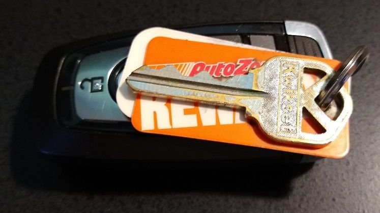

I keep a couple "discount" tags on my key ring to block the fob buttons. Helps keep the keys from scratching the fob, too.
