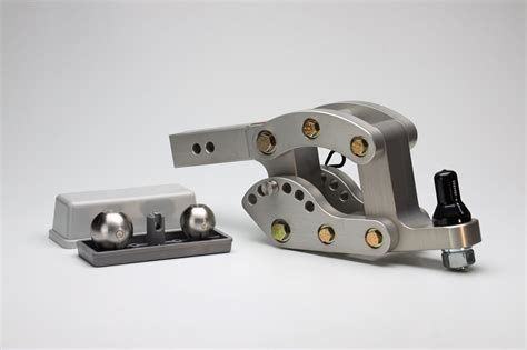

I've been researching into a hitch for my incoming F250 and would like a recommendation/confirmation based on my tow plans from those who're more experienced towing.
To start we've had class B RVs so I do not have first experience towing. I've been in a few F150/RAM 1500 while friends were towing their 7k lbs trailers and I came away thinking I'd like a SD for towing personally.
We're planning on renting different (mainly 25', may be up to 30' at times) trailers instead of owning so the tongue weights/heights will change. So far B&W tow and stow 7" drop may cover pretty much every trailer we may rent. But not sure if I'd need a WD hitch.
As the truck has a anti-sway system built in, I do not need to worry about sways (as much) but just need to worry about heights which will even out weights, is that correct?
TIA.

The truck’s built in sway control is pretty much designed to keep you from wrecking during a major trailer sway event, not to keep a TT with poor weight loading from swaying around some behind the truck. A WD with built-in sway control helps keep that TT to be better behaved.
Not sure how the rental units owners feel about folks adding WD setups to their trailers, you may want to investigate that some.

ProPride P3. Worth every penny.

While I agree that the PP and original Hensley Arrow are worth every penny, but I don’t know how that is going to work on rental trailers for the OP.

The built in anti-sway is only for extreme circumstances, it is not a replacement for a WDH with sway control.
While you can tow "naked" with proper loading, care and a heavy enough truck (1 ton plus), in some states anything recreational over 3k lbs, a WDH is required.
One hitch to look at in your case is the B&W Continuum. It is easily installed with no drilling on the trailer, and is infinitely and easily adjustable via hydraulic ram, you don't have to rebuild the head every time you switch trailers/heights.
As with any hitch though you need to spend some time in a level spot setting it up on every trailer. But it is a fast process.

I was going to recommend the pro pride 3 or Hensley arrow, but as you say, you plan on renting, not owning. This changes some things as neither of these systems are easy to setup/transfer very easily. First, I would go to the place you plan on renting from and ask what, if any, anti-sway systems they have installed on the trailers. I would hope they insist on an anti-sway system. This may solve your issue right then. However, you will want something, so even if they don’t have one (and they probably should). Have one of your own.
the easiest to own and install yourself (and adjust/remove when done), is the equal-I-zer. Buy one with the weight rating you need (you might need a second set of spring bars if your trailer rentals are too far apart weight wise, but they are fairly cheap). It installs quickly and if you get the 2.5 inch shank with the 12 inch drop (which also translates into a 15 inch rise), it will fit any trailer and allow you to tow the trailer level (towing with the truck and trailer level is a critical piece of towing. Even if your truck is level, if your trailer is dipped down or tilted up, you are setting yourself up for problems.
The equal-I-zer is decent. It’s not the best, but 1) it works, and 2) is easy to install/adjust on a trailer. The pro-pride 3 and Hensley arrow are superior setups, but they require more extensive setup on the trailer. If you had your own trailer, PP3 or Hensley all day every day and twice in sundays,
