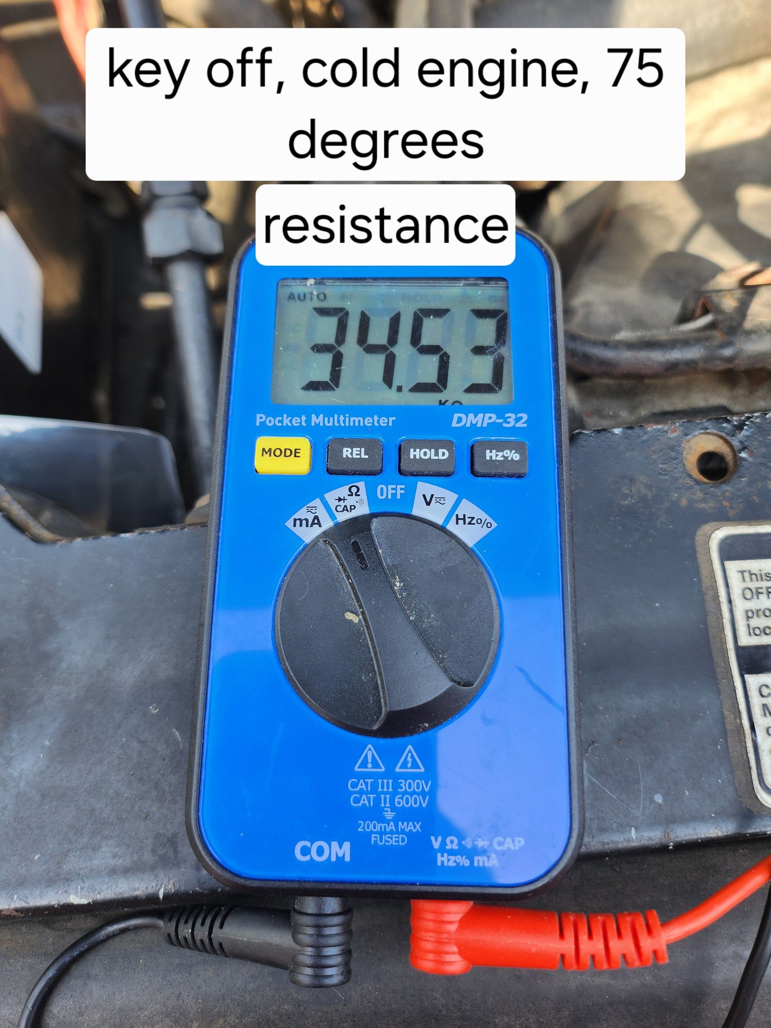

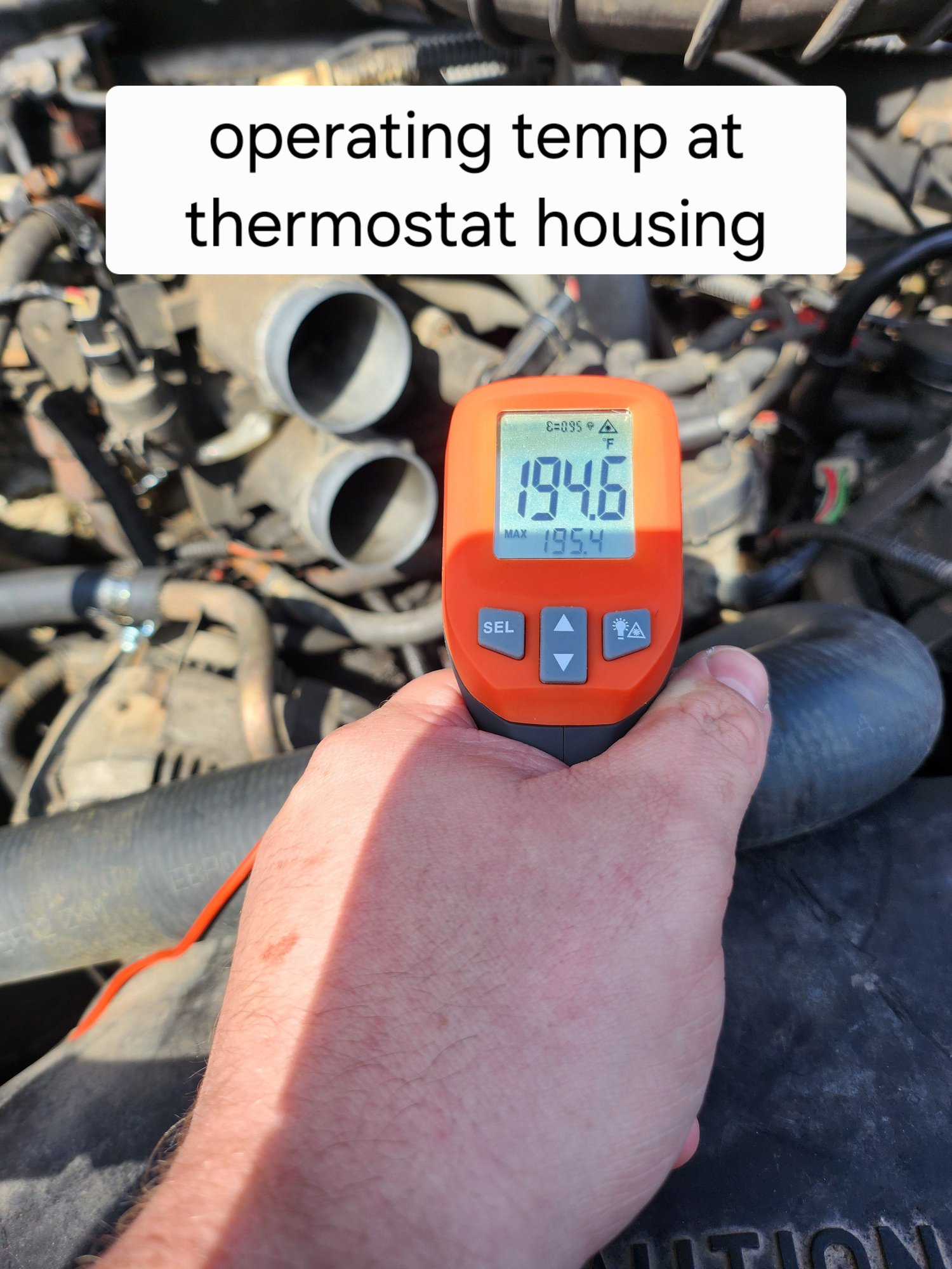

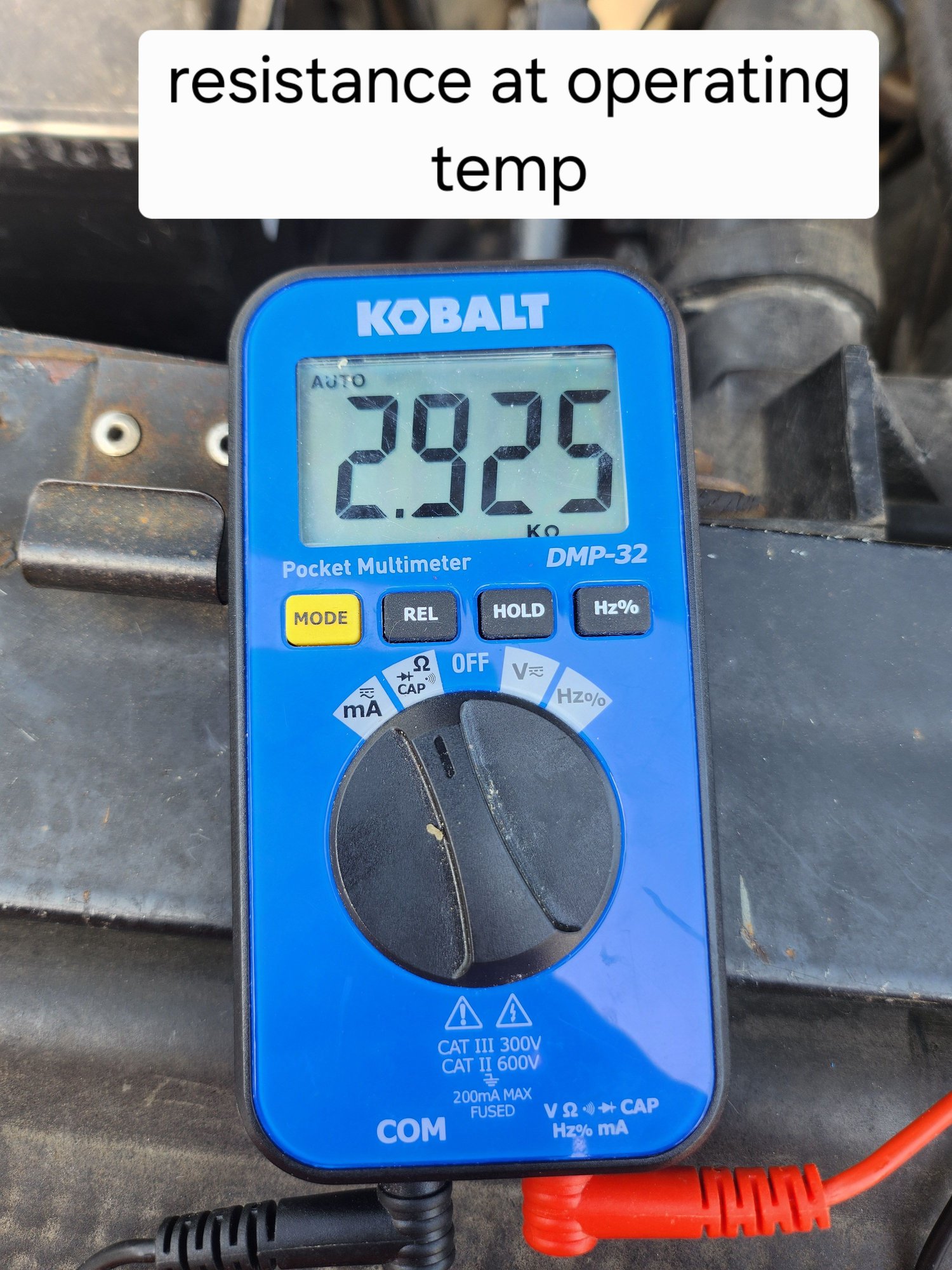

117 - Low ECT voltage. I have replaced ECT, and since replaced it with the original I took out of the truck after finding that the replacement was garbage. Resistance on original ECT was within range at cold, haven't tested at operating temp yet. Will do so tomorrow. Voltage was about 2.4 cold while running, and about .8 at operating temp. Connector has been cleaned, and wiring harness has been examined as far as I can (runs underneath a bunch of stuff a few inches back) and, as far as I can tell, there are no damaged wires. Code can be cleared and will be back within a few miles of driving.
217 - overheat. I think this is due to the ECT reporting a low voltage. I have verified the temp sender to be working, and have checked engine temp at thermostat housing with temp gun. Never seen it above 200, and temp gauge never gets above the "o" in normal. These codes always appear together, never seen one without the other.

Code 217 for a 93 5.0?
No such varmint
Better double check your code check procedure
* I'd do the pinpoint tests in the PCED for the code 117 and measure the voltage from the ECT
.64V is a damn hot ECT, and will turn on the electric fans on vehicles equipped with them
At 80 degrees that ECT should be around 2.8 volts
At 180 degrees it will be around .8v
At 200 degrees it will be around .6

Ill look into the codes again - possibly i miscounted the blinks, although i did count "217" both times it cycled through. I assume these are all 3 digit codes, right?
Not sure exactly what PCED is, Google didn't turn up much specific. But went through and measured resistance cold and at operating temp, verified KOEO voltage at harness, and measured voltage at cold and operating temp.
