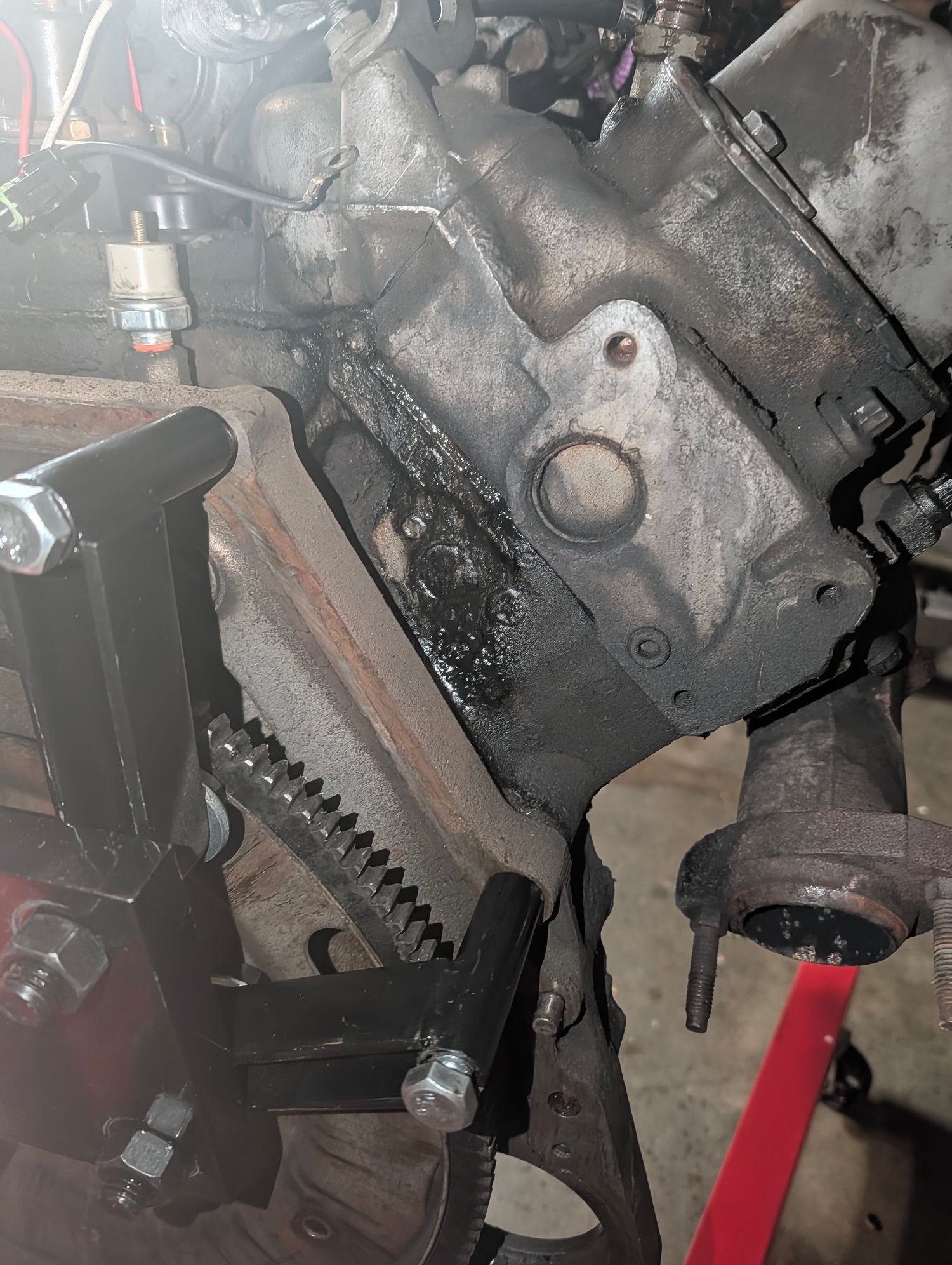

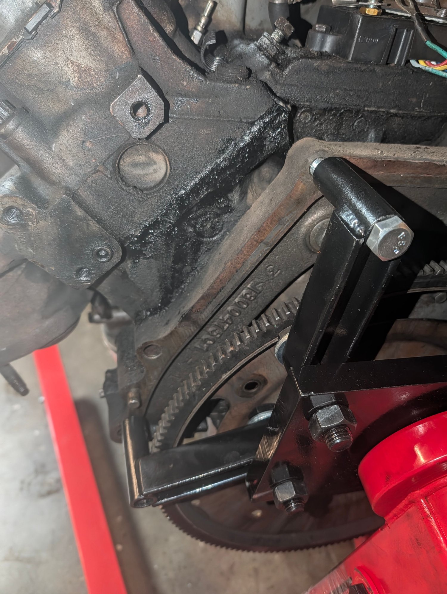

Made a lot of dumb mistakes but finally got it pulled out.
I hope I didn't do any permanent damage.
1) I didn't remove the flex plate and was wondering why the engine stand plate was making weird contact with the flex plate. I guess moving that out of the way and remounting wont be too bad now.
2) I forgot to detach the exhaust bolts from the passenger side and kept wondering wth was keeping the engine from moving forward when it was on the hoist.
3) I had left the starter attached (without bolts) so it wouldn't get puddled on with the rain from yesterday and starting lifting the engine with that attached..yeah no bueno there.
4) The strap I used to lift the engine was way too long at first and this caused really bad contact between the engine and trans cooler, which is positively gone now..oh well. I learned a lot so far..
Seems like both heads have a HG leak plus a couple in the front end as well.

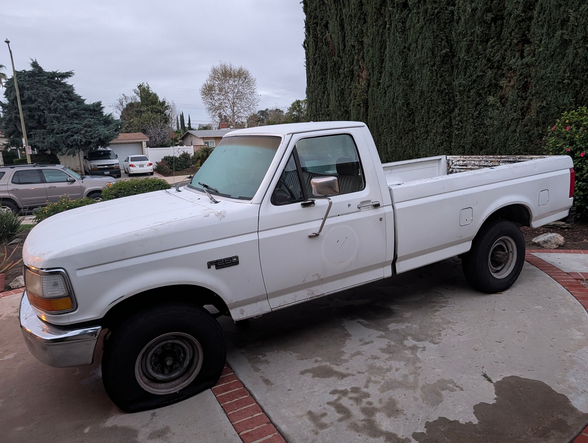

Give us a pic of the truck too. Did you disassemble the front end, or lift the engine over the grill?
Old Feb 19, 2026 | 08:28 AM
  #75
steelholder's Avatar
steelholder
Joined: Aug 2013
Posts: 248
Likes: 19
Originally Posted by Olds64
EXCELLENT!
Here it is, nevermind the flat front tire. I never needed to deflate it. I got big plans for the paint and already have some nice alcoas for it.
