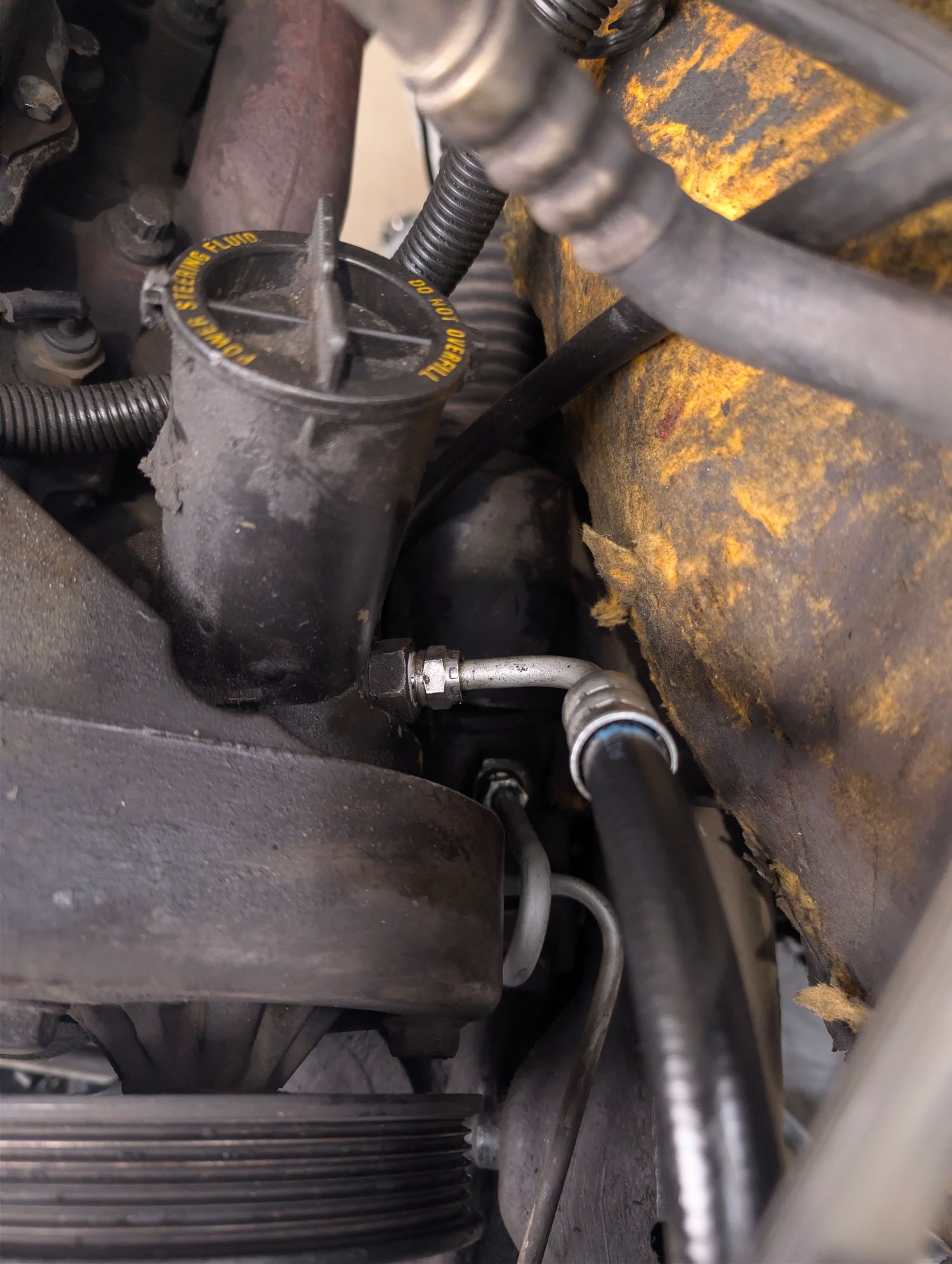

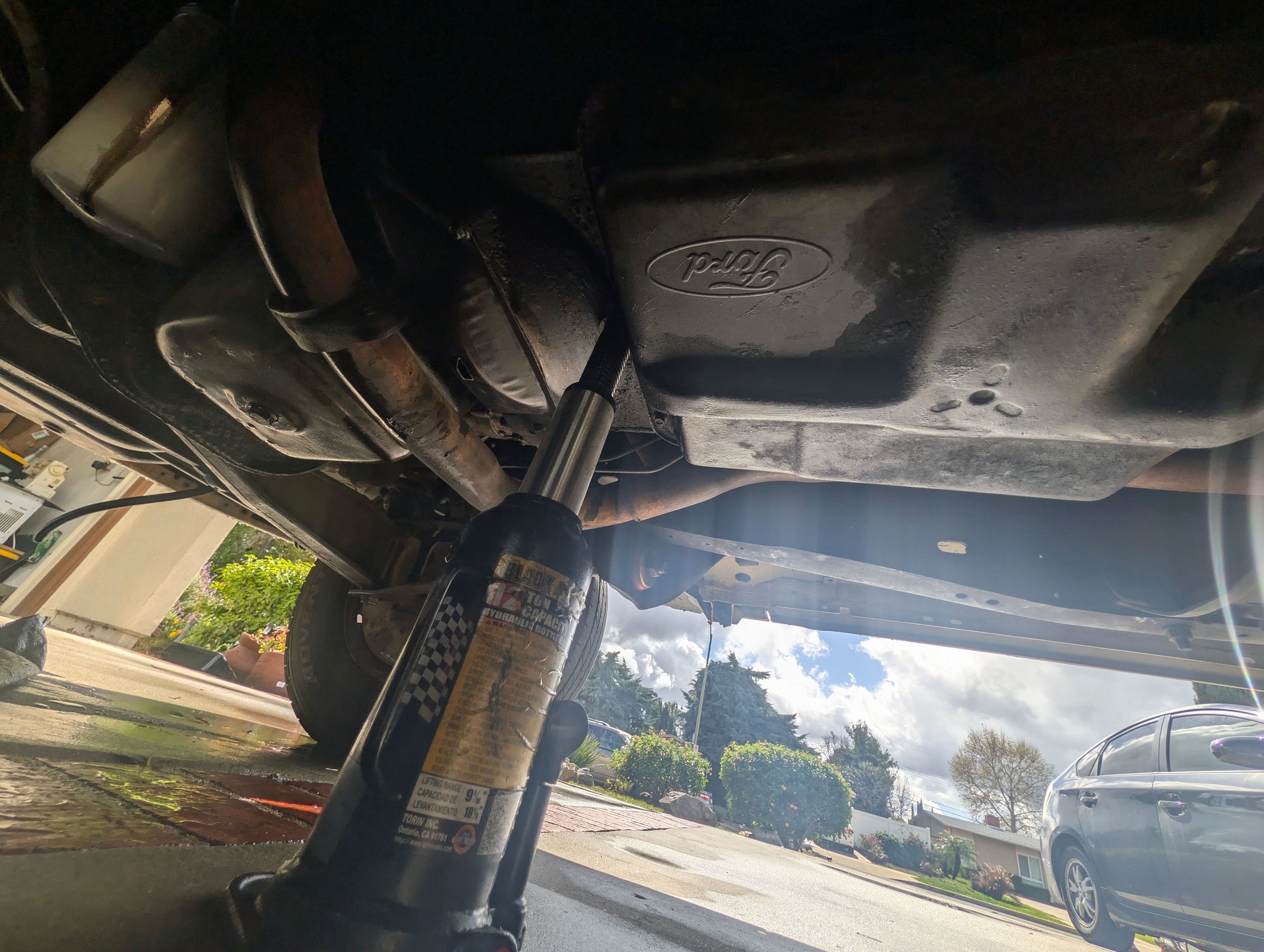

Almost ready to pull the engine but rain in my area has held me up. I have a few things that are still connecting the engine and was hoping for clarification and to not yank anything off that may be attached while pulling.
Is this the only connection to the PS that needs to unbolt(see below)? I've done everything in the front, wire harness, radiator etc, after this I'm assuming the only things left are the motor mounts, the exhaust and the trans right? Also, is this good enough support and the right area to hold up the trans after it's detached from engine?

Looks like you're well on your way to me. With the trans crossmember still in, the trans cant roll on ya, so the bottle jack looks good. You can unhook ps hoses from either side, but at pump is best like you're planning, cus then the hoses can be tied up out of the way over on the truck side.
If you don't have a set of torches for the exhaust nuts, I don't envy you, and wish ya luck! haha I get them suckers glowing red before I put the 6 point on 'em. I just had to replace all the studs in my banks kit, in my f250 this past summer. They just eventually rusted and lost their threads. I found the best replacements at a hardware store, rather than the auto stores. Ending up finding the perfect replacements locally.

Thanks, so just that one connection at the PS and I'm good right? Could you guys confirm there are only 6 bolts that connect the engine to the trans bellhousing? Anything else I am missing here besides the engine mounts (2 nuts on driver side and another 2 on the passenger right?

On one side, I found it easier to remove the motor mount bolts from the block I think, where the other, I found it easier to pull the bolts and leave the mount on block. You just follow your nose as you go. 6 bell housing bolts sounds about right, but you'll know when you go to pluck the engine and it doesn't come, you left the starter in or a belhousing bolt haha. You'll just start lifting and shaking (the cheery picker side to side) as you go, lifting slowly. If you miss something, just look around and unhook it, it's really as simple as that when pulling an engine. You just disconnect what you see between engine and truck. You'll find everything as you go, don't worry.
Unbolt the converter nuts. Leave converter in trans (remove it, to replace seal in pump, but then put converter right back in, turn several times while pressing inward to make sure converter fully seats). Turn crank bolt, to access the 4 nuts, as needed and when you line it back up, when putting engine in, do so with care. If converter is not fully seated, you could press flexplate hard against converter and harm the pump! You'll know it's right, when you can still spin converter with bellhousing bolts snugged up.

I did leave the starter in and the inspection plate does that need to come out?

It sure does. Engine and trans cannot separate with it bolted in.
