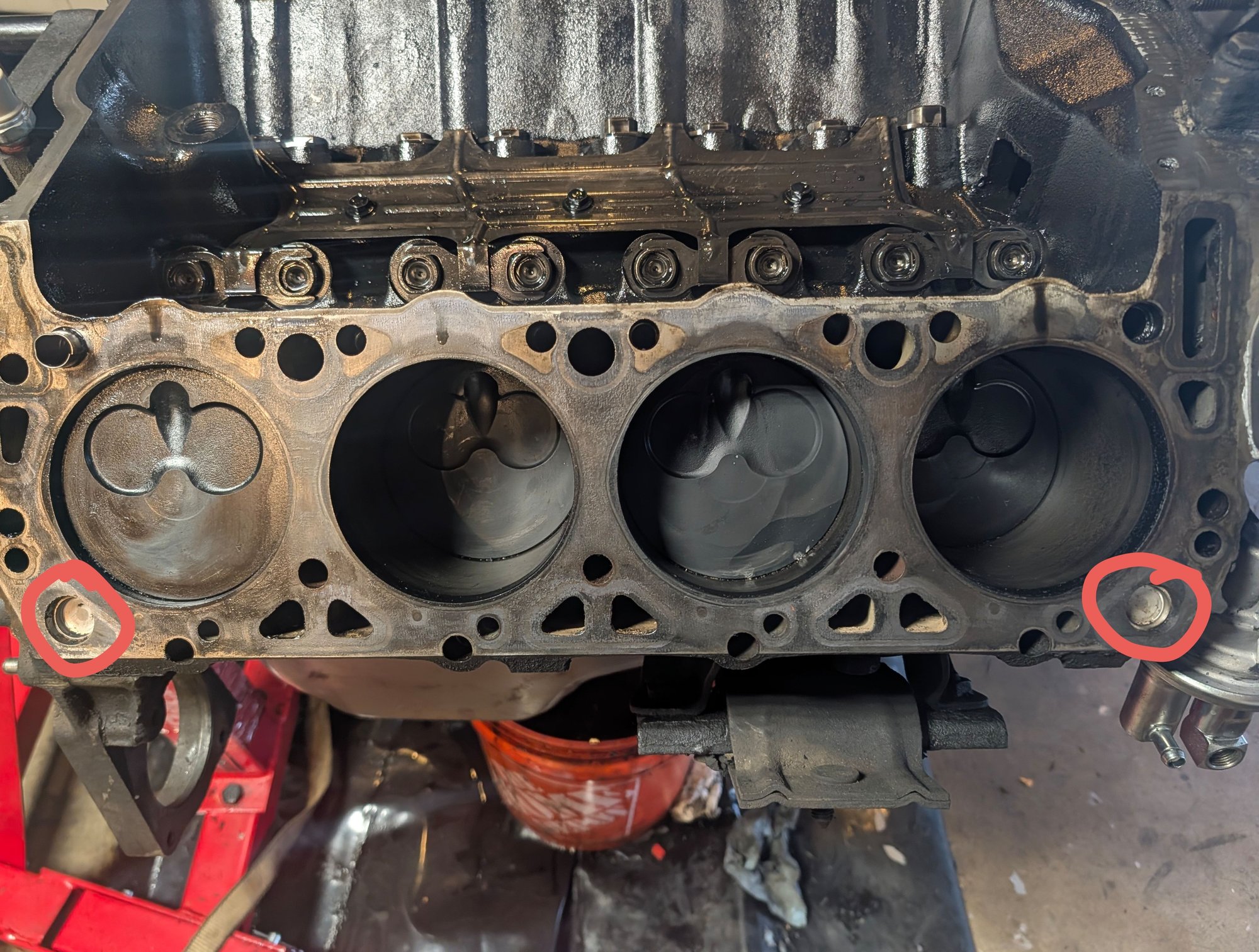

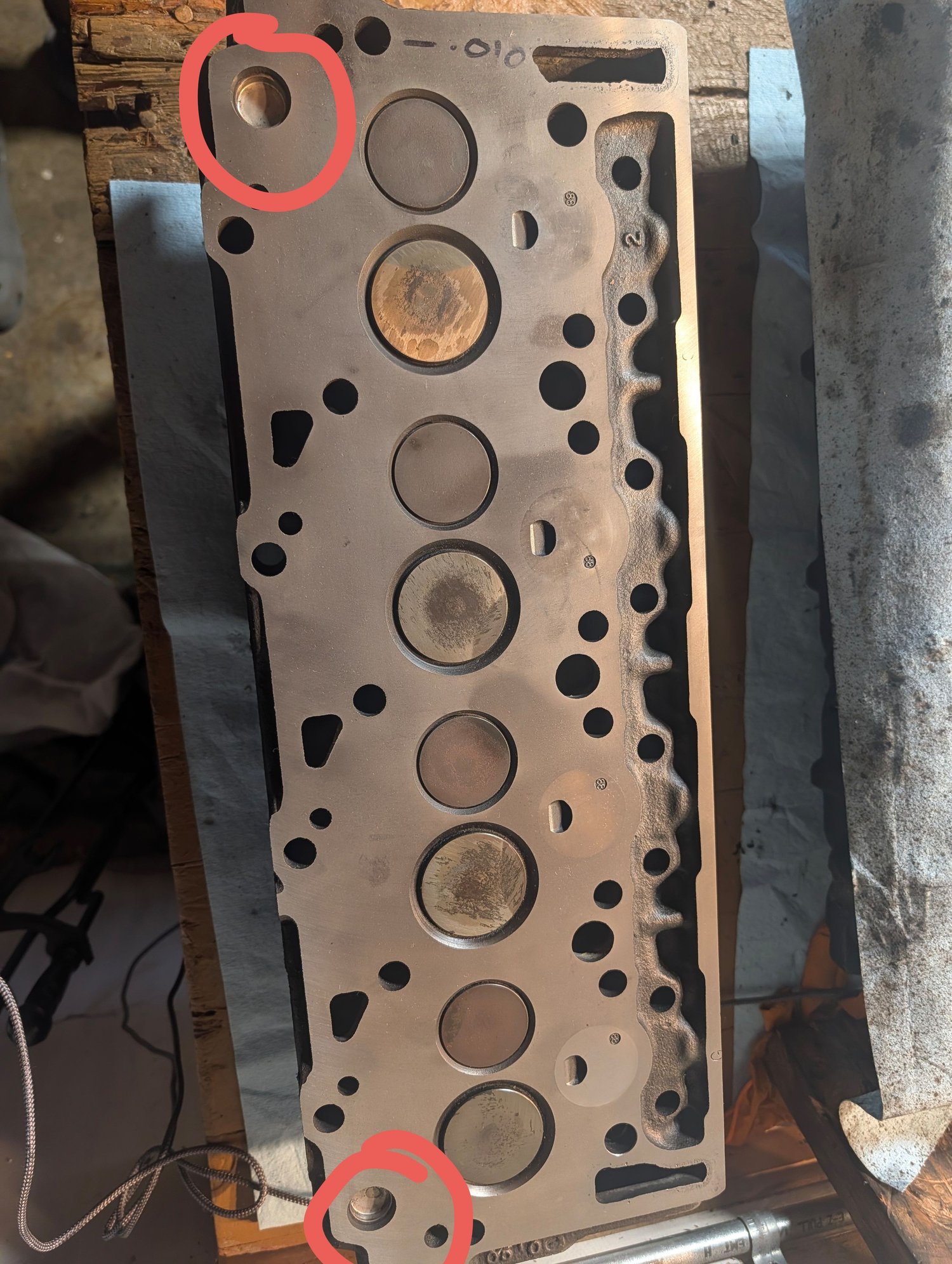

The CDD master seal kit states that I should remove these below, circled in red, in order to install the HG. Do you guys recommend that? What is the advantage of that? Anyone else do that?
"This gasket set is modified to open additional cooling ports for superior coolant flow in the edges of the cylinder heads like the 6.9 IDIs, and when installing on a 7.3 IDI the small coolant freeze plugs should be removed from the block and head decks to allow even coolant flow."

From: Mi'kma'ki
I would question why the engineers at International decided to plug those ports on the 7.3L, and what engineering degree one has to overrule them years latter before I made any modifications. Since I don't know the question to either of those, I wont speculate as to what is right or wrong. I would research the subject first. I know when I thought the odds were high that I was just going to have to replace the head gaskets in the F450, I picked up felpro gaskets and wasn't going to change anything. I figured since the engine lasted 200k+ miles issue free up until then without any cooling issues, I didn't feel a desire to modify anything, nor do we hear of issues with 7.3l heads prematurely failing often on these engines in the forum. I know the heads on the old engine look great, so I saved them.
It may very well be a great idea and have a very great reasoning for removing those. It's possible the engineers over at International made a mistake years ago. I would just research it first, is all. Maybe someone here knows why International did that. I seem to remember knowing this years ago but have long since forgotten.

I would ask CCD about opening up those coolant passages and maybe they know the reason the 7.3 has them plugged? If I were to guess since the 7.3 is bored out from the 6.9 that less mass, thinner walls meant more cooling than was needed so they plugged those outside ports to compensate and keep engine temps up where they need to be. Diesel engines like to run hot not cold. Okay just a guess that they were looking for a cheap way to raise the coolant temp.

I just left it as is and installed gaskets.
