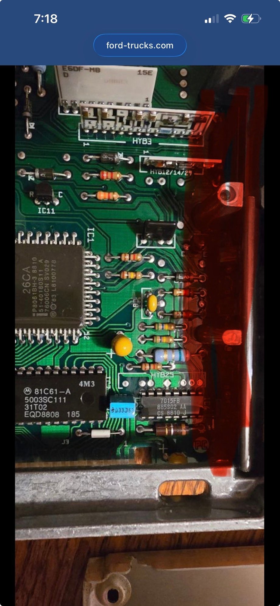

I got it apart. Looks very clean to me at least

Turn this area into the light
Turn this area into the light and take one
That work?

Likes: 254
Computer definitely looks good. Time to see if you have a working pip.

The only thing I can see wrong with the computer is the pins. I doubt it is factory dielectric grease, since dielectric grease does not conduct electricity. I would clean the pins and put it back in. The fact that your truck will run with the spout disconnected, but not connected, says that the ECM is commanding timing as it should. Double and triple check that everything is correct with your timing. Make sure that you have the distributor installed with the rotor pointed at the #1 terminal on the compression stroke and that every wire is in the correct position on the cap. Are you using the correct firing order for your engine? Are you using the correct cylinder as your #1 cylinder? You will learn, when someone tells you what they believe the problem to be, it is still up to you to diagnose that it is in fact the problem. Nobody on this forum but you has access to the vehicle, so it's still all on you. If you believe the issue to be the PIP, watch videos on how to properly test it. You are going to need to buy a lot of tools to work on these old rigs, but you will save yourself a lot of money when you learn to diagnose and not just throw parts at it.
I can check the timing again tomorrow, however I dont see that being the problem seeing as it drove relatively fine for months on the timing it had. Unless it has jumped timing at this point I dont see it being that. To my knowledge unless I've been told wrong number one is passenger front, and unless the firing order has changed over the years besides for marine use I believe that is correct as well, but I will check that again tomorrow as well. I have no clue if it is the pip myself if I am being honest. I am trying things as I go because I've run out of ideas myself for it. If something doesn't or change the outcome like the tfi I returned the part as it was unnecessary to replace
