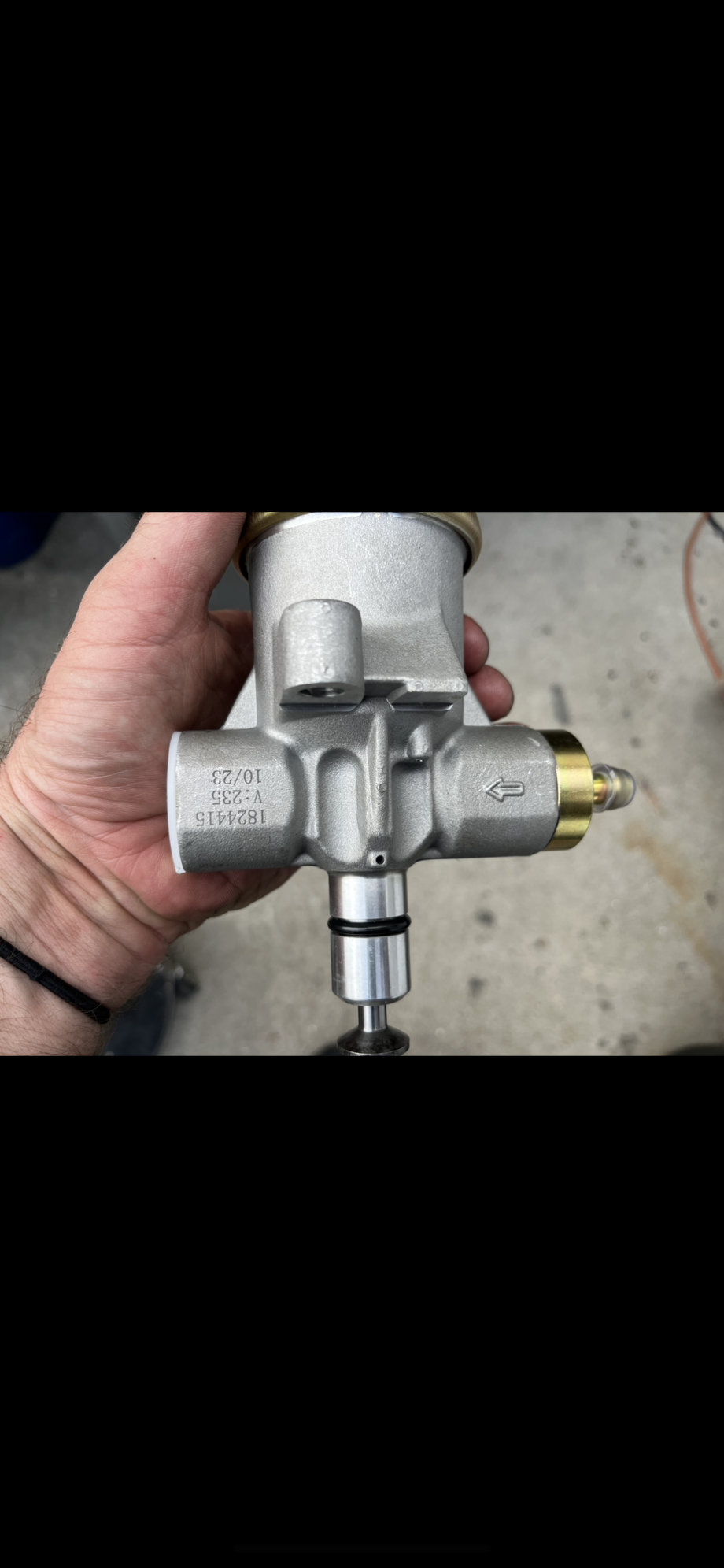

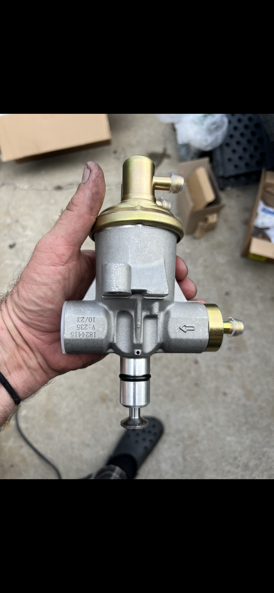

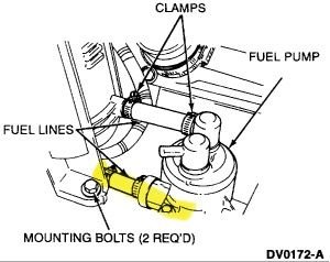

Where it’s circled is also the location of 3ea hoses from pump to bowl.
best to dry the area, use a mirror to pinpoint the location. You can see the weep hole above the tap. The illustration shows the 3 hoses and highlighted the one that goes to bottom of fuel bowl. That one leaked for me.
