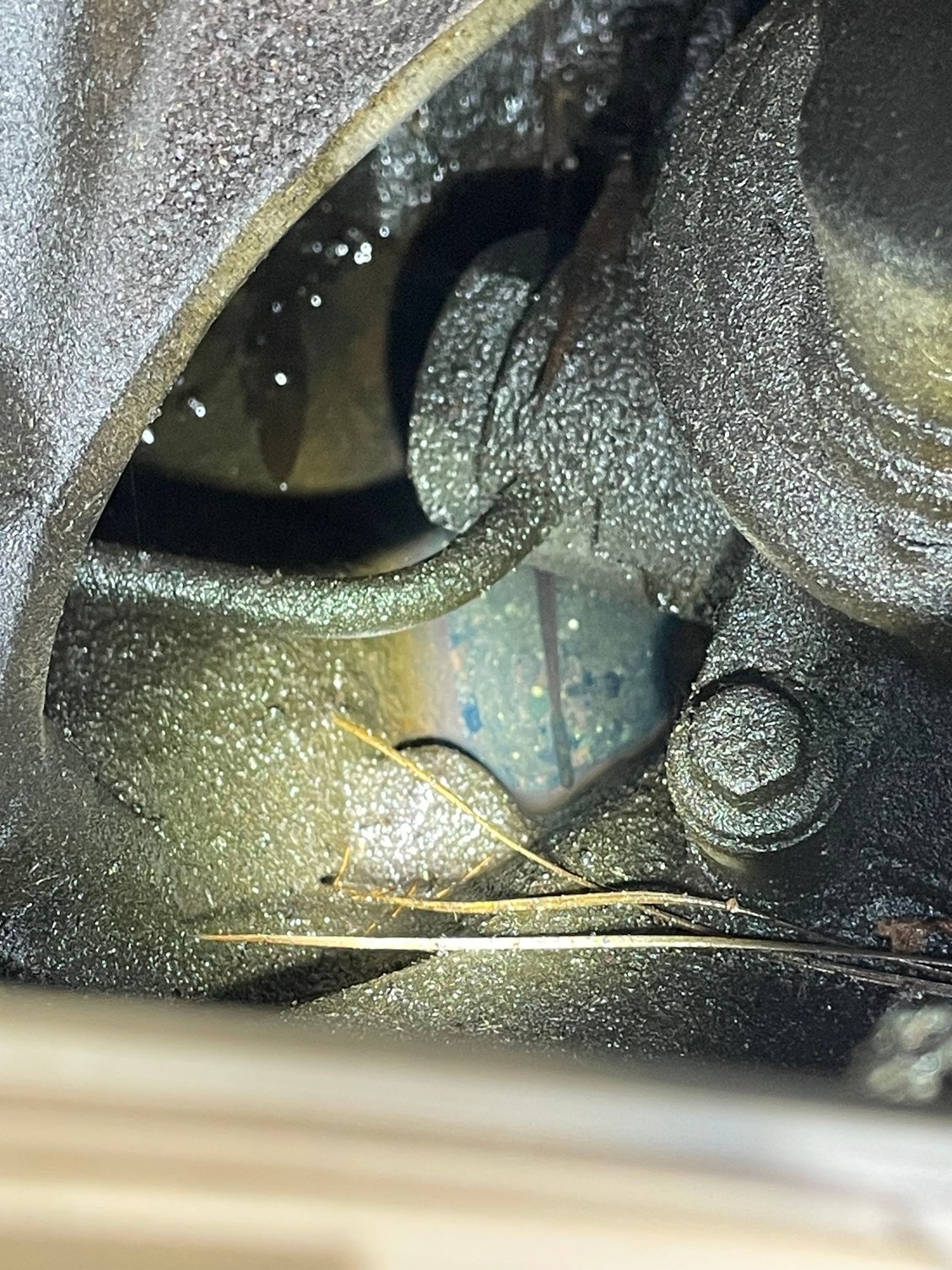

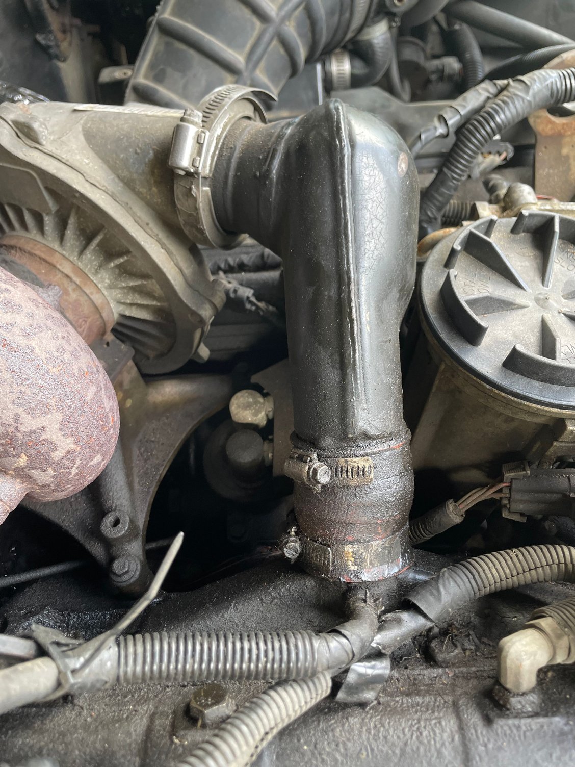

Another fuel related issue
Saw some fuel leaking from around the bellhousing cover, found another forum about it from 2016. Found the leak origin, behind the fuel bowl. Not sure what it’s called, if I need a replacement kit, or new o-ring. Please help.is it an issue if I keep driving her? She’s my daily.
In picture #2, I circled where it’s leaking/spewing under load, from.

There are 1 or 2 hoses with clamps that route between the pump and fuel bowl. The hoses are short. Those lines may be leaking.

need to use a mirror and look deeper
could be pump, hose or something on the bowl.

From your last photo, it looks like the banjo bolt may need tightening. The area under the bolt looks like the fuel has washed the grime off. If your lucky, you won't need the sealing washers. My 97 needed the banjo bolt tightened one time. It only took a 1/16th of a turn to stop the leak.

If that’s the issue, should I tighten while running or not?

Either way will work. I tightened mine with the engine off.
