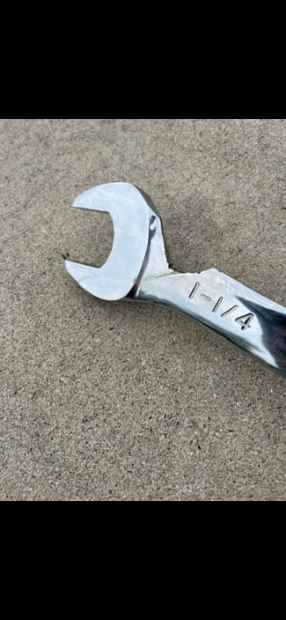

While it is not ideal, I don't think it will hurt to drive it. But I would try to tighten it quick as possible. If I remember right, it takes an inch and1/8 wrench, or maybe a 1 1/16. How long has it been leaking?

You may also need to put a slight bend on that wrench. The turbo pedestal is usually in the way to fit a standard wrench. At least that's what I remember when I did my e-fuel conversion. I ended up tightning the banjo with the wrench on it at a slight angle, which chewed up the bolt a tiny bit. No biggy though.

Just grab a wrench and snug it up. I think it is 1 1/4 but not positive.

Little notch with the grinder helped get that extra turn and orientation on banjo bolt.
Little notch with the grinder helped get that extra turn on the banjo bolt. Helped clear the deleted pedestal I have. Wrench is a husky from Home Depot.

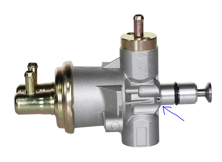

banjo bolt into the banjo fitting on the fuel pump has two metal gaskets
https://www.riffraffdiesel.com/banjo-bolt-gasket-set/
Check weep hole on fuel pump?

bottom of pump, need a mirror and flash light to see it

If it is leaking from there the pump needs to be replaced. I believe that is similar to a water pump leaking from the weep hole.

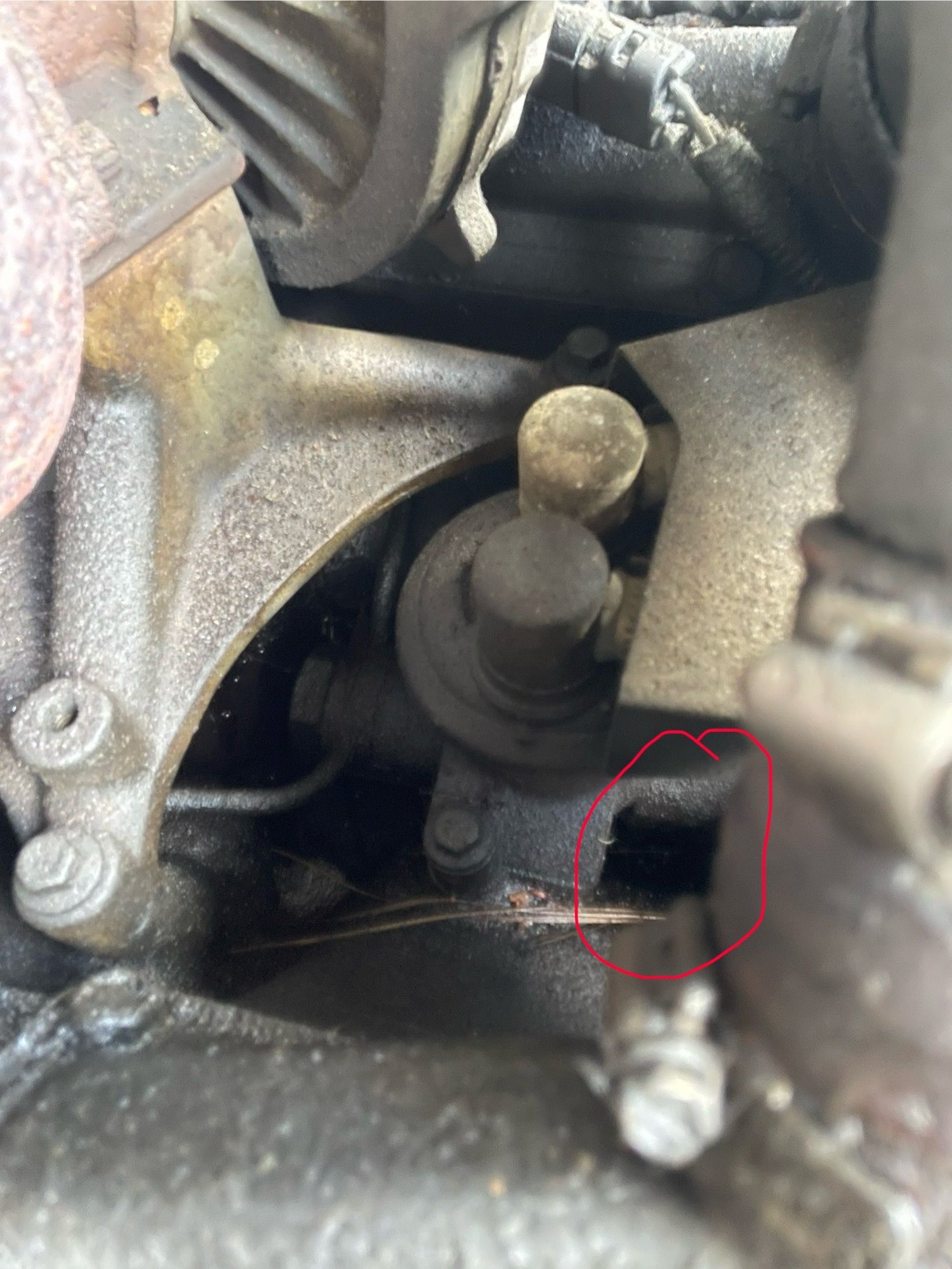

Replaced banjo bolt gasket and cleaned the area. It’s definitely coming from the middle behind the fuel bowl. I posted this earlier on. In the area where I circled, I’m seeing fuel shoot out from the left on the under side. Is that where the weep hole is located?
