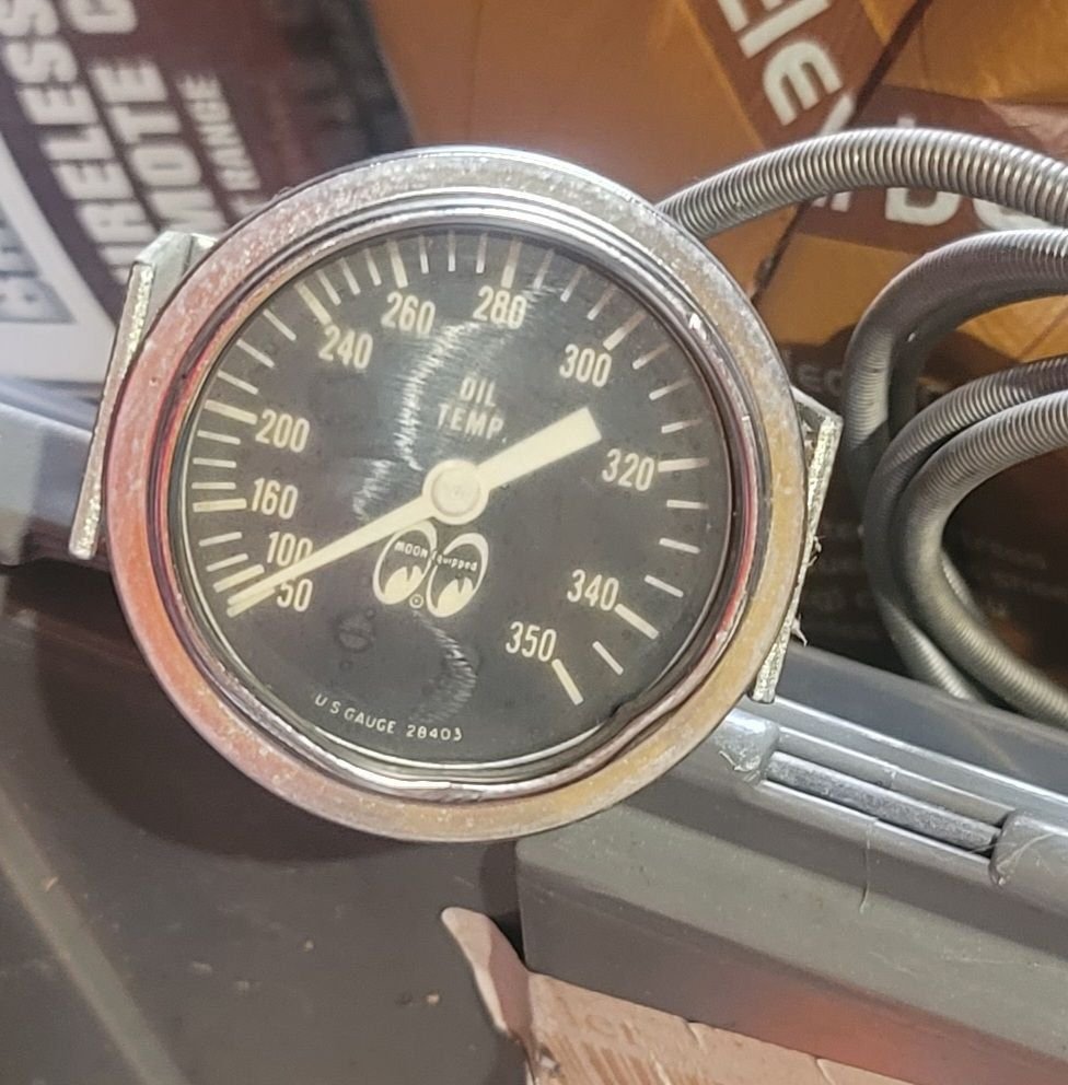

I have a MOON Temperature gauge out in the garage, complete with the long hard line from the sensor.....
it used to be on my brother's race car back in the 50s and 60s, keep it as a memory of him.
