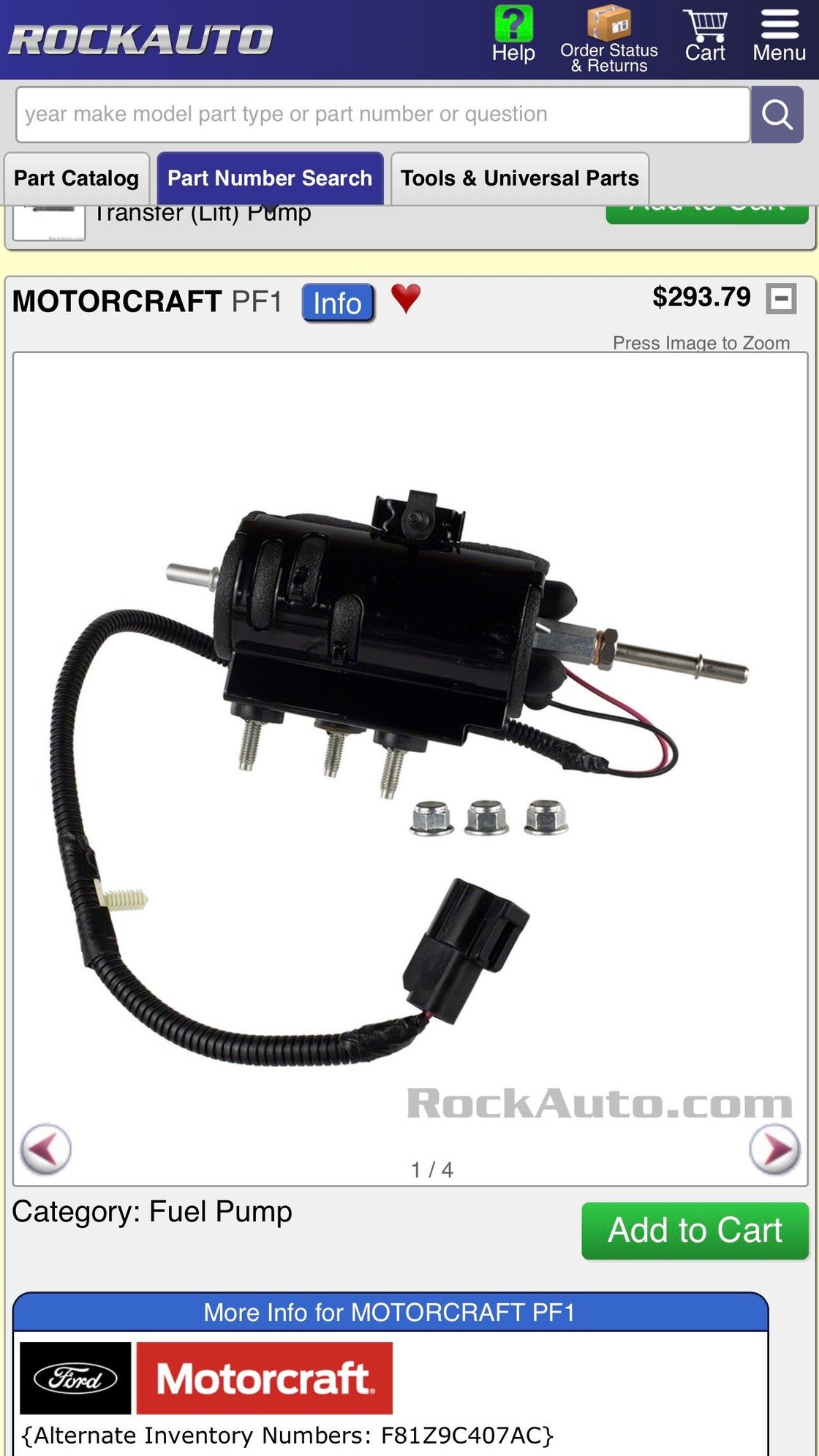

Originally Posted by z31freakify
Get a genuine 99-03 7.3 fuel pump and be done with it.
Best price I found.

Wil it keep up with upgraded injectors?
Old Feb 12, 2026 | 03:58 PM
  #97
Lepidopterodactyl's Avatar
Lepidopterodactyl
Joined: Mar 2025
Posts: 63
Likes: 28
It will unless you're running some seriously big sticks. I'd recommend picking up the "bare" Bosch pump (the Motorcraft unit is just a rebadged version with some plastic) and buying the correct hardware for it. The assembly comes out quite a bit cheaper that way. You can even go straight to an AN fitting on the outlet (I did).
