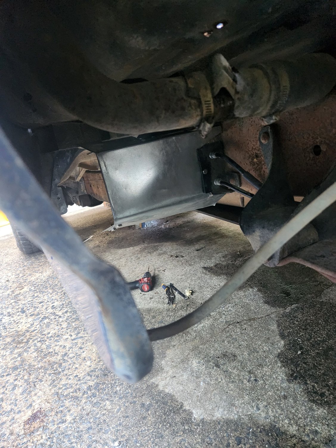

I'm working on my install now. The fuel bowl sprung another leak, and I'm tired of messing with it. I couldn't really find any pictures of reg cab 4x4 installs. They have to go outside of the frame, no room between the transfer case and the fuel tank. I wanted mine up above the frame rail.
This is what I came up with. I made a shield out of some galvanized sheet i had to protect it from whatever the tire is slinging up.

Likes: 119
From: Norcal
Looks good,
Are you going to drop thee tanks to check the sending units? They recommend it.
Also, when your done, what is your vacuum readings for both tanks?

Just finished up the install. I'm running 6inhg front tank, and 7inhg rear tank. This is within Marty's spec for both tanks. I will be doing the pre pump solutions eventually. I had cleaned the fuel bowl earlier this year, and upon removal, there was some debris in the bottom. I used a hose shoved down the filler tube attached to a transfer pump to pull some fuel to test the pump. Some debris came thru the transfer pump as well.
So my vacuum readings are fine, but I don't think my tanks are healthy.

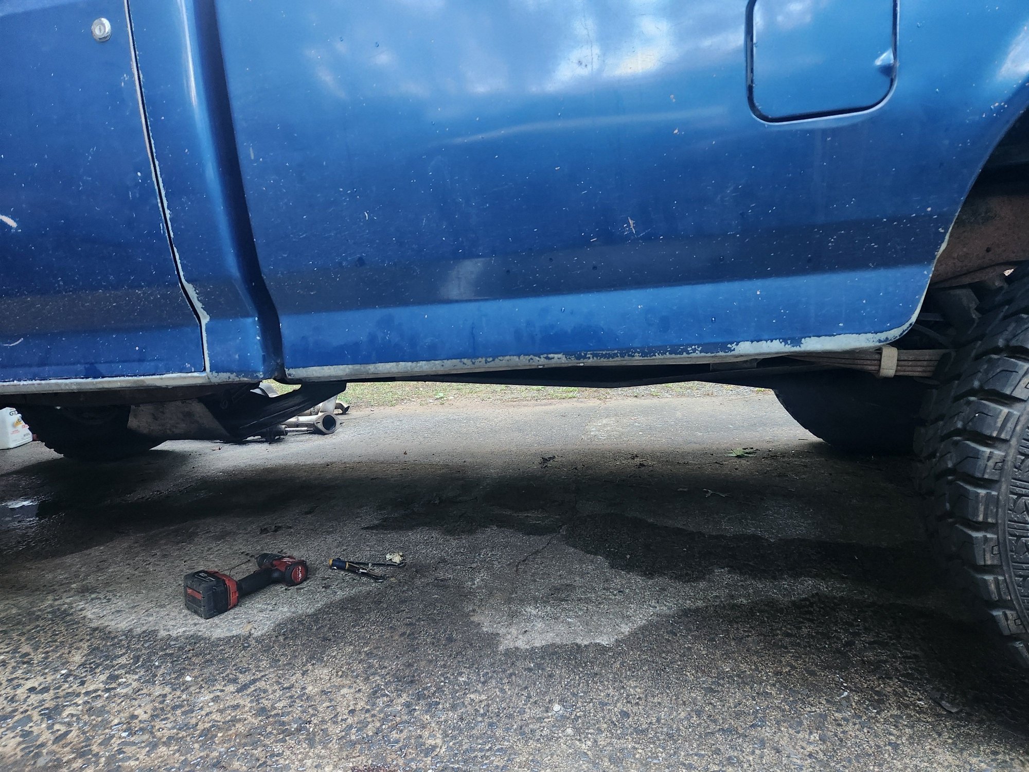

Mine is regular cab. The only hiccup I had is the feed line to the pump is borderline to short. Since I put my setup outside the frame under the bed, the feed from the selector is running backwards and under the frame. It's stretched pretty tight. I might check with Marty and see if I can get the selector side fitting and a clamp to make a longer line. I had plenty left over after I made the cuts in the valley.

I see, running the lines under the frame is kinda sketchy. I too had a little hose left over only about 2'. I ran my "pump to engine" feed line through a frame hole to the outside frame to the pump/filter assembly on the outside of the frame. I kinda regret it thinking there maybe rubbing long term which could result in damage. I should have ran over the top of the frame instead. I was thinking of aesthetics more than cable protection.

Where I was concerned about rubbing/chafing of the hose, I split some 3/4 heater hose lengthwise and put it around the fuel line with zip ties on each end.
I can keep an eye on the heater hose to check for wear. If rubbing is damaging the heater hose, it's simple and cheap to split another length of hose and change it out before it wears into the fuel line.
