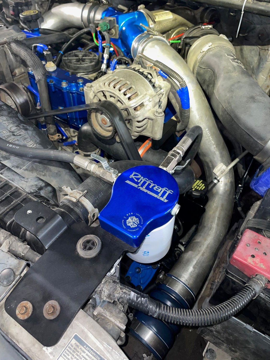

Old Jan 29, 2024 | 04:30 PM
  #130
JohnDeereFarmerUSMC's Avatar
JohnDeereFarmerUSMC
Joined: Sep 2012
Posts: 451
Likes: 120
Excuse my terrible lighting and photography skills
Very tight area for the ic pipe. The intake barely clears, as well as the hydro to reservoir return line.
KC Blue turbo would look good back in there yeah???
Hydro to res return line I rigged up. Had to use a zip tie around the bottom of the master cylinder, no real tension on it, just enough to give the IC pipe clearance.
GPR relocated. I had to rig new wires for the starter solenoid because the old ends were so corroded they broke clean off.
Need to tidy this area up a bit, thinking about cutting the AIH wires WAY back and tucking it all into one piece of loom

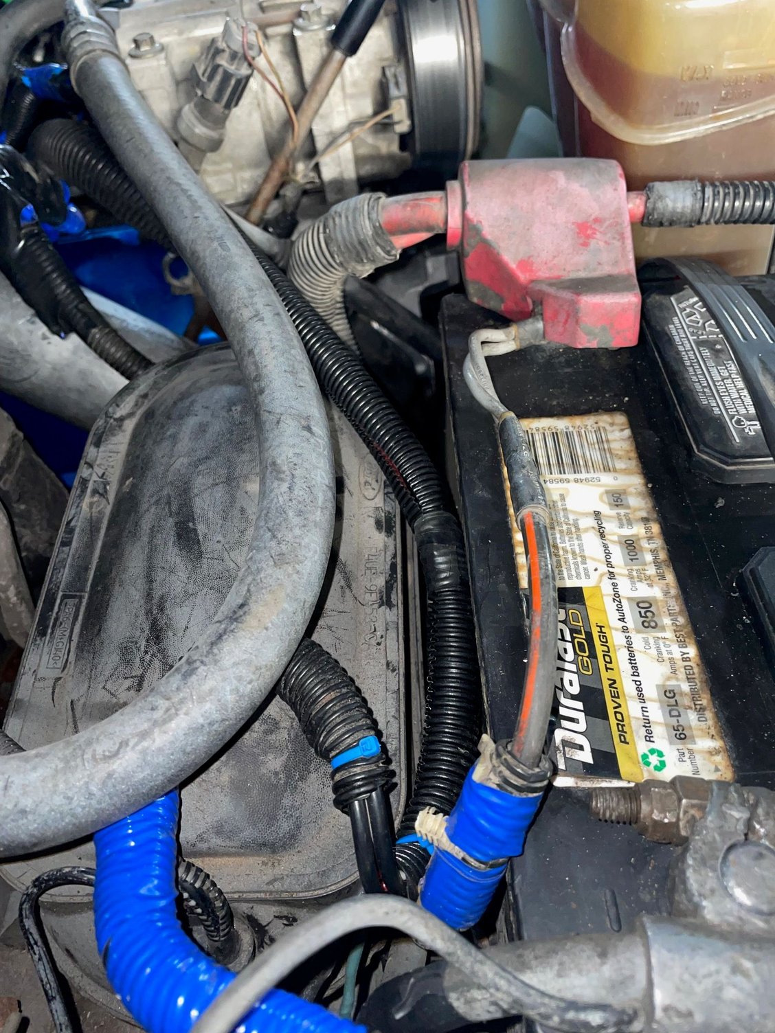

Need to clean this area up, a lot going on here. When I do new BATT cables, im going to get everything tucked in down low under the tray.
Forgot to snap a dang pic of the clearance issues with the Fuel bowl mini drop bracket+FRx+Sensor on hpop res. Got around it my screwing that sensor in an uncomfortable amount, then connecting the sensor plug, THEN threading the FRx housing on,it rubbed the pig tail a little but but it clears now. Crazily enough on the Driver side IC pipe, I was able to get everything to clear with zero rubbing or touching. Big win in my book.
Old Jan 29, 2024 | 07:55 PM
  #131
Tpayne621's Avatar
Tpayne621
Joined: Apr 2022
Posts: 3,192
Likes: 1,696
Looks good. I like all the blue touches.
I'd throw that wastegate solenoid in the trash along with the lines and plug the hole in take tube and clean valley up even more. Mines been in the trash for about 5 years. Just sets a soft code.
Another thing to clean up battery area. The big wire with 2 fusibls links going to positive. You can run it to the constant hot side on starter solenoid. That's how it supposed to be factory anyway. Will clean it up a touch.
