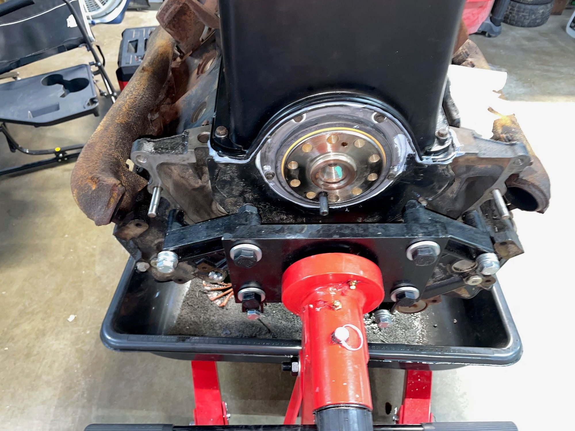

Also, thought you’d be interested to know I installed my rear main seal tonight using the flex plate spacer and it worked great! I used 4 bolts in a rectangle pattern and it snugged right up.
I did the exact same thing yesterday. Worked perfect.

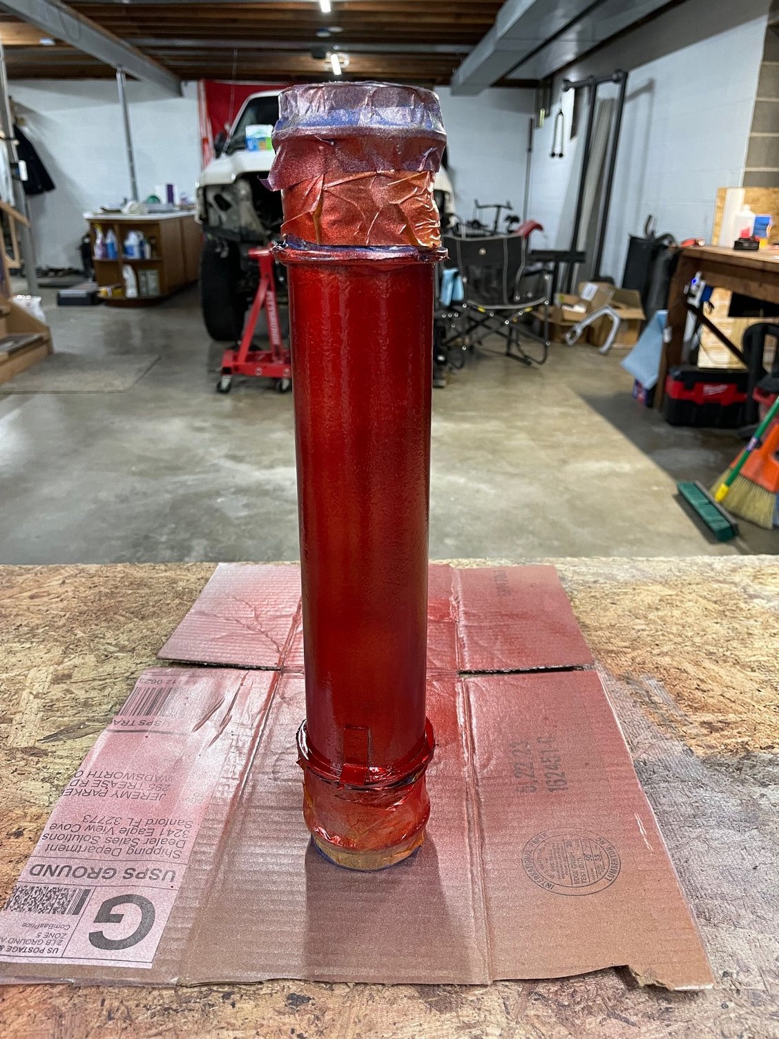

Well another day in the books. Had a slight screw up (my brain, it hurts) but the pan is on and whats done is done. While prepping to put the pan on, I noticed a small dot of rtv that came through with one of the rear main seal bolts, and thought "hey ill grab that off with some long needle nose pliers before I put this pan on". Well, its in there for the long haul now. Was just sitting in the recliner and it dawned on me that I forgot to get that out.
Got my order in (hopefully the last for awhile) with clay at riffraff for the coolant filtration system, mini hpop res spacer and fuel bowl drop bracket so I can run the screened hpop gasket, as well as ANOTHER fuel bowl re-seal kit. This just means ill have to wait for new CAC boots and clamps, but those arent a must have right now.
Had to run to work and do some paperwork and training, so I took the oil cooler with me and got it in the parts scrubber and cleaned it up real good. Brought it home and flushed everything out one last time, and blew some air through it with the shop vac just to make sure all the old oil and crap was out, taped it up and got it painted. Decided to test out the "smoke" and anodized red on this, and I must admit, I think the red turned out awesome. Its alot tougher to spray than the blue for whatever reason, but I kind of like it. Pretty much everything else will be blue now, as nothing else on the truck is red.
There it is in all it's glory. Said a little prayer when I got it done.
Wasnt leaving anything to chance on those back corners, went extra heavy there.
This spot on the front halfmoon was a little light after torquing down so I smushed some more in there.
Final product of the blue elbow.
Different lighting angles makes it much darker deeper red, or brighter candy apple almost.
This turned out awesome as well!

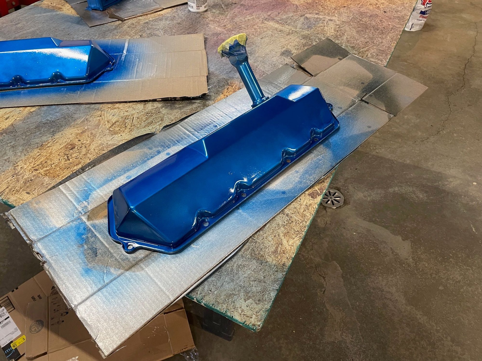

Made a little more progress. Coolant filtration system, hpop res spacer and gaskets should be arriving any day now from riffraff. Got some more paint done, and the oil cooler re-assembled and put on, and man I do not ever remember them going together that hard. Took a few attempts with the ratchet strap, and 1 solid whack to the back of my hand with the mallet and she popped back together (I was swinging for the fences too, because I had just jacked up my sweet paint job!).
Getting my order for the snuggletough saginaw p-pump bracket together. Trying to figure out part numbers on rockauto for the other PS and hyrdroboost hoses I need. Want to replace all of the hoses in that system. Does anyone have the numbers off hand? If not ill search them up in the morning while having my coffee. Should be able to get that order in and the bluetop order in. Hopefully have enough left over for the KC balanced assembly, but if not, I am definitely atleast going with a new billet wheel. Stuff adds up real quick.
Going to knock out the oil gallery plugs, banjo o rings and a few other things, and get the VC's back on tomorrow. Then begin going through the harness and re looming and taping everything, try and get that all cleaned up and ready to rock and roll.
With any luck we'll start putting it back in next weekend or the following week. Here's some sweet paint pics. Still need to do the 42pin connector bracket and thinking about cleaning up and doing the AC compressor bracket. But giving the wife a break from the fumes for a few days!
For some reason, I had a few spots where the pain would just not cover the base, may have been dirty or oil.
Battle scars, however I may have come out of it worse off.
Little paint goes a long way aesthetically.
